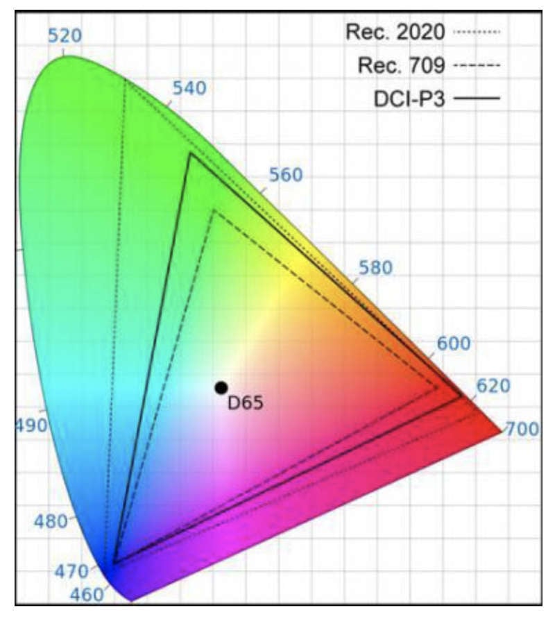

Let's first talk about wide color gamut. The color spectrum below shows a representation of colors the average human visual system can see. Good old HD televisions were able to display colors that conformed to the REC709 color gamut, which is roughly 30% of the human visual system. HD television programing and Blu-rays were all mastered to the REC709 specification. That's why you've probably noticed some colors on your Blu-rays or HDTV programming—especially greens and reds—aren’t as vibrant as real life.
Wide Color Gamut BT2020 DCI P3 REC709
Today's 4K/UltraHD TVs and UltraHD Blu-rays, by contrast, are able to display content that has goes beyond REC709. The BT-2020 standard encompasses 75% of the colors humans can see. A TV with wide color support is therefore far closer to capturing all the colors the average person experiences each day.
While BT-2020 offers a lot of color opportunity, most content today is using only a fraction of it. For example, that third triangle, labeled P3, is the color space that most commercial movies in cinema are mastered to.

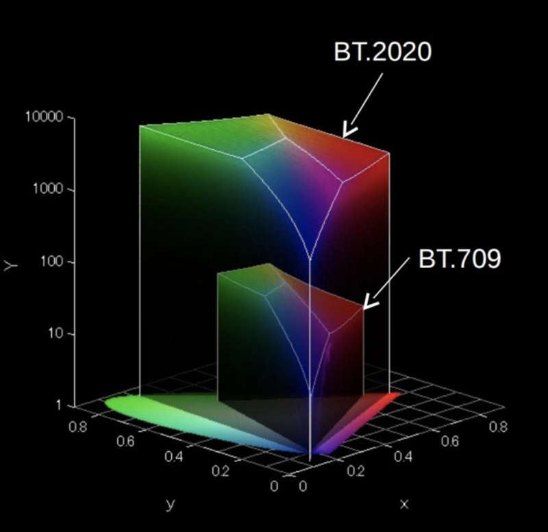

Given that explanation, one might think of HDR as just brighter whites and darker blacks. But that's not all. HDR preserves a color's saturation as it gets brighter. This is why HDR and wide color together are a big deal. Look at the 3D color volume diagram below representing a color's brights and darks and now you can really understand why HDR makes such a huge difference.
Color Volume BT2020 vs REC709
HDR makes an even bigger difference with color volume.
Here you can see the difference between BT-2020 vs. REC709 rectangles as you increase a display's brightness, thanks to HDR.
Previously, making things brighter would wash out colors until they became white. That's not what happens with HDR. A color retains its saturation even when it gets brighter. I asked Mr. Angulo to explain the relationship between luminance and increased color and why the two are so important to a full 4K/UHD experience.
"High Dynamic Range is a combination of increased luminance or dynamic range, and increased color, or color gamut, and the relationship between them. With the increased luminance, for example, typical colors like a blue sky can be even more vibrant and lifelike than they could be in a standard high definition image, even if the color is the same. The user will experience a more vibrant and lifelike image thanks to the fact that the color palette can be so much brighter."
