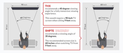

THX vs SMPTE Viewing Angle
THX recommends that the ideal screen should fill 40 degrees of the viewer’s field of vision. This does not sound like much at first, considering humans have almost 180 degrees peripheral vision and a stereoscopic field of view of around 100 degrees. However, given the average viewing distance is 9 feet, this would mean at TV would have to have a screen diagonal of 90 inches to meet this criteria. This seems very large compared to today's average screen sizes but might well be a sign of things to come. Vary large HDTV screens provide a more immersive viewing experience, more akin to a cinema or IMAX screen.
SMPTE instead recommends a viewing angle of 30 degrees. While this is less than the recommendation from THX, it would still require a TV with a 68” inch diagonal screen when viewed from 9 feet away. This is a more practical and economical sized display for most folks.
However, following THX or SMPTE guidelines, bigger really is almost always better. If you can afford it, go for a larger screen as it’s unlikely you will ever feel that the HDTV you bought is too big unless your susceptible to motion sickness while watching somebody play video games.
