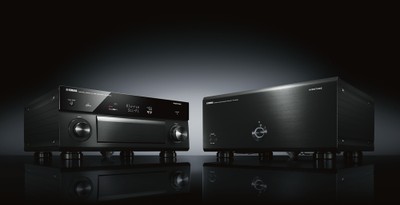

Yamaha’s Aventage CX-A5000 A/V processor and MX-A5000 multichannel amplifier.

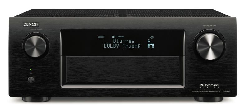

The Denon AVR-X4000, a modern receiver with all the trimmings.

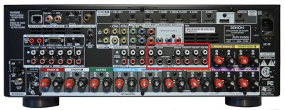

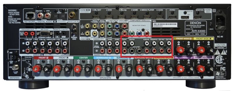

Then there’s also the matter of practicality with respect to power. Realistically, many people don’t have much use for 1kW monoblock amplifiers; the amps built into a run of the mill A/V receiver might be enough. Adding a bit of fuel to the fire, a lot of midline and high end receivers offer preamplifier outputs, meaning you can still add a separate amplifier if you find yourself needing more juice down the line. Many enthusiasts utilize this option, as you get the full benefits of big power and the regular release cycle of receivers (which still tend to be cheaper than a high end preamplifier/processor). In this case, note that it’s still important to ensure that your receiver’s preamplifier outputs can effectively drive the amplifier you’re looking at (Audioholics does measure this when applicable in our A/V receiver reviews); output of 2Vrms is usually adequate to drive the majority of amplifiers to full power, though some models may require more (you’ll find the voltage needed under the amplifier’s input sensitivity specification).
Check our our article on Amplifier Voltage Gain for further details.
Rear panel of the Denon AVR-X4000 with the preamplifier outputs highlighted.
