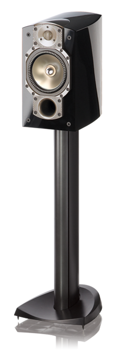

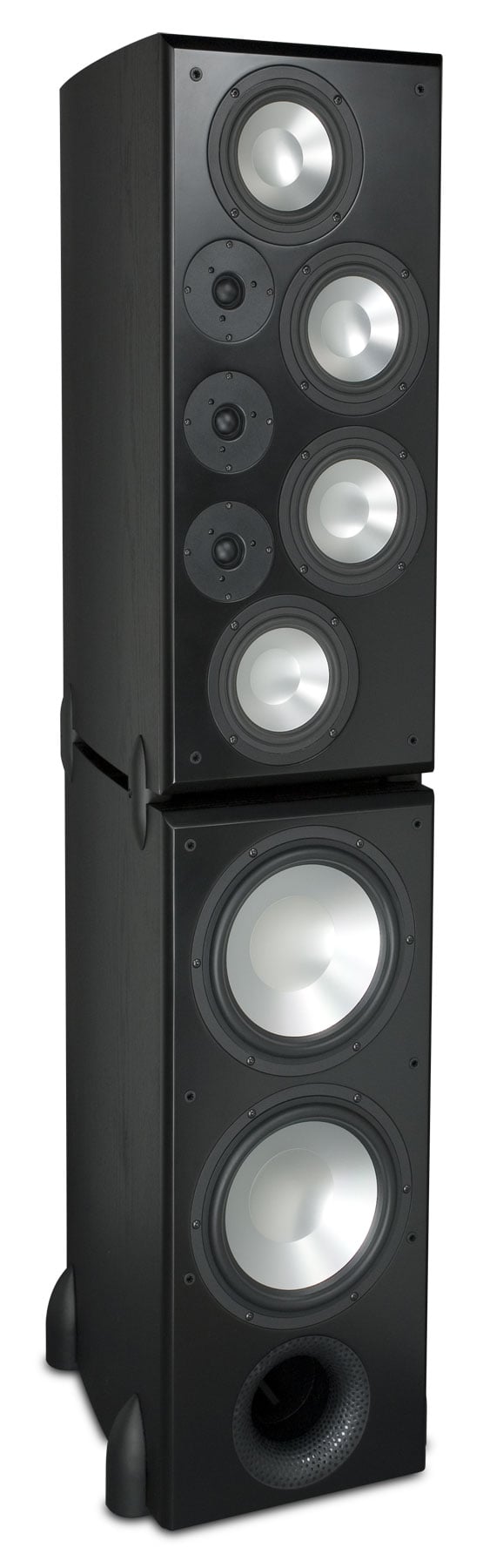

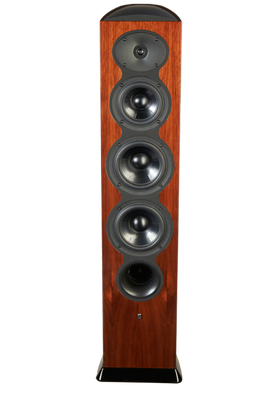

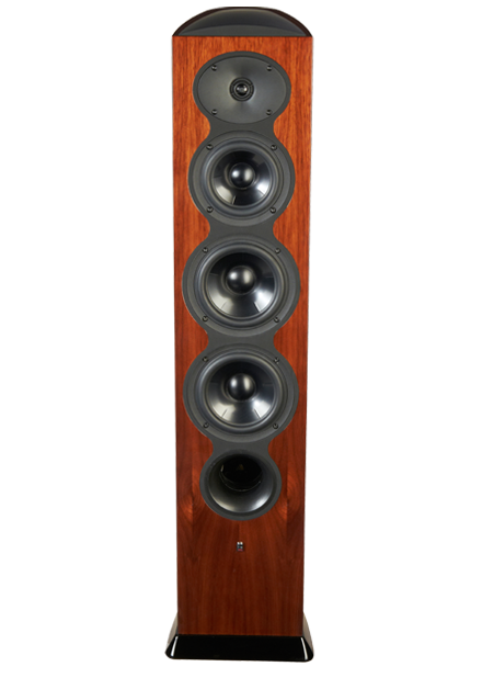

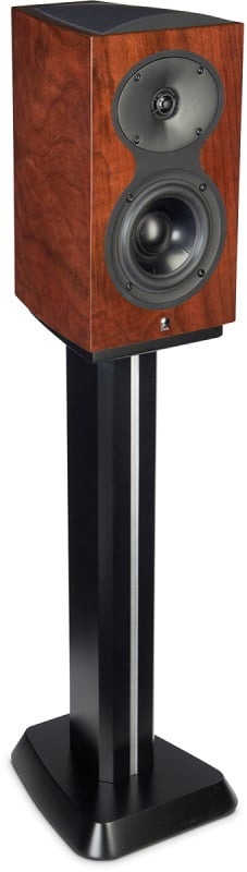

Revel Performa3 m105 bookshelf speaker stands  Revel Performa3 f206 tower speaker RBH SX-T2 Sub/Sat Speaker
Pictured from left to right: Revel Performa3 M105 Bookshelf and F206 Tower; RBH SX-T2 Sub/Sat System

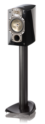

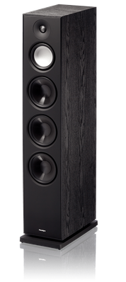

Paradigm Signature S2 Bookshelf  Paradigm Monitor 11v7 Towers
From Left to Right: Paradigm Signature S2 Bookshelf ($1,699/ea); Paradigm Monitor 11v7 Towers ($799/ea)
