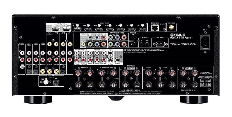

 RX-A3060 rear
Rear view of the Yamaha RX-A3060
Fortunately, all is not lost for DSD lovers who want to enjoy their music in all its multi-channel glory. We double checked with Yamaha, and confirmed that while the RX-A3060 does not offer multi-channel analog inputs, all models from the RX-A1060 on up can decode DSD natively through and HDMI connection to your Blu-ray player. We also note that Yamaha uses ESS SABRE DACs in its top flight receivers, just like the OPPO BDP-105. As such, we are confident that the RX-A3060’s D/A conversion is up to snuff.

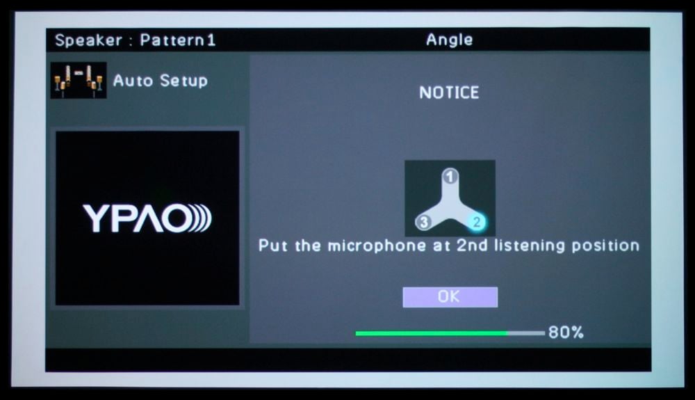

YPAO
The dirty little secret: want room correction or bass management? You’re converting to PCM.
For those whose receivers can’t decode DSD natively, don’t fret! Regardless of whether you feed your receiver analog, DSD, or have your player convert to PCM, there’s very little (if any) qualitative difference in the end result. Part of this has to do with what happens inside your receiver. If you’re applying bass management or room correction ala Audyssey or YPAO, your AVR has to convert the incoming audio stream into PCM anyways. While purists may claim this degrades the signal, in the real world where we don’t have perfect full range speakers inside perfect listening rooms, the benefits vastly outweigh the costs. In the case of the Yamaha RX-A3060, we’re told that this conversion takes place with a sample rate of 88.2kHz versus the usual 48kHz, keeping the signal as pristine as possible out to the limits of human hearing.
