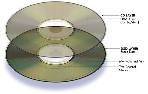

SACD Analog Filter
SACD has no digital filter and relies totally on the analog low pass filter at the output of the DAC. This gives SACD a very distinct improvement in transient response vs. the standard CD. SACD also uses noise shaping and has a pretty high output of ultrasonic noise at approximately 100 kHz. Is this good for your tweeters? Sony says it's low enough to not do any damage.
The potential for abuse further down the line is a real possibility and a very questionable practice to many of us with extensive analog backgrounds. SACD uses an entirely different way of moving data through the digital domain, which Sony has called DSD. This was invented by Sony as an archival format because just about any of the present sampling rates used can be ãmovedä out of DSD and into a PCM format. Note:( The PCM format is the basis for CD and DVD-A.)

SACD is an audio format only at present.  At time of writing, we know of no other uses for the SACD format. SACD does offer a dual layer to include a CD track; DVD-A at time of writing does not incorporate the dual layer. DVD/DVD-A discs (blank discs) will be cheaper than SACD because of its broad range of users (Computers, audio, and video).
