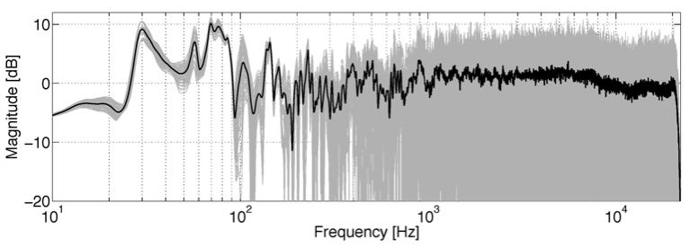

This picture below shows 64 different measurement points in a room (one loudspeaker only). You might think that you don’t care about the results in that many points. Correct, but then you should be aware that these measurements were taken in an area spanning a very small volume of only 0.3 by 0.3 by 0.3 meter in the normal listening position of a chair! If you would just pick one of these measurement positions, you would be very lucky to get anything near the average (bold) line below. And if you are not that lucky, your “correction” will only improve some aspects, and actually deteriorate others.

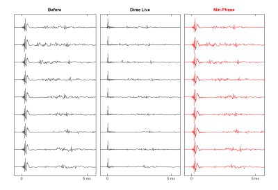

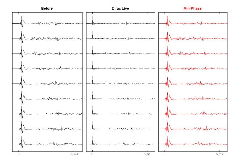

Here is another image. It shows impulse responses from 9 different measurement positions within the sweet spot of a very well damped room using Genelec monitors. The impulse responses have been time-aligned here to make them easier to compare. For reference, we show how the same impulse responses look after application of a Dirac Live filter and another filter with identical magnitude response but no phase correction (a so called minimum phase filter)
Our approach gives an optimal compromise between multiple measurement positions, both in the frequency domain and in the time domain. Out of the room correction systems that we have been able to test so far, no other system yields a time-domain correction which is useful for many positions (for example, two ears). From the multiple measurements, we infer which time-domain and frequency-domain properties are common to all measurements, and therefore can be robustly compensated. In mathematical terms, we can derive the optimum filter by evaluating how the poles and zeros of different measurement positions are clustered. It is a cautious strategy in line with the maxim that we should optimize as much as we can, but not more.
Most other room correction systems are minimum-phase, which means that they try to not add any time-domain distortion, whereas Dirac Live actually reduces time-domain distortion. The results are audible in terms of imaging, clarity and bass tightness.
