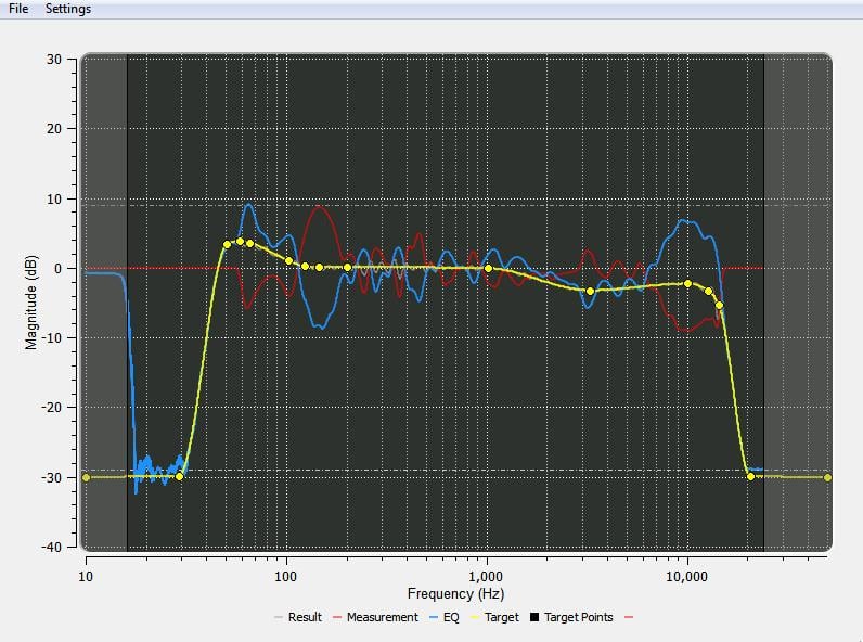

Equalized Response
Graph showing the before measurement, applied EQ, and target response.
Audioholics: What is the maximum boost / cut your products will apply? Is it possible for users to set a limit in this respect (i.e. no more than 3dB of boost)?
Yoshi Asahi: The maximum range is 20dB boost and 30dB cut. The range can be adjusted by the installer to any level.

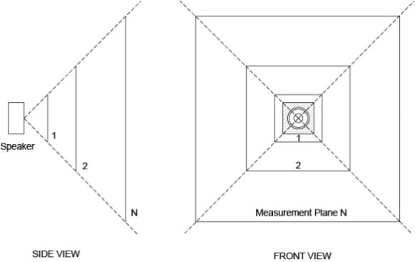

Audioholics: Do your products utilize multi-point measurements? Why or why not? If so, how many measurement points are available?
Yoshi Asahi: Eilex PRISM typically uses a few hundred measurement points in each speaker’s frontal space. We make measurements of a speaker along the frontal hemisphere of at least 100 points about 2’ away from the speaker, then repeat the measurement a couple more times along different hemispheres by increasing the distance from the speaker.  The result leads to a complete frontal space measurement.  Around 300-500 measurement points are used, thus we can say PRISM measurement is still a near-field APVD measurement.

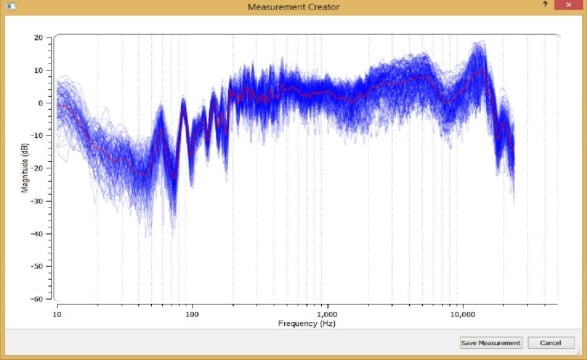

 Measurement 2
Sample APVD measurement graph.
Audioholics: Does your room correction software show users "before", "target", and "after" response curves? Is it possible for end users to adjust the final response curve such that they can flavor the sound to taste?
Yoshi Asahi: Yes, Eilex PRISM shows original APVD, target curve and expected APVD result. The target curve can be modified in real-time while listening to the sound.
