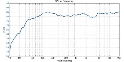

On-axis frequency response is the starting place for measuring loudspeakers because it describes the initial sound that reaches a listener’s ear from a loudspeaker. Although this response is the most revealing factor in determining how a loudspeaker sounds, it is only part of the complex auditory scene perceived by the listener. Another part of the auditory scene is constructed from the interaction of a loudspeaker with the room that it is playing in. Loudspeakers radiate sound into a room in various three-dimensional patterns that typically vary drastically as a function of frequency. This causes a set of interactions only reproducible by, among other things, the combination of loudspeaker location, a specific listening environment and a precisely positioned listener. The unique ear of the listener receives a barrage of acoustic information that is then converted into signals transmitted to the brain. The brain is a sophisticated signal processing system that more or less decides how the listener perceives the signals received. Understanding how the brain processes sound is a topic of ongoing research and holds keys to advances in acoustics.
The frequency response of a loudspeaker can be obtained by first measuring the impulse response. The impulse response, in theory, represents the output of the loudspeaker when presented with a pulse signal that lasts for an infinitely short amount of time. Since there are some obvious issues with generating such a signal, it can be approximated using a maximum length sequence (MLS) consisting of pseudo-random pulses. Circular cross-correlation of the MLS input with the loudspeaker output generates a good approximation of the system’s impulse response. Assuming the loudspeaker is a linear time invariant (LTI) system, the time domain impulse response characterizes the loudspeaker frequency response through the properties of the Fourier transform. Since this is all done using digital signals, the computationally efficient Fast Fourier Transform (FFT) algorithm is applied to obtain the Discrete Fourier Transform (DFT) of the impulse response. For the interested reader, check out MIT’s cool tie wearing Alan Oppenheim’s course on discrete-time signal processing (MIT Open Course Ware - Discrete-time Signal Processing).
On-Axis Frequency Response Sample
The on-axis frequency response measurements are conducted with a 2.83VRMS excitation signal at a distance determined by proper summing of all drivers in the system. This distance is determined by successively conducting the windowed measurement described below starting at 3 times the largest dimension of the source and decreasing the measurement distance in steps until one step before response deviations are apparent. The SPL response for all measurements will be scaled to 1 meter mathematically.

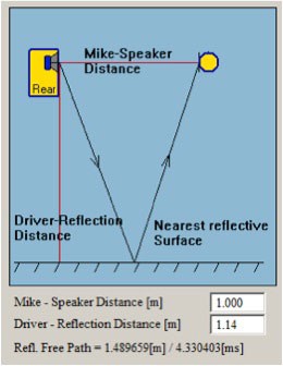

Accurately measuring a loudspeaker’s impulse response is not a trivial task. The difficulty lies in the fact that the measurements must be taken in a real space, and that space has some level of impact on the measurement. One of the most useful places to conduct loudspeaker measurements is an anechoic chamber. Anechoic chambers are large rooms with very thick sound absorption material on all surfaces and offer a good estimation of free-space measurements down to a cutoff frequency specific to the chamber. Anechoic chambers can be calibrated to measure loudspeakers to frequencies below the cutoff frequency allowing full acoustic spectrum measurements. Unfortunately, they are very expensive to build. Mere mortals are left measuring loudspeakers using quasi-anechoic techniques that are intended to approximate anechoic measurement techniques.
For measurements made in room, a signal processing technique called windowing is applied to only use the part of a measured impulse response that contains data before the first reflection of the sound from the nearest surface (usually the ceiling or ground). Calculating the length of the reflection free path and dividing by the speed of sound determines the reflection time.
The reflection free path length is determined by the following equation:
As an example, a speaker 1.14 meters off of the ground with a microphone distance of 1 meter yields a reflection free path length of approximately 1.49 meters. The amount of time before the first reflection arrives is simply calculated by dividing the reflection free path length by the speed of sound. This means that, in this example, we can use 4.3ms worth of the impulse response or frequencies as low as 230Hz considering the speed of sound is 344 m/s. A window with a length equal to the gate time is applied to the impulse response. This gated response means that the measurement taken at 1 meter is only valid from 230Hz on up to 20kHz+. Analogous to Heisenberg’s uncertainty principle, more accuracy in the window time yields less accuracy in the frequency response. This means that, in the case of a 4.3ms window time, the frequency resolution is 230Hz yielding a small number of data points for low frequencies. Software interpolates the missing data points but the results can potentially miss important variance in the low frequency data.
Mic Distance Diagram

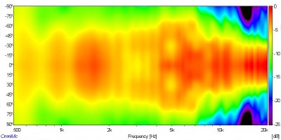

Polar Response
Polar response measurements are obtained by measuring the loudspeaker from 0 to 180 degrees in 7.5 degree increments following the same methods used to obtain on-axis frequency response at the reference distance. The vertical axis of rotation is the acoustic center of the baffle. In cases where the loudspeaker does not have vertical symmetry, the measurement is taken from 0 to 360 degrees. Polar response measurements from 0 to 90 and 90 to 180 degrees are contour plotted in software for a clear representation of polar response versus frequency for the forward plane and rear plane of the loudspeaker. This information can be used to determine loudspeaker directivity, room interactions, off-axis listening and gives a general idea about the power response of the loudspeaker in the horizontal plane.

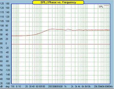

Impedance measurements are conducted using a very simple technique. A resistor of a known (measured) value is placed in line with the positive speaker terminal. Two voltage probes connected to a soundcard are connected to the amplifier side of the resistor. A 1kHz test tone is sent to the loudspeaker and the difference in the sensed voltage is automatically calibrated out in the measurement software. Next, one of the measurement probes is moved to the speaker side of the known resistor and an MLS sequence is generated. The impulse response of the impedance and phase is captured and converted to the frequency domain using the same techniques discussed in the on-axis frequency response section.
Impedance and Electrical Phase Sample
The impedance of a loudspeaker is important when trying to mate a loudspeaker with an amplifier. An ideal audio amplifier should output a constant voltage regardless of the impedance of the speaker. However, no amplifier can produce infinite current. Using Ohm’s law, it is clear that as impedance decreases the current must go up in order to hold voltage constant. Many amplifiers are not designed to handle impedances below 6 ohms due to the increased current draw.
The lowest impedance is measured at DC, which is also known as the DC resistance. The IEC 26-8 method of specifying nominal loudspeaker impedance is set such that minimum impedance must not fall below 80% of nominal, so for an 8 ohm speaker this would be 6.4 ohms minimum, and for 4 ohms would be 3.2 ohms.
The impedance phase is an important factor to look at as well, because it relates to how efficiently the amplifier can deliver power to the loudspeaker. When the phase angle of the impedance is greater than 0 degrees, the loudspeaker is presenting a partially inductive impedance to the amplifier which typically does not pose much threat to amplifiers. When the phase angle is less than 0 degrees, the loudspeaker is presenting a partially capacitive impedance to the amplifier. A large capacitive load can cause instability in some amplifiers.

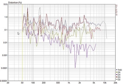

Harmonic distortion components are generated by exposing a loudspeaker to a stepped sinusoid excitation signal and measuring the system’s response. To reduce the effects of noise on harmonic distortion measurements, the software uses heterodyne filters to select the harmonic frequency being measured. The total harmonic distortion measurement is displayed in percent representing the percentage amplitude of harmonic distortion present compared to the fundamental.
This measurement is conducted on axis with a stepped sinusoid excitation signal at 90dB measured from 2-meters. The 2nd through 5th harmonics are graphed together with the total harmonic distortion (THD) showing the constituent parts of the total harmonic distortion.
Analysis of the THD results should be taken in the context of the loudspeaker under test. Note that the distortion percentage is a logarithmic scale. The components listed as D2-D5 represent the 2nd through 5th harmonic of the fundamental. The graph shows the amount of each harmonic present at the given fundamental frequency. So the contribution to distortion from the 2nd harmonic of a 1kHz signal is visible by finding the line for D2 at 1kHz. In this case, D2 represents two times the fundamental frequency, which is 2kHz. Due to the limitations of the measurement/playback system and human hearing, harmonic frequencies above 24kHz will not be measured. Since a harmonic is an integer multiple of the fundamental frequency, the harmonic distortion plot for each harmonic stops when the product of the harmonic order number and the fundamental frequency equals 24kHz.
Harmonic Distortion % Sample
Harmonic distortion is a standard test applied to many systems handling signals. However, the correlation between harmonic distortion numbers and the human perception of sound quality is very poor. This is because harmonics are typically masked in the broadband music signal. Additionally, harmonics do not sound as bad as frequencies that are not integer multiples of the fundamental. Inter-modulation distortion is another type of distortion that is produced when a loudspeaker plays multiple frequencies simultaneously. Inter-modulation distortion is particularly offensive because it creates distortion at frequencies that are sums and differences of a mixed signal. The frequencies produced are not musically correlated with the fundamentals that produced them. Audioholics is actively researching methods to measure and display inter-modulation distortion that are presentable and useful to readers.

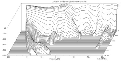

Cumulative spectral decay is a very easy way to identify loudspeaker resonance issues. If a cabinet or driver has an issue with resonance in the audible band, the cumulative spectral decay plot shows how the response of the loudspeaker decays from an impulse excitation signal versus frequency. As was discussed in the On-Axis Frequency Response section, the discrete Fourier transform of a gated impulse response generates frequency response. To see the decay, the window is simply moved forward a certain amount of time and the discrete Fourier transform is calculated using the fast Fourier transform successively until the reflection free window time is reached. This measurement is obtained at 2.83VRMS at the reference distance discussed in the on-axis frequency response section. The sample results show the low frequency data cutoff curling to higher frequencies, this is due to the moving window.
Editorial Note Regarding CSD by Dr. Floyd Toole:
Because of the time gating, necessary to see into the time domain, frequency resolution is sacrificed – note the smoothness of the curves. This means that energy in a high-Q resonance is spread over a wider frequency range, resulting in an artificially low level. Besides all of this decorous displaying of data, the fact is that, except at very low frequencies, humans do not hear the ringing, we hear the spectral bump (which, ironically in these displays cannot be accurately seen). See Section 9.2.1 in my book [1]. See also Figure 13.23 p. 246 for examples of the “uncertainty” principle as applied to waterfall displays of data. You have a choice of seeing high resolution in time or frequency domains, not both. They are pretty, though.
In perceptual terms, the audibility of ringing is substantially reduced by a phenomenon known as “forward temporal masking” – the initial sound reduces the audibility of sounds that immediately follow it.
[1] F. Toole, Sound Reproduction: Loudspeakers and Rooms. Burlington, MA: Elsevier, 2008
CSD Sample

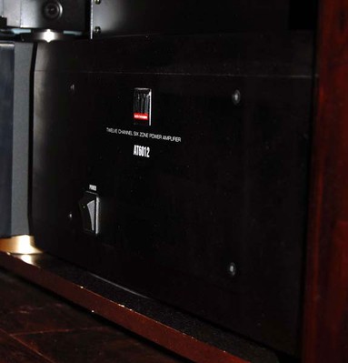

The ATI AT6012 is a 12-channel power amplifier used for measurements. The amplifier is used because it is flexible, reliable and has excellent performance. The AT6012 is capable of driving very low impedance speakers and provides very good voltage stability. In cases where speakers must be bi-amplified or tri-amplified for testing, the AT6012 amplifier has sufficient current to drive all channels simultaneously at the voltage levels required for testing.

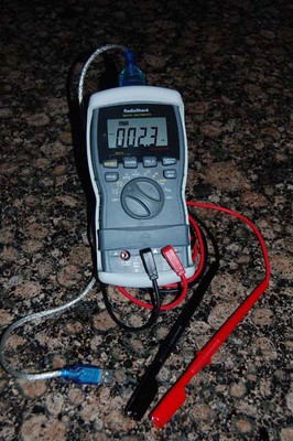

The Radio Shack Digital Multimeter (DMM) with RS-232 serial output is a necessary tool for obtaining measurement and calibration parameters. The RS-232 output links to computer software that provides the DMM output directly on the measurement computer screen. This is extremely convenient while trying to set and test voltage levels at different loudspeaker playback levels. As needed, the multimeter readings are compared to a Tektronix TDS3000 series oscilloscope with an input signal of 2.83VRMS at 60Hz, 120Hz and 500Hz to validate accuracy.
RadioShack Multimeter with RS-232
