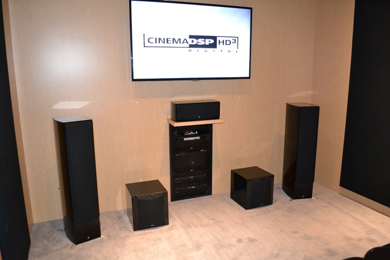

Our first Atmos demo of the Expo came courtesy of the fine folks at Yamaha. On display was a 5.2.4 setup built around their AVENTAGE RX-A3040 A/V receiver, NS777 towers, NS333 center, and NSIC800 in-ceiling speakers. The room was semi-enclosed, i.e. it had a ceiling and three walls, but it wasn’t acoustically isolated due to the open back. Unfortunately, there was a considerable amount of background noise (foot traffic, other manufacturers still putting up their booths, etc.) which took away from the experience. Between that and the short demo material, it was hard to get a feel for what Atmos could really bring to the table. However, there was something which stuck with me from this demo, namely a projector coming to life in a movie theater. Simply put, it was exactly where you would expect to hear such a sound come from, which isn’t just directly behind, but from above as well. While this was a neat trick, I wasn’t exactly sold yet on what Atmos could deliver. As a second opinion, Cliff felt that the in-ceiling speakers were fairly precise in terms of imaging height effects, but easy to localize since they were turned up for wow factor. I appreciated this precision, though I didn’t have a significant issue with localization, which we’ve found can vary considerably with seating position relative to the ceiling speakers.

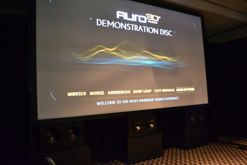

After visiting with Pioneer, Cliff and I made the long walk to Auro’s demo room which was situated across the hall. Suffice it to say, few systems present at CEDIA could compete with what Auro brought to the party. In addition to a Datasat RS20i processor boasting Dirac Live room correction, the Auro room featured a 20.1 setup consisting of James loudspeakers and no less than six subwoofers. The speakers were arrayed in nine channel arrays; the first array was oriented at ear level, with the second height layer being placed roughly five to six feet above ear level. Two “voice of God” speakers were utilized for overhead effects.
To call Auro’s demo impressive would be the understatement of the year. In fact, it was by far our favorite demo experience of the show though we didn't get the chance to hear the highly regarded JBL Atmos demo.  Part of this was undoubtedly due to the caliber of the system present, but the added ambient information provided by the height layer added a sense of scale that simply wowed both of us. A wide selection of material was played back including an organ piece recorded in a church, as well as an orchestral piece. However, the star of the show was a jet flyover. As someone that occasionally parks near an airport to watch (as well as listen) to planes taking off, I can say that this demo was extraordinary in its realism, which certainly wasn’t hurt by the dynamic capability of the system.

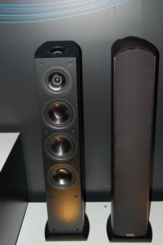

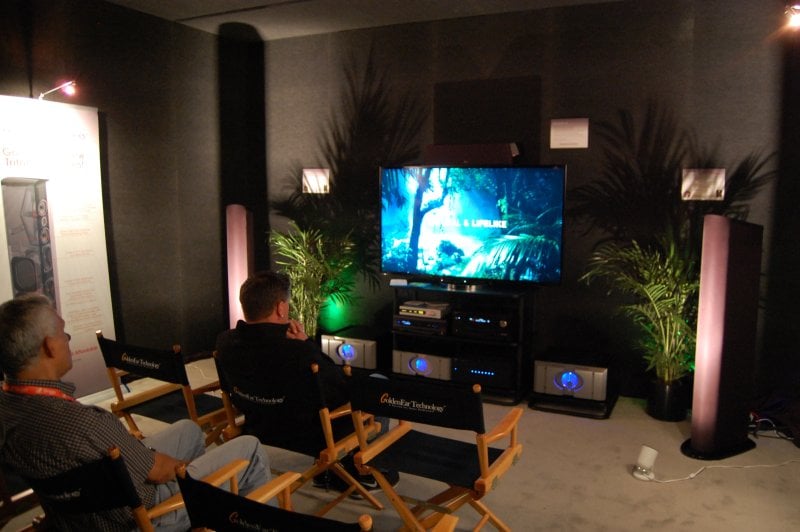

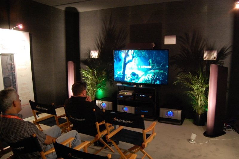

GoldenEar
The penultimate demo of our time at CEDIA came courtesy of Sandy Gross, CEO of GoldenEar Technology. GoldenEar was showing off their new Triton One tower speakers as part of a 5.1.4 setup which included a quartet of in-ceiling speakers. Like the previous demos with D&M and Onkyo, the GoldenEar system pulled off convincing height effects on both Dolby’s dedicated demo material and movie clips from Star Trek: Into Darkness and Oblivion. GoldenEar was also the first to play a clip from Transformers: Age of Extinction for us, which will be the first Blu-ray release with Atmos. While the movie wasn’t exactly our cup of tea, no switching was required to tell that Atmos made a clear cut difference.
