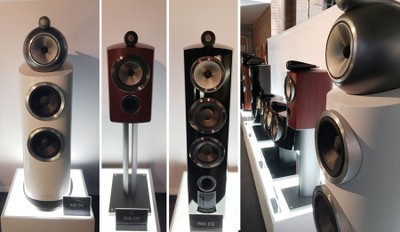

B&W 800 Series Linuep
B&W had each model of the newly-announced 800 Series Diamond line on-hand for us to see close-up

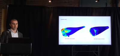

The diamond tweeter is the one material that hasn’t changed in the new models.  B&W says they couldn’t find anything that was a superior performer to their synthetic diamond.  That doesn’t mean there were no improvements to the tweeter’s overall design, however.  In the new models, the tweeter body has been completely replaced.  Instead of the hollow enclosure of the previous generation, the new tweeter body has been billeted from a single body of solid aluminum.
Using a solid piece of aluminum addressed several problem areas—especially around the 4kHz region, where the comparison focused.  A slide analyzing the stresses manifest on the old vs. the new housing were night and day differences.  Slides aside, Stuart resorted to a simple example to emphasize the point.  He took the previous tweeter body and struck it.  It rang like a tuning fork.  Striking the new tweeter body yielded a totally dead thud.
Tweeter Assembly
Stuart Nevill shows the differences between the previous generation's tweeter assembly (left) and the new billeted aluminum assembly (right)

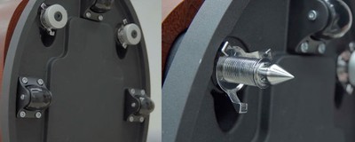

But the refinements in the plinth don’t stop there.  B&W completely re-thought the purpose of the plinth as a stabilization platform and conceived of it as a way to help tune the speakers to the room. When B&W showed off this one simple, but brilliant refinement, all I can say is that this is where high end companies like B&W strut their stuff by marrying ingenious industrial design with practical needs.  Here’s what they did:
If you have ever had to position or move incredibly heavy speakers, you know what a chore this can be. Now, the top of the line 802 D3 and 803 D3 plinths come with permanent castors.  You can roll the speakers and re-position them with incredible ease.  Then, once you’ve solidified the positioning of the speakers, you just spin the new, integrated spikes down with a simple twist of a cog from the plinth and lock them into place.  Have a hardwood floor?  No problem, the spikes come with magnetic feet that literally snap onto the spikes to protect any sensitive flooring.  I cannot emphasize enough how brilliant this simple addition is to dialing in your speakers to your room.  Gone forever are the days of tipping your speakers on its side.  Welcome to the days of being able to fine-tune your B&W Diamond Series speakers with ease.
integrated spikes
The integrated wheels and spikes are a brilliant example of B&W's industrial design that makes moving and securing the speakers a breeze

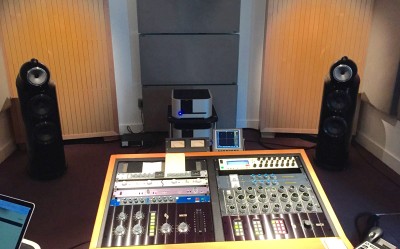

Next up, we went to an adjacent room where we auditioned several tracks through the 802 D3s.  Once again, digital source files were fed from a Macbook pro to a Classé CP-800 but this time Classé’s flagship CA-600 monoblock amplifiers provided the foundational power.
Now, do I need to even state what you know to be the obvious?  The top to bottom experience of the 802 D3 was mesmerizingly beautiful.  The 802 D3 simultaneously exuded refinement and command.  The warmth and full body sound of a grand piano playing Mozart resonated in all its glory through the 802 D3s.  LeAnn Rimes vocals on “What I Cannot Change” were solidly placed and, at times, had that almost inexplicable quality fooling you into thinking that you were experiencing the performance.
B&W 802 Listining
The 802 D3s were mesmerizingly beautiful from top to bottom in their presentation.  The 802 D3s were powered by Classé's flagship CA-600 monoblock amplifiers
