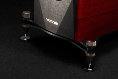

The higher end speakers also incorporate an isolation support system to decouple the speakers from the floor that Sonus Faber alternately calls a Low Vibration System and a Zero Vibration System. Both make use of elastomer dampers and culminate in what Sonus Faber calls the Bowspring, the version used for the flagship Aida loudspeaker. Isolation systems are generally difficult to implement without short circuiting through contact between stiff elements across the gap while still trying to provide adequate support of weight. The devil is, as always, in the details.
As an example, there is an image shown on Sonus Faber’s web site of one such system at the base of an Amati Futura. There is an upper and lower plate separated by an elastomer pad, but the carpet spike supports passing though the plates appear to be in hard contact with both plates. Based on what is shown, the elastomer pad may still provide some damping, but without additional elastomer pads between the spike and each of the plates and holes in each plate that are large enough to maintain a gap with the threaded rod passing through, vibration can route around the elastomer pad that is present.

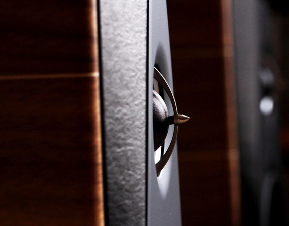

Sonus Faber speakers also use similar concepts for the driver designs across many of their models. A number of their speakers use ring radiator tweeters, a variation on a dome tweeter with a central stationary peak that acts as a phase plug while the surrounding ring around the peak is driven to emit sound. In some speaker models, Sounus Faber uses a variation on the ring radiator that they refer to as a Damped Apex Dome. This is a dome hybrid where the peak of the dome at the center is restrained from moving by a fixed phase plug looking frame spanning over the dome mounted to the driver flange, forcing a ring like behavior in the driver. Tweeters and midrange drivers are frequently isolated in acoustically tuned chambers by Sonus Faber in a number of their products. Sonus Faber’s midrange and woofer drivers are often based on diaphragms made from the aforementioned real time air dried non pressed blend of cellulose pulp, kapok, kenaf and other natural fibers with viscous surface treatment that also frequently make use of a device that Sonus Faber calls a coaxial anti-compressor at the center of the drivers rather than a dust cap or phase plug that they claim will remove cavity resonance and distortion. A dynamic driver alternates between compression and tension as it is pushed and pulled by the motor to create sound and air, as a gas, can only transmit sound as variable compressive pressure in the air relative to the overall positive compressive pressure of the atmosphere. So, based on a direct reading of the words used, it is not clear exactly what compression this anti-compressor is against or how eliminating it is beneficial.
a) Damped Apex Dome tweeter.
b) Ring radiator tweeter.

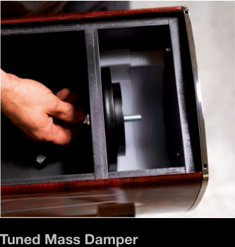

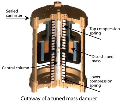

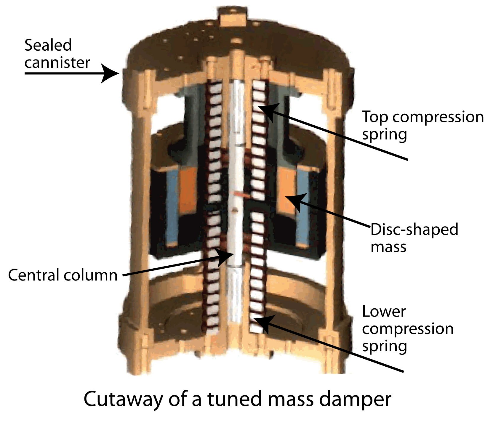

Then there is this business of a Tuned Mass Damper (TMD) used by Sonus Faber in some of their higher end speakers. Tuned mass dampers come in a number of forms, with the type used in formula one cars based on a one dimensional cylindrical mass spring system while those used in skyscrapers are often a two dimensional pendulum type. These systems are not dampers by a rigorous engineering definition of the word, rather, they work by supporting a mass with springs that are soft enough to decouple it from the rest of the system such that when it does move, it is out of phase with the vibration to be suppressed. This creates a reactionary inertial force that opposes the primary inertial force of the object to be damped, not by converting motion to thermal energy as suggested by Sonus Faber on a number of occasions in their literature.
a) Image of Sonus Faber’s Tuned Mass Damper from a speaker under construction.
b) Diagram of the single axis Tuned Mass Damper developed by Renault for racing.
Based on images found in their product documentation, the device indicated to be a TMD by Sonus Faber, aside from some apparent missing parts, like the decoupling spring suspension, looks to be a couple of loose stacked plates with a central bolt to hold them in place laterally. Sonus Faber claims they are used to erase micro-vibrations, but these masses look a bit too large to be excited into significant motion by vibration at acoustic amplitudes and even then, they would only suppress vibration along a single axis. Assuming the damper shown is oriented vertically in a cabinet that is set on its side for construction, it could only dampen vertical vibrations.

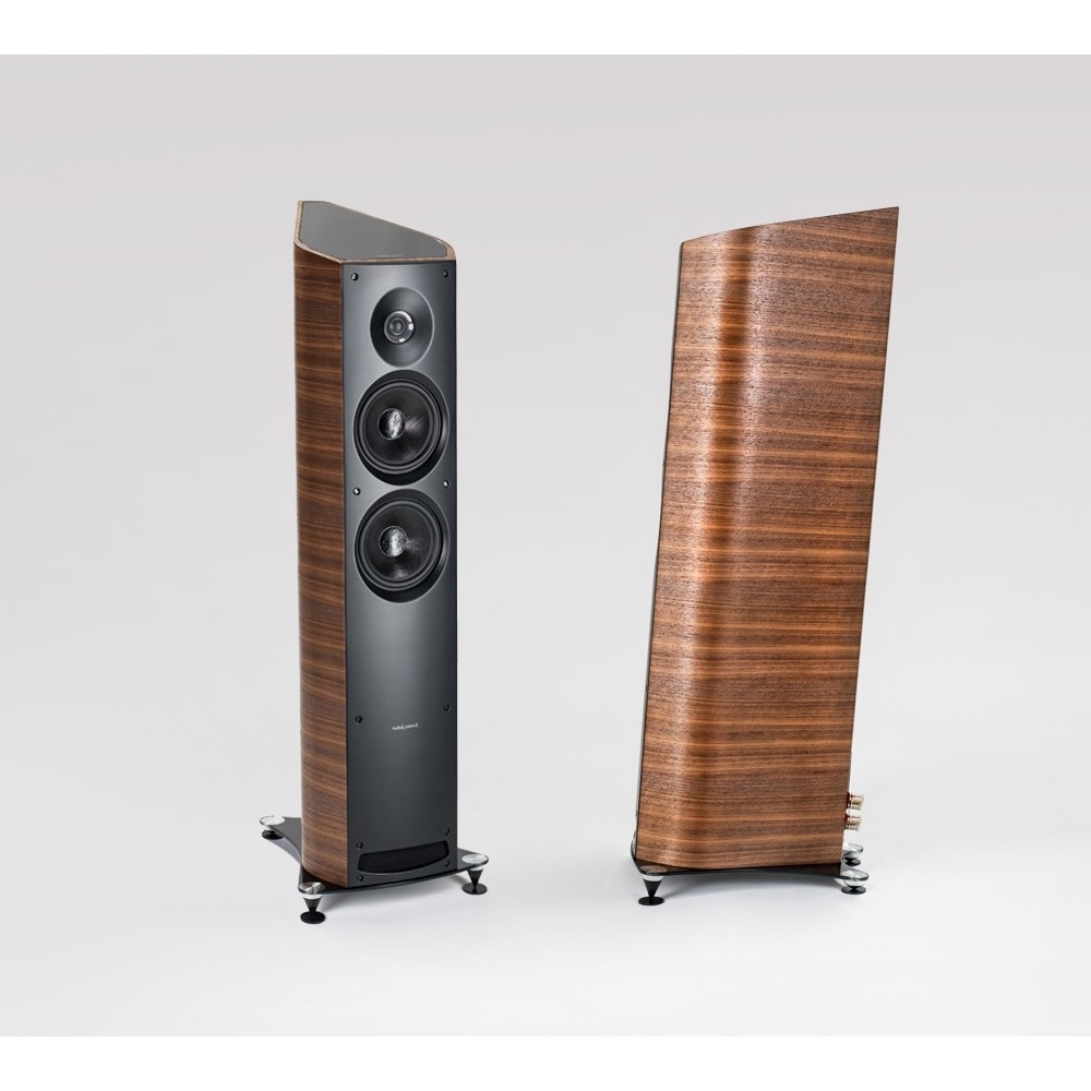

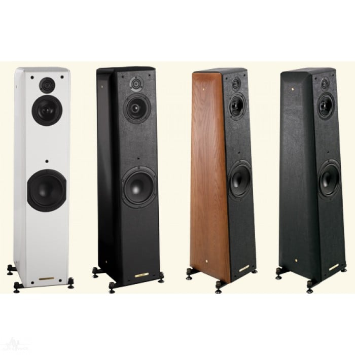

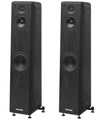

The entry level Toy product line features a single tower model, pragmatically named the Toy Tower. The three way ported design uses a 1 inch ring radiator tweeter, a 4.33 inch coated cellulose midrange, and a 7.1 inch hard Nomex cone woofer. The rectangular cabinet features rounded corners and is available in gloss white or black, barred or classic black leather, or stained wood in a medium brown. The side panels of the cabinet on the Toy are said to be decoupled form the rest of the cabinet to control resonances and standing waves. With a respectable 89 dB sensitivity and an 8 ohm nominal impedance, the Toy Tower should also be relatively easy to drive.
Two tower models grace the Venere line, the Venere 2.5 and the 3.0. Geared towards home theater and ease of placement, the front ported cabinets feature a curved lyre shape derived from the flagship Aida loudspeaker, a sloped baffle, and a peaked top. The Venere line is available in several finish options: gloss black or white along with a lacquered stained wood finish in a medium brown and feature an anodized aluminum bezel and tempered glass at the top and bottom panels. The smaller Venere 2.5 uses a 1.15 inch coated fabric dome tweeter along with a 7.1 inch Curv cone mid-woofer and a 7.1 inch Curv cone woofer on a tapered crossover. The Curv cones are made from what Sonus Faber refers to as a thermo-mouldered polypropylene fabric and are mounted in a free compression basket. The Venere 3.0 adds a 5.9 inch free compression basket Curv midrange as well as a coaxial anti-compressor that is said to remove resonances and distortions. From the limited description provided, it is not entirely clear if the free compression basket and the coaxial anti-compressor would oppose and cancel each other or not.

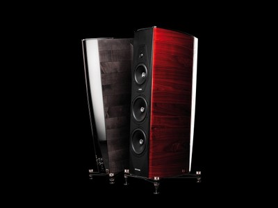

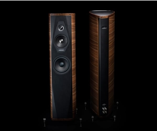

Next up, is the Olympica series that features two tower models, the Olympica II and III. The Olympica series are based on an Enhanced Lyre shaped progressive thickness triple curved wall cabinets, available in walnut or graphite stained wood, with solid walnut top and bottom plates used as a vertical clamp that like the baffle are clad in leather. Cabinet tuning is based on what Sonus Faber calls paralaminar stealth flow venting to minimize port noise. This system consists of a perforated metal plate along the rear edge, facing either to the left or right in paired speakers, that allow for inward or outward placement of the ports to best match room characteristics. The smaller tower, the three way Olympica II, uses three drivers. High frequencies are produced by a 1.15 inch Damped Apex Dome moving coil ring radiator tweeter. A 5.9 inch midrange cone driver composed of Sonus Faber’s favorite blend of cellulose and other natural fibers with a viscous surface treatment. This driver uses an eddy current free voice coil and features the coaxial anti-compressor. Bass output comes from a 9 inch sandwich construction cone composed of a rigid syntactic foam core with treated cellulose pulp surface skins. This woofer is said to be based on the driver design used in the flagship Aida speakers. The larger three way Olympica III adds an additional woofer to the driver compliment found in the II.

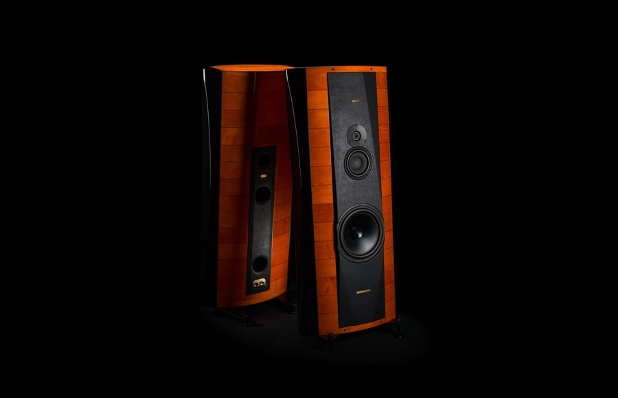

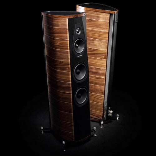

The Homage Collection, which are named after Italian violin makers, features two tower models, the Amati Futura and the Stradivari, with the former a narrow tower while the latter is a wide faced elliptical design similar to the Elipsa Red.
The first Homage tower is the 3.5 way Amati that Sonus Faber describes as a lute shaped progressive curvature cabinet constructed of multilayered cross grained Okoumè plywood, weighing in at 122 pounds each. The Amati cabinet design incorporates constrained mode damping, an avional Exo-Squeleton formed from a spine and the cabinet end plates, and a tuned mass damper. The cabinet acoustics are based on Sonus Faber’s Stealth Reflex Para-Aperiodic Port system and the sub chambers formed between the internal stiffening ribs are filled with a variety of acoustic damping materials ranging from open celled thermoplastic foams to fibrous material akin to felt, that are said to be optimized by application and location within the cabinets. The tower is mounted on an elastomer isolation base that Sonus Faber refers to as a Low Vibration Transmission system to decouple the speaker from the floor. The driver compliment of the Amati consists of a 1.15 inch dome with a vibration optimized mechanical interface, a 7 inch real time air dried and non pressed cellulose fiber cone with an acoustic chamber and an eddy current free voice coil, and dual 8.67 inch elastomer foam damped aluminum/magnesium alloy cones with the coaxial anti-compressors. The woofers use a tapered crossover and also feature a 1.5 inch long throw motor with a voice coil designed to control eddy currents. Finish options for the Amati include red, walnut and graphite stained wood covered in seven layers of hand polished lacquer with a black leather baffle and the nickel coated avional caps and exposed spine at the rear.

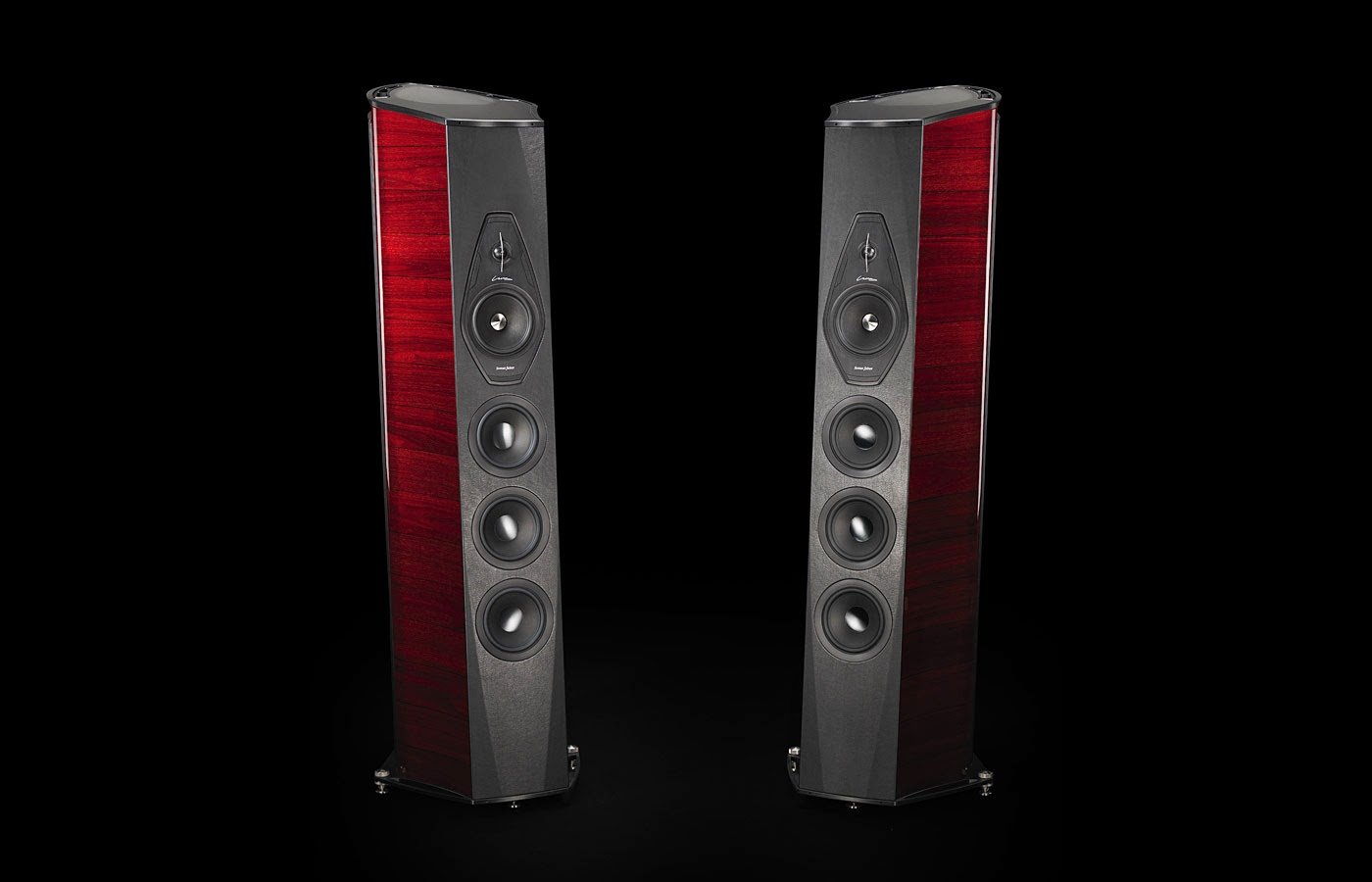

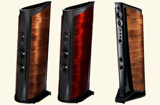

Moving on, we have the Lilium, a 3.5 way orthogonal non interactive dual enclosure tower speaker, which at 227 pounds, each, over a hundred pounds more than the Stradivari, makes the jump to the truly massive. Sonus Faber describes the Lilium as a Lyra shaped and having progressive thickness triple curvature cabinet walls damped spread resonance spectrum system. The top and bottom of the cabinet consists of two double dampshelves of avional connected by a column down the back of the cabinet. The main enclosure housing the tweeter, midrange and woofers is said to be decoupled from the infra woofer enclosure through a variation of the Zero Vibration Transmission system, which also isolates it from the room as well, and is said to radiate orthogonal to the main enclosure to avoid intermodulation. The Lilium cabinet also houses a dual frequency TMD said to futher control micro vibrations. The main portion of the Lilium cabinet is tuned with the Stealth Reflex System while the infra woofer chamber is tuned using a passive radiator. The Lilium tweeter is a 1.1 inch arrow point Damped Apex Dome mounted in a natural wood acoustic labyrinth rear chamber. Mid frequencies are provided by a 7.1 inch driver comprised of a viscous surface treated cone of real time air dried non pressed blend of cellulose pulp, kapok, kenaf and other natural fibers with the coaxial anti-compressor. This midrange uses an eddy current free voice coil and is mounted in an acoustic chamber. The triple forward firing 7.1 inch cone woofers use a tapered crossover across the divers which consist of sandwich construction diaphragms made from a rigid syntactic foam core, itself a particle reinforced composite material, with cellulose pulp surface skins. The woofer motor structure can accommodate 1.5 inch movement and the voice coil is designed to control eddy currents. The top firing 10.25 inch cone infra woofer is fashioned from a hard paper composite sandwich with a long throw motor that allows for 2.5 inch movement and has a rear mounted level adjustment to tune it to the system and room. The Lilium comes finished in either red or walnut stained wood with black leather around the drivers in the baffle and the exposed avional of the rear spine and cap plates.

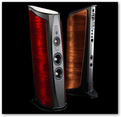

Rounding off the list is the massive flagship Aida tower. Similar to the smaller Lilium, the nearly 5’-8” tall 364 pound Aida is based on a Lyra shaped cabinet with dual curvature sides formed from layers of cross grained Okoumè plywood that, according to Sonus Faber, provide a constriction layer damped configuration that is vented using the Stealth Reflex Para-Aperiodic Port system. Also incorporated into the design of the Aida is an avional spine with connected top and bottom plates that are said to function as vibration dampers and again features a dual frequency TMD.
The Aida is a bipolar loudspeaker with additional high and mid frequency drivers mounted at the rear of the cabinet. The Aida uses an adjustable level 1.15 inch arrow pointed Damped Apex Dome mounted in a natural wood acoustic labyrinth rear chamber. The midrange driver is a 7.1 inch cone comprised of Sonus Faber’s favorite blend of surface treated cellulose and other fibers with the accompanying real time air dried non pressed processing. The midrange includes the coaxial anti-compressor and is also mounted in its own internal acoustic chamber. Sonus Faber makes further mention that the midrange has an eddy current free voice coil and that the basket is made of machined avional/gunmetal which is said to be thoroughly optimized to eliminate any resonance. Both the tweeter and the midrange drivers are mounted with an anti-resonator to decouple them from the cabinet. The dual 8.67 inch woofers are mounted in an internal Stealth Reflex chamber and comprised of sandwich construction cones made from a rigid syntactic foam core with treated cellulose pulp surface skins and include the coaxial anti-compressor. The motor structure for the woofers is a long throw design that can accommodate 2 inches of movement with voice coils designed to control eddy currents. The downward firing infra woofer is housed in the main portion of the cabinet and consists of a 12.6 inch honeycombed nanocarbon composite sandwich cone that has an adjustable level and a long throw motor capable of 3 inches of movement. At the rear of the Aida are the adjustable level Sound Field Shaper drivers consisting of a 1.15 inch dome tweeter and a 4.75 inch paper pulp/natural fiber blend cone driver. The finishes available for the Aida are lacquered white, red, walnut, or graphite stained wood with a black leather baffle and avional rear and cap plates.
