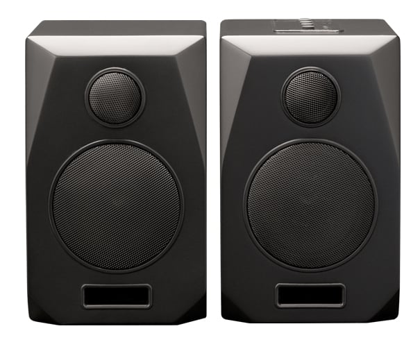

The Airmotiv 3b is a two-way, tuned-port design with a 3/4” dome tweeter and a 3” long-throw woofer.  The woofer uses a polypropylene cone with a ceramic magnetic assembly. The tweeter is 19mm woven textile dome with a neodymium motor structure.  The woofer and tweeter have metal protective grilles—a must for any speaker finding itself in an active work area.
The Airmotiv's enclosure is made of MDF. It has a matte, satin black lacquer finish that I found to be top notch.  The rear of the speaker, where the basic input connections are, is a solid aluminum panel.

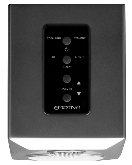

All control buttons are aligned in a vertical row.  Powering on the unit is as simple as depressing the top-most button on the right speaker, which is the power/standby.  You quickly realize Emotiva’s wisdom of putting all the control buttons easily within reach.  There’s no fiddling with rear power switches or anything of that sort.  Powering on the unit changes the speaker’s status light from red to blue.
Below the power button is an input button that toggles between Bluetooth and line-in.  Bluetooth and Line in inputs are clearly marked.  Selecting your Bluetooth input yields a blue light and selecting line input produces a green light. Which input you’ve selected is clearly visible from a standard seating position.  You’ll never find yourself guessing. Finally, there are two buttons dedicated to volume up and down.  There is no IR remote control to execute any of these functions.

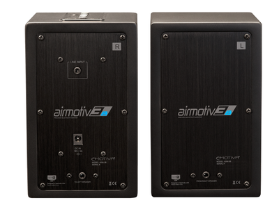

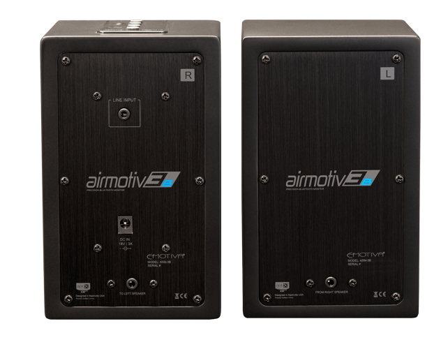

AirMotiv 3b rear
The rear of the Airmotiv 3b's right speaker has a 3.5mm analog line input if you don't want to use Bluetooth
