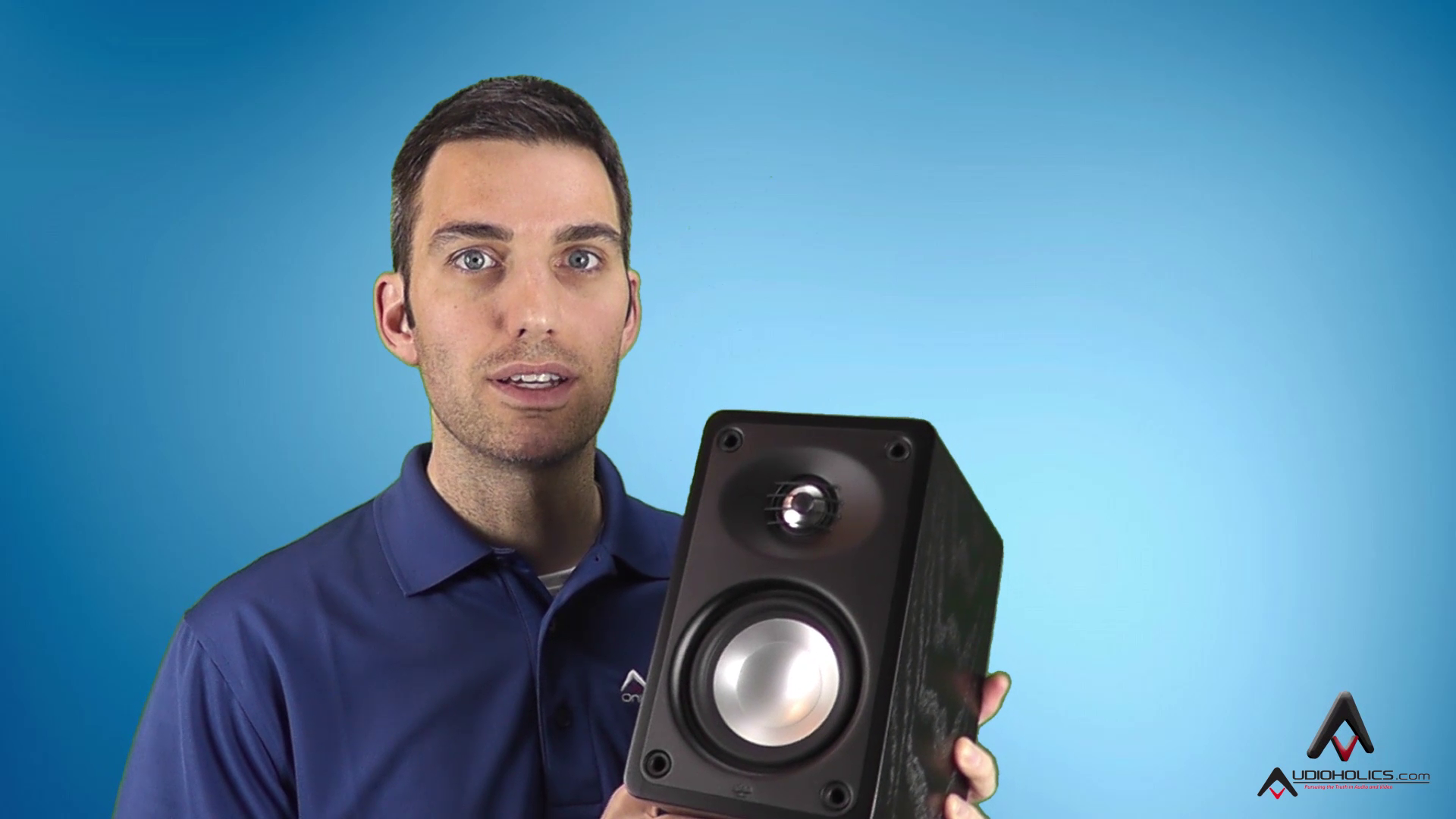

RBH MC-4C Introduction
The RBH MC-4C are a high-performance speaker in a very compact package. They address the internal conflict in many of us; we want high-quality sound, but would rather not have to accommodate huge speakers to get it. Too often, small speakers represent a big compromise in sound. However, with the RBH MC-4C, good things do come in small packages.

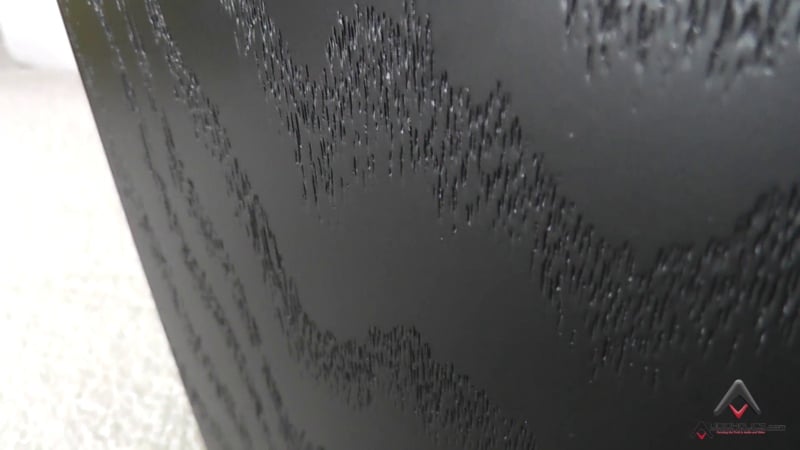

RBH MC-4C Deep Wood Grain
The black oak finish is something I haven’t seen before. The finish is not smooth, rather the grain is deep and actually provides a texture to the finish. Despite featuring the grain of the real wood veneer, I wouldn’t necessarily call the result organic, as the heavy finish, while flawless, makes the grain look a little artificial. It’s certainly unique, and I personally like it because, in a variety of lights, the pattern of the grain really jumps out, even at a distance.

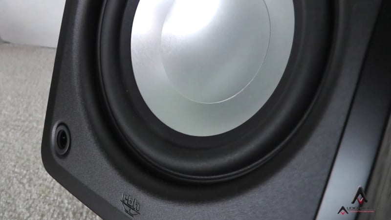

RBH MC-4C RDAB Front Baffle and 4" Aluminum Woofer
RBH’s Resonance Dampening Alloy Baffle (RDAB) is a metal plate adhered to the front baffle. Not only does it make the speaker look nice, but it is designed to increase audible performance by making the front baffle less likely to vibrate in sympathy with the drivers, not that resonance should be much of an issue. Given the small size of the cabinet, and the ¾” MDF construction, a knock test revealed near-zero in the way of cabinet resonance. The cabinet is also stuffed with fiberfill to limit resonance and interior waves.

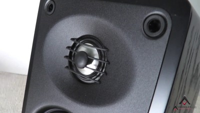

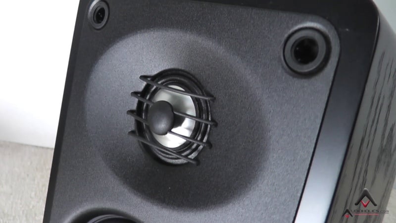

RBH MC-4C 1" Aluminum Dome Tweeter
Molded into the RDAB baffle is a waveguide with a 1” Aluminum dome tweeter. The tweeter is surrounded by a protective wire grill. The 4” aluminum dome woofer has a heavy rubber surround and is flush-mounted behind the baffle, with no mounting hardware visible or accessible. It makes for a very clean look with great fit and finish, though if there is a need for repairs, you’ll need to ship them back to RBH as your screwdrivers at home won’t do you any good.

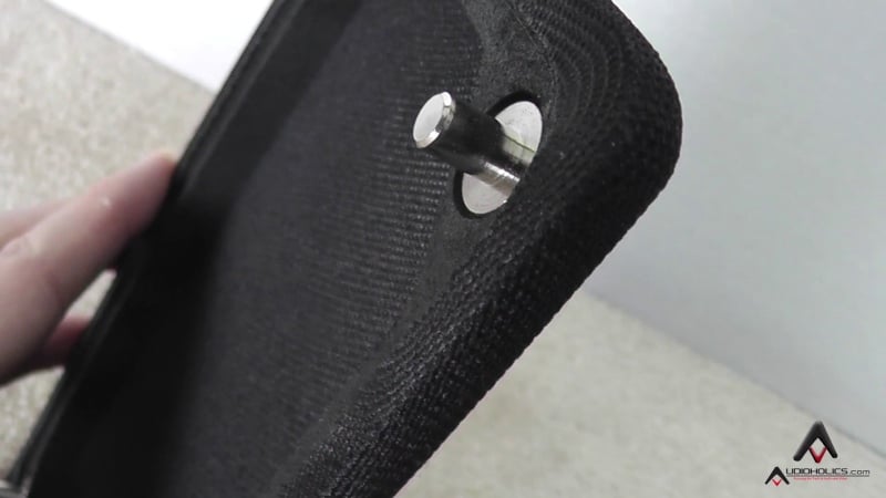

RBH MC-4C 1/4" Metal Grill Post
Many competitors offer flimsy plastic frames and posts on their grills. The RBH MC-4C speaker grills are cloth over MDF that sit flush with the front of the speakers and feature sturdy, metal posts ¼” thick. There is no chance these posts are going to break off, or even bend, and if manufacturers are going to use posts over magnetic grills, these metal posts should be the standard and show a continued focus of RBH on fit and finish. The selection of high-end components continues at the binding posts which are heavy-duty, all-metal 5-ways that are also flush-mounted. The crossover is a simple 6-component design that uses high-quality components.

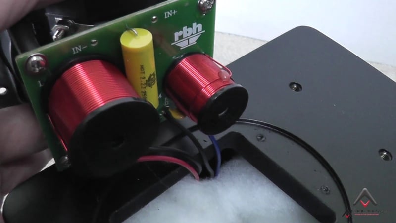

RBH MC-4C Crossover
Inset thread mounting points assure a sturdy connection when wall-mounting or fixing the MC-4C to stands. The RBH MC-4C are a sealed design so they have a more gradual low frequency roll-off than ported designs and, with no rear-port needing room to breathe, can be mounted as close as possible on a wall. That said, the crossover frequency between the speakers and the sub will still need to be fairly high. To be safe when picking a matching sub, look for one like the RBH S-12 that is flat up to 150 Hz. The crossover choices provided by my AVR were 120, 160, and 200Hz. I found a crossover frequency of 160 provided the most seamless blend to my subwoofer. You might also consider purchasing two small subs, placing them in close proximity to the left and right speakers, and running them in stereo. This would give you full-frequency range response in a compact package while accommodating a higher crossover point, smoothing out low frequency response, and giving you the best stereo separation at high-bass frequencies.

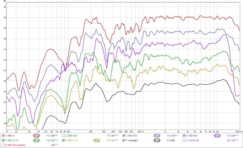

RBH MC-4C Measurements and Analysis
The graph below shows the frequency response of the RBH MC-4C HD on-axis (red), 15 (blue) and 30 (purple) degrees off-axis horizontally, 15 degrees off-axis above (green) and below (yellow) the tweeter, and an average of these responses (black) at 1 meter, smoothed 1/12 of an octave, and offset for easier viewing. All measurements were taken in room, so keep in mind that the low-frequency response is affected by room modes.
RBH MC-4C In-room Frequency Response (1 meter measurements, 1/12th octave smoothed)
on-axis (red); 15 (blue) and
Notice the exceptionally flat response from 1k upward. The accuracy of these speakers, even
off-axis, is really impressive. The speakers
were placed on 24” stands, so the distance between the woofer/mic and the floor
is roughly the same as the wavelength of the 300-400hz suck-out, thus, this measurement
anomaly due to floor bounce should be ignored.
The only issue is the step drop in the last half-octave at 30 degrees or
more. For those of us that can still
hear 15kHz and above (watch your volume levels and get a nice set of earplugs
people), this might translate into a little less “air” in the high frequencies
throughout the room. Compensate by using
a moderate amount of toe-in.

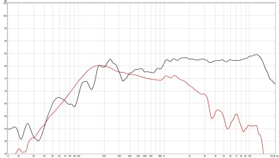

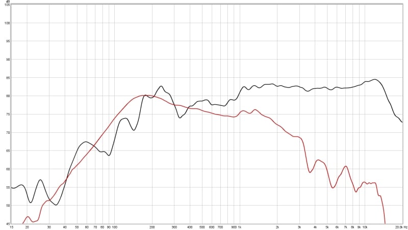

Here is the average response (black) spliced at 300Hz with a
near-field woofer (red) measurement for a more accurate picture of the bass
response.
RBH MC-4C Listening Window Average (Black) and Wofer Near-field (Red)

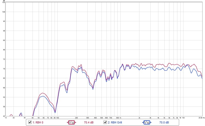

All previous measurements were taken with the grill off, while I did the vast majority of my listening with the grill on. In the graph below, you can see on-axis measurements with the grill on (blue) and off (red).
RBH MC-4C Grill On (Blue) and Off (Red)
