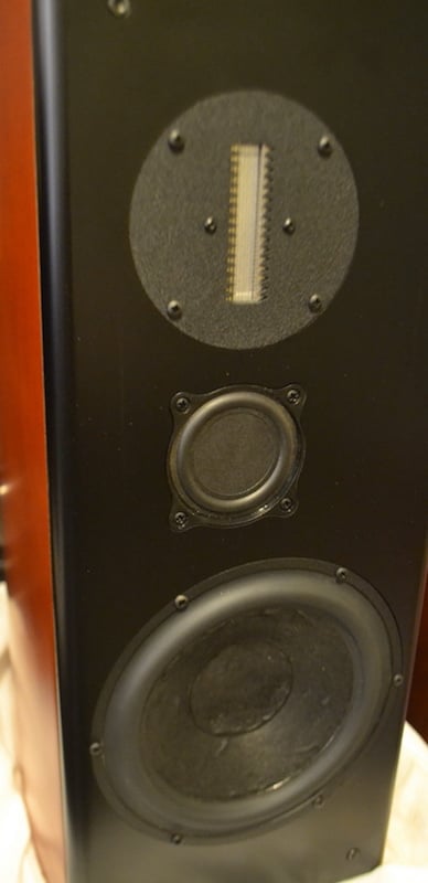

Audio is a small humble speaker manufacturer located in Maryland with a dedicated team of audiophiles, engineers, and music lovers. As the company name and logo display, Philharmonic Audio is superb in producing some of, if not, the most “musical” sounding speakers I have had the pleasure of experiencing. I was fortunate enough to correspond with Dennis Murphy and acquire a pair of his BMR Philharmonitor 3-way loudspeakers for an in-home audition. The crossover networks for all Philharmonic speakers were developed by Dennis Murphy, who has a proven track record in crossover designs for Salk Sound, Ellis Audio, and many popular public domain kits, such as the MBOW1 and CAOW1. Not only is Dennis one of the key designers of speakers at Philharmonic Audio, he is also the principal violinist in the Washington Philharmonic Orchestra and plays lead violin in two tango orchestras.

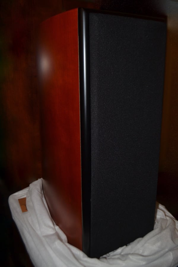

For $1,350/pair plus shipping you get these magnificent 3-way ported speakers which are 22" H x 9" W x 13.5" D and weigh in at 38lbs. ea. The pair used in this demo are the standard speakers with a pre-fab cabinet MTMC-0.75CH made by Dayton Audio and sold on the Parts Express website. The price/performance ratio compared to other speakers at the similar cost is phenomenal. Of course, you can always upgrade to cabinets made by Jim Salk that are $1600/pair and come with straight-sided cabinet walls and a slightly larger size. Furniture grade finishes are also available for $1800/pair. I was surprised how inert the model I had for this demo was when I performed the knuckle rap test and could only imagine how much more sturdy the Jim Salk cabinets would be by comparison!

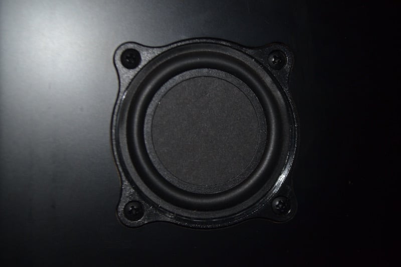

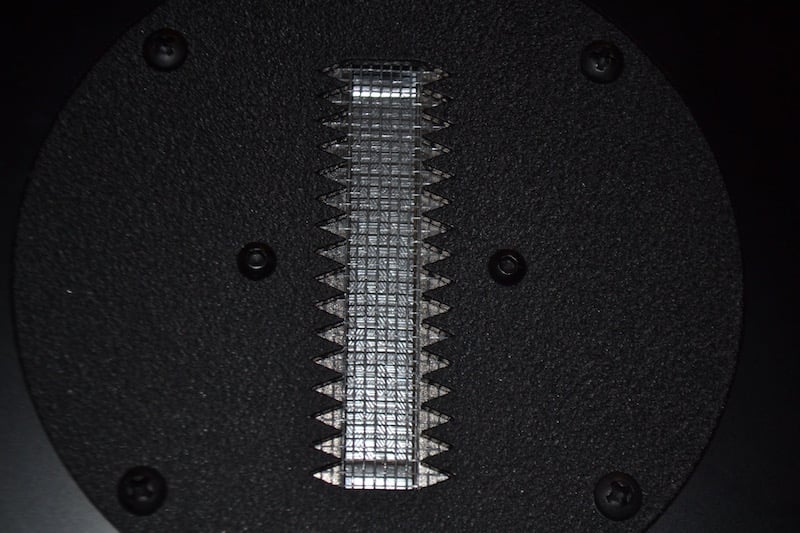

Despite the different finishes and cabinets, all models have a 64-10 OEM RAAL tweeter, a 2.5” Tectonic Balanced Mode Radiator (BMR) midrange driver, and the latest 7” Scan Speak 8545-01 woofer with a low damping SBR rubber surround and coated air dried paper/carbon fiber cone. This speaker has an anechoic frequency response of 30Hz-20kHz (+/- 2dB), a sensitivity of 84.5 dB at 2.83V/1m, and 6-ohm impedance. They also have a rear 2” heavily inner/outer flared port near the top of the cabinet. The speakers sport a pair of gold plated, knurled, five-way binding posts on the rear of the cabinet. The RAAL ribbon tweeter is the same that is used in Dennis’ New Philharmonitor. As explained on the Philharmonic Audio website, the BMR midrange driver, unlike many conventional radiator drivers, uses strategically placed weights in the diaphragm to counteract the mass of the voice coil at higher frequencies. It operates in two different bending wave motions in the higher frequencies and switches to a piston-like motion in the lower frequencies.
This BMR can be used as a midrange, tweeter or full range driver as seen in Cambridge Audio Minx Min 12. Dennis chose to use this unique driver as a midrange because he believes its strength is the upper midrange performance. After my audition, I believe he is right. Paul Kittinger optimized the bass response of the BMRs. He is also the one behind the transmission line optimization of the Salk Song Tower and Dennis’ flagship model, the Phil 3 tower speaker.

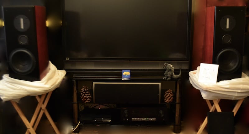

In my 1400cu. ft. media room, the BMRs wer
e set up on stands about 6’ apart. With Dennis’ recommendation, these speakers do not need to be toed-in and should be set up so that the tweeters and midrange in one speaker are closest to the drivers in its mirror image. The tweeters can be either at ear level or slightly above

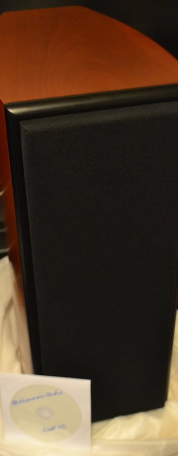

The speakers were delivered intact with a slight puncture on the side of one of the boxes. This proved ineffectual in damaging the speaker inside as the packing was superb with thick cardboard boxes on the outside with about 1” thick foam on the sides and some extra thick foam pieces protecting the corners, top, and bottom of both speakers. The speakers were then covered with white fabric bags to provide an extra layer of protection on the finish. The speaker grills, though magnetic, were attached to the cabinet with painter’s tape. The grills were also protected with a thin piece of cardboard as wide as the grill. These pieces of cardboard were also taped to the cabinet painters tape. The magnetic grills snap onto the front baffle at the spots of the four screws that secure the baffle to the rest of the cabinet. The RAAL tweeters were covered in a magnetic strip used to protect the ribbon from being damaged. These must be slid off slowly and carefully as to not disrupt the shape of the ribbon. Upon transport, they must be re-applied in the same manner. Dennis really took his time to prepare these speakers for the rigors of package delivery.

I have included some tracks from the hi-res demo CD that Dennis provided, some CD tracks from my personal collection, Pandora radio, and even some songs off FM radio to see how they performed with music from a variety of sources. These are phenomenal speakers and did not disappoint in the least with every music source I used. Like I have said about the tweeters in these speakers in my previous article on the Sierra Lunas, the RAAL tweeters are some of the best I have heard. They are very revealing in a positive way. No subwoofer was used during the listening tests since the Philharmonitor speakers are rated down to 30 Hz
