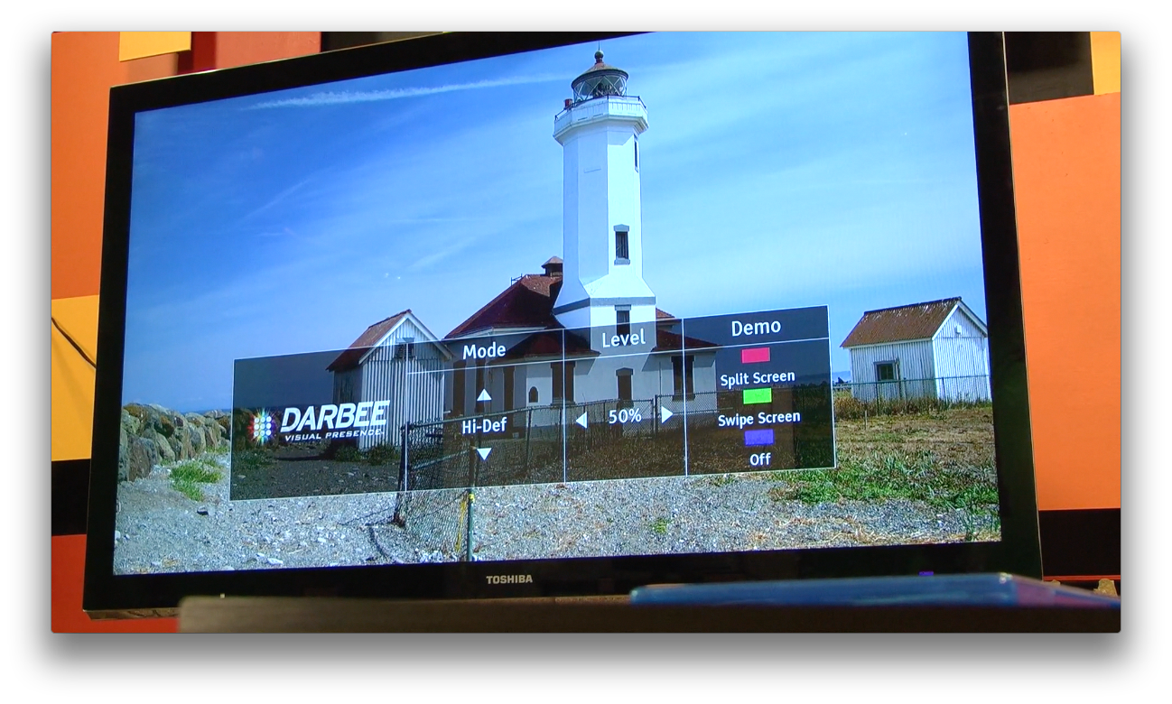

DVP isn't over-the-top—in fact, it may be difficult to see if you don't know what you're looking for. Fortunately, the Oppo BDP-103D gives you a button on the remote which lets you engage and test the various Darbee modes (there are three: Hi-Def, Gaming, and Full Pop). This menu also lets you adjust the level and engage the two demo modes.
I tried all three, and here are my thoughts: Hi-Def mode made for the most detailed improvements without causing unnecessary artifacts at lower levels. Gaming mode also worked well, but it seems to favor edge detail more and may not be the best for Blu-ray movies. Full Pop mode is designed for standard definition video, and it caused significant blurring of edges when it was turned up higher than 50%.
Overall, I'd have to say that Darbee Visual Presence creates a subtle depth not seen in any other type of processing I've encountered. It performed a natural contrast and edge enhancement that goes well beyond the simple perimeter pixel-based computations we've seen with other video processors. I think the maximum you want to set Darbee at for practical use is around 50%, though it loses all artifacting completely around 35%.

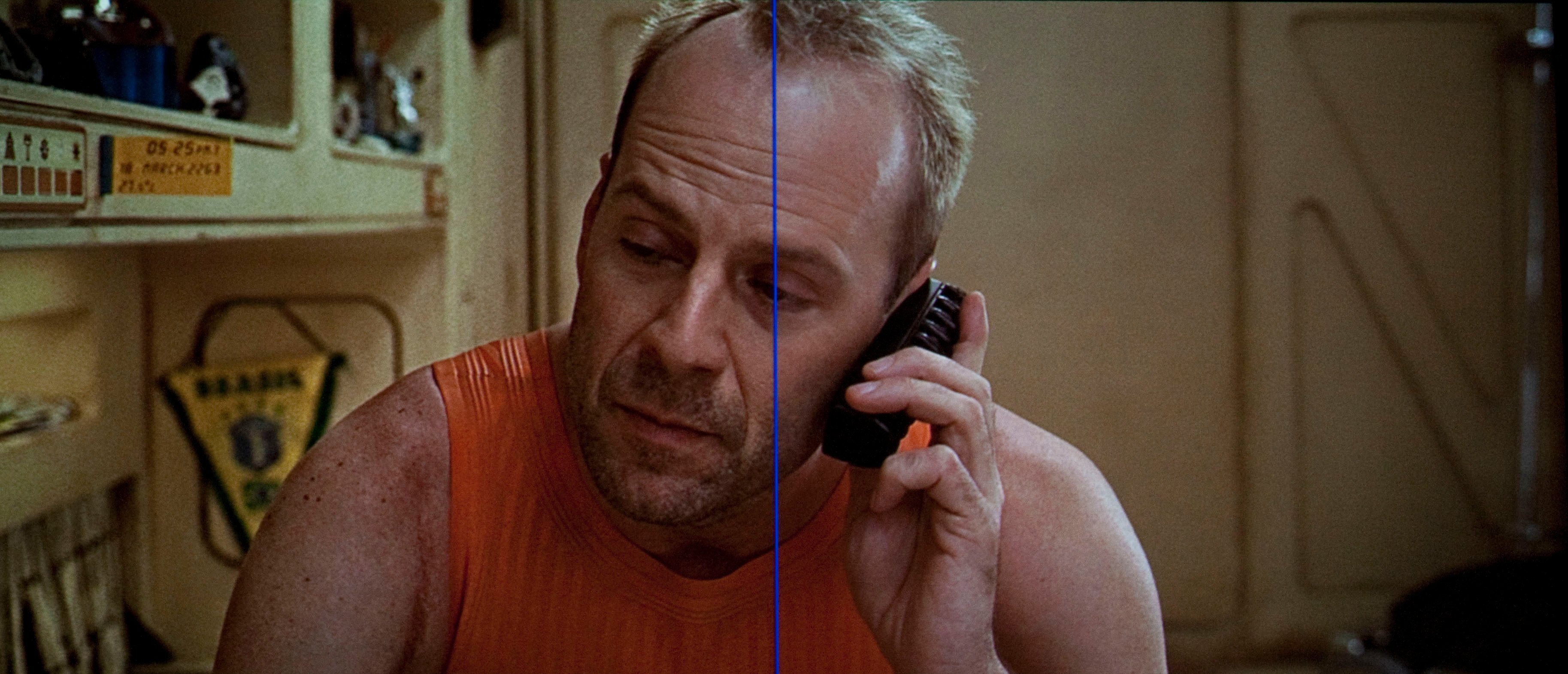

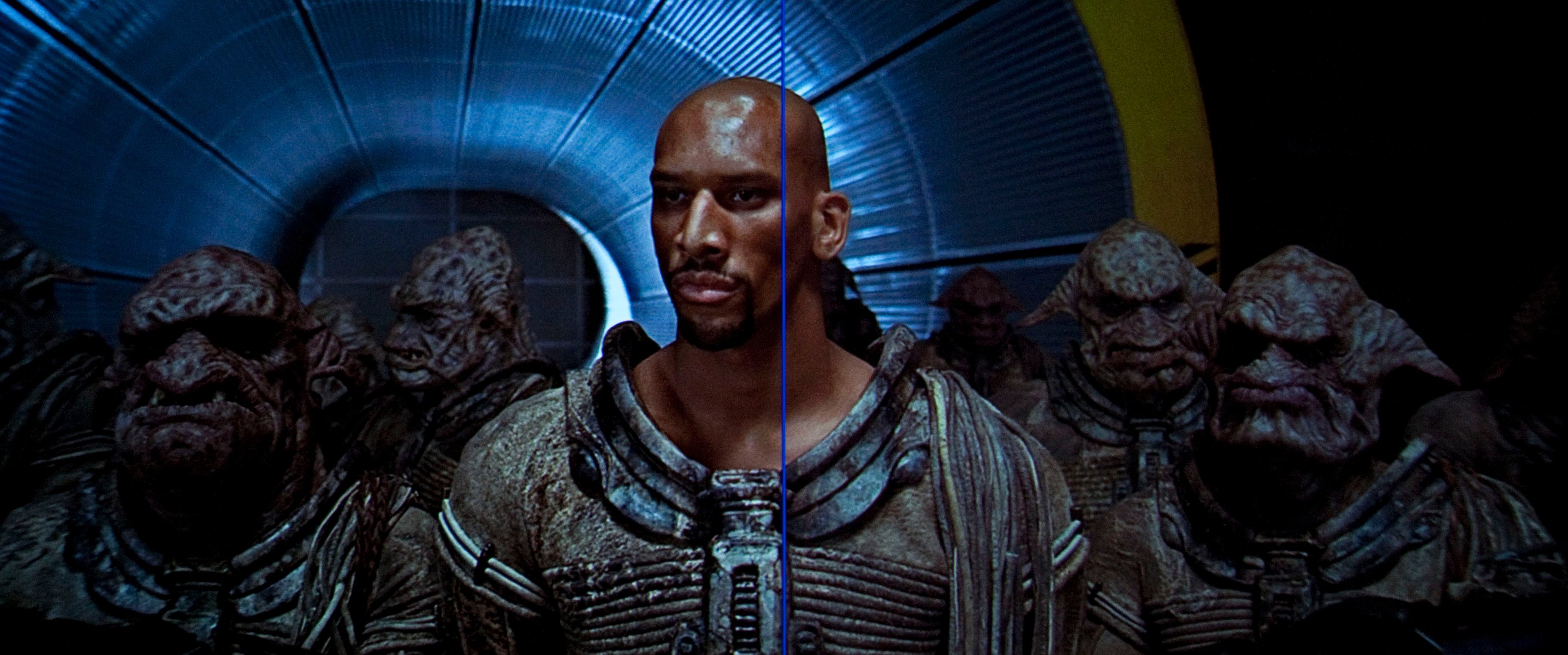

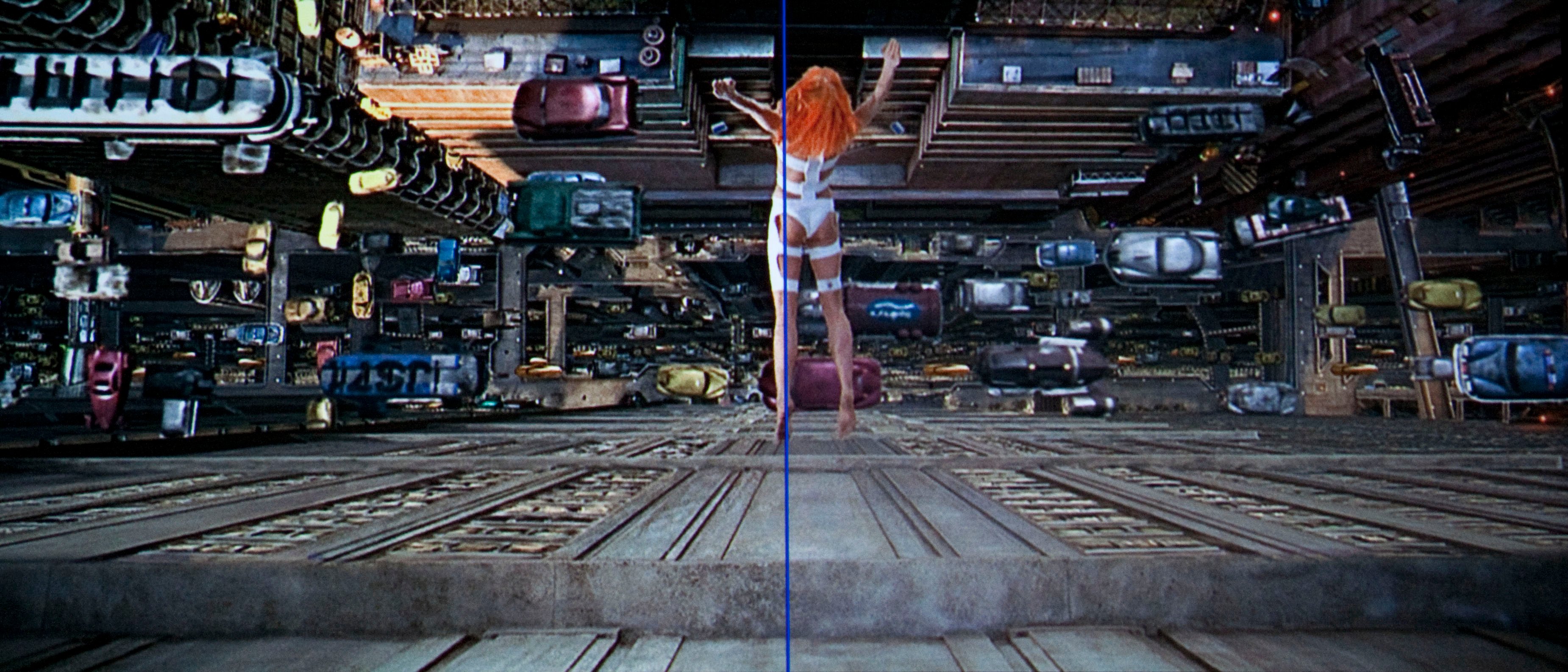

I played a lot of Blu-ray Disc source material on the BDP-103D, including the second edition of The Fifth Element, which finally got a transfer worthy of the title. Flipping back and forth between Darbee Visual Presence and standard processing, I found the DVP mode to add considerable life to the early scenes in the pyramid. Later, when we got to the big onboard ship battle featuring the Bangalors, I really felt the clothing, faces and environments were rendered with a whole lot more depth and richness. And the color never seemed to be affected at all, so this movie never lost its pop, and it never got overblown. For most of my viewing tests I kept the setting at around 35% to avoid unnecessary artifacting. You can blow up DVP pretty easily if you crank it up to its full 120%. It's like chocolate. I like it, but I don't want a swimming pool full of it, you know? Maxing out DVP will help you see the kind of effect it has on video, and you'll learn what to look for. But then you want to back it down to reduce noise and to reduce edge blurring and other artifacts that appear when it's set too high.
I also loved the demo scenes on the Spears & Munsil 2nd Edition test disc. I also ran this disc through the Oppo BDL-103D to see if Darbee had any negative effects on overall video processing. I didn't notice anything changing with respect to deinterlacing, luminance tests or color balance. But Speakers & Munsil also gave us some great test material. The scene in the lighthouse montage where there is a pebble beach area was particularly helpful in showing off the ability and enhancement of Darbee Visual Presence. Trees, grass, close up facial detail and any complex or contrasty areas of an image are the first to really pop with this processing technology. It's like good cheese—it just makes everything better.

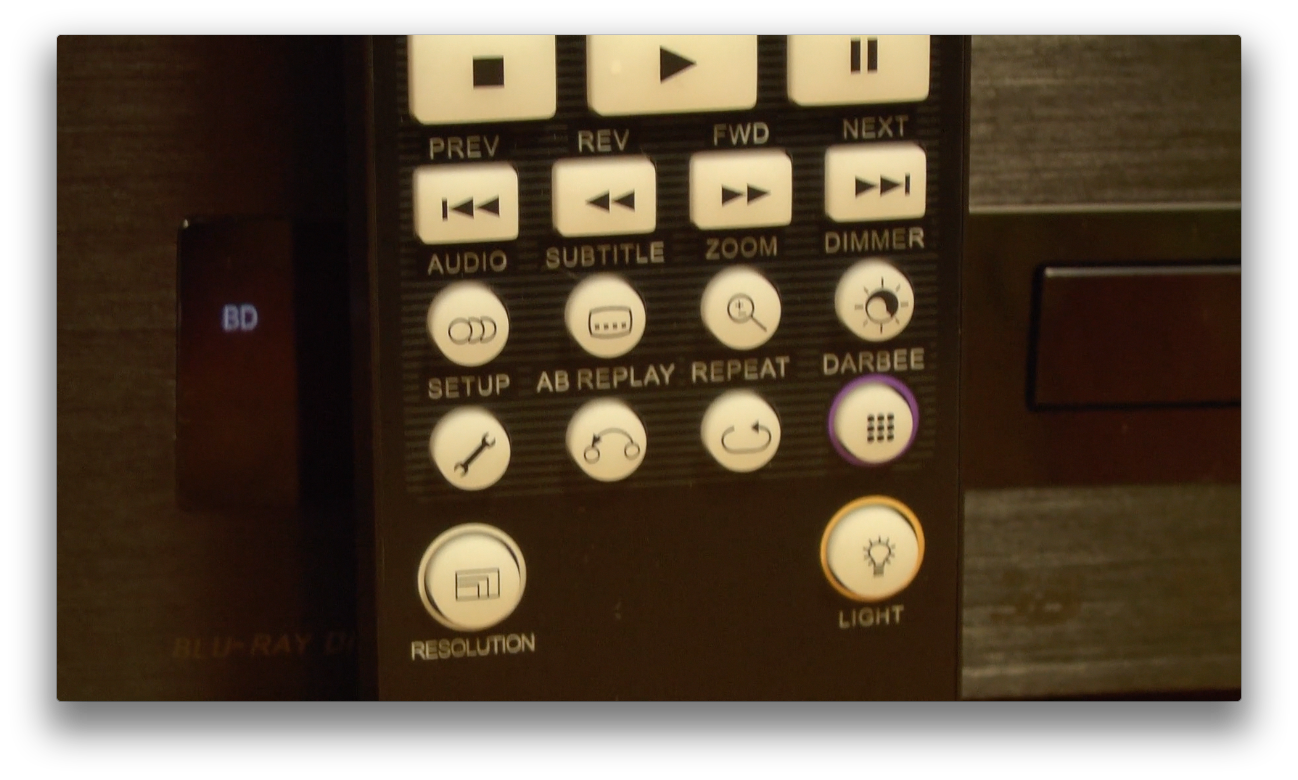

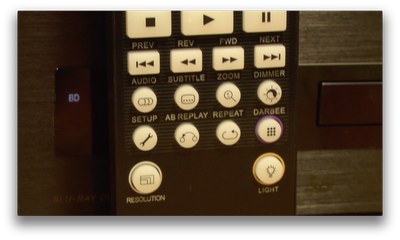

Look, I didn't go into much else about the player in this review for a reason. We've already reviewed the standard Oppo BDP-103 Universal Blu-ray Player—and you can check out that for benchmark scores and details about the player in general. There are a couple things I can note that differ between the last review and now. Oppo has added CinemaNow as well as Rhapsody streaming support. That's pretty cool. The remote was only slightly tweaked. There's now a red ring around the Home button, the largely unused "3D' button has been switched to the dimmer control, and the location previously occupied by the Dimmer button is now allocated to the Darbee Visual Presence settings.

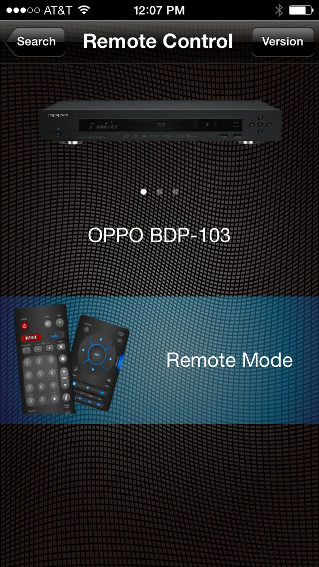

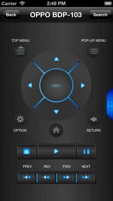

Oppo Remote App for iOS and Android

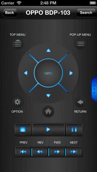

I also got to use the Oppo Remote app. It's a great little app and it recognized the Oppo BDP-103, BDP-103D and BDP-95 I had in my home. You can go into each player and use a simplified navigation remote interface, or access a full digital version of the complete remote control for access to every function. It's very handy as it works over Wi-Fi and can help you in the event that you IR-based or universal remote control system stops functioning.
