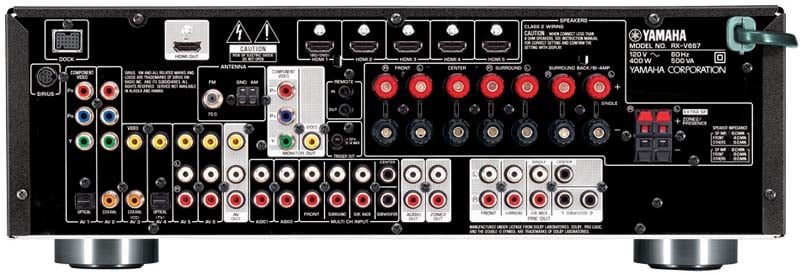

Yamaha RX-V667 Backpanel View
The Yamaha RX-V667 has a sexy rear end. The ergonomics are well thought out placing 5 of the 6 HDMI inputs at the top of the backpanel with the output offset to the left which can come in really handy for installers trying to troubleshoot HDMI issues without having to pull the receiver out of the rack to distinguish the HDMI output from the inputs. The 6th HDMI input is located on the front panel which is a very useful feature allowing easy access of HDMI pluggable devices. All of the speaker outputs sport binding posts except for the Zone2 outputs. The RX-V667 also sports dual paralleled subwoofer outputs for those connecting more than one subwoofer to their system. There are no S-video inputs or outputs which is a welcome omission we see receiver manufacturers making on many of their products this year. About the only minor gripe we have on the RX-V667 is the lack of a detachable power cord but we don't know of any receivers in this price class that offer this feature.
