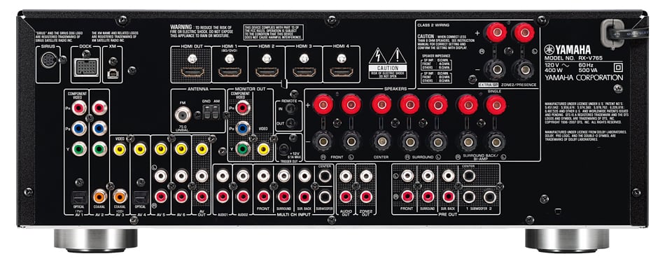

The RX-V765 has plenty of inputs and even iPod functionality - thanks to a multi-pin docking interface that works with the optional YDS-11 or YBA-10 iPod/iPhone docks. Four S/PDIF inputs (two coax and two optical) ensure ample connectivity for legacy DVD players, cable set top boxes and a gaming system, but you are really in for a treat should you make use of the 4 HDMI inputs. There is even a set of 7.1 analogue multi-channel inputs for those who are opposed to HDMI on principle (we know who you are!) A couple of parallel subwoofer preamp outputs means that you don't need a Y-cable in order to use two subs - which we recommend whenver possible for better and smoother bass response.

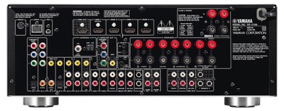

RX-V765 rear
Check out the larger chassis and 5-way binding posts for Zone2/Presence

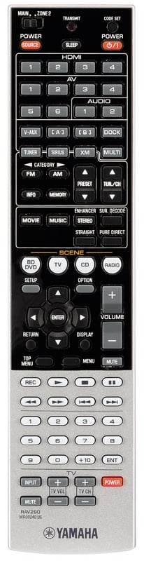

RX-V765 remoteThe remote for the RX-V765, like many of Yamaha's mid-level remote's, is capable of controlling the receiver and other components like your Blu-ray player and television. Yamaha is big on functionality in some areas, and light on others. For example, Zone 2 control is built in and operates easily, but all of the sources are numbered instead of labeled, making it very difficult to remember what input handles which device. The remote is also not backlit, making it difficult to use in a darkened room and there is no real control over cableTV set-top boxes - a major flaw of Yamaha's remotes for some time now. Still, it will do in a pinch and you'll be able to add TV control and manipulate the basic functions of almost any DVD or Blu-ray player. It is not a learning remote, so if it's not in the code set, you can't control it.
