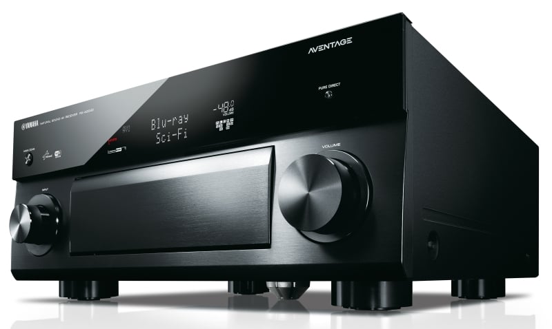

Yamaha’s RX-A2040 is a high-end AVR, second only to the top-of-the-line $2,200 RX-3040. A few prime differentiators between the two include the number of speaker posts (though both are 9-channel amps) and power per channel, which isn’t to say that the RX-A2040 is any kind of slouch. Featuring nine assignable channels and 155 watts of power with any two channels driven by a 1kHz signal into 8 ohms at 0.9% THD, the RX-A2040 stands toe-to-toe with competing receivers like the Denon AVR-X5200W which retails for $300 more than the Yamaha.
Yamaha RX-A2040
The RX-A2040 supports object-oriented Dolby Atmos, up to a 5.1.4 configuration, as well as Yamaha’s own “presence” speaker technology which incorporates height channels along the front and rear walls, instead of the ceiling, to create a 3-dimensional soundfield. All of these technologies promise a more immersive experience. We’ll have more about our listening experience using these playback modes later, and a full impression of Dolby Atmos in a separate article.

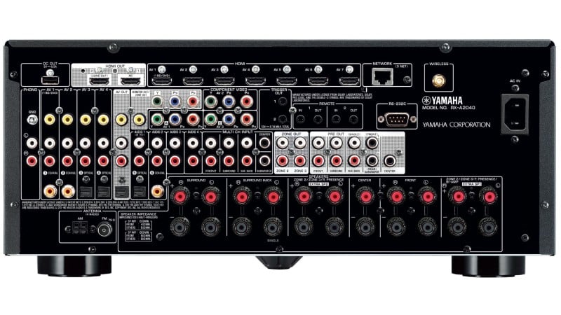

Those nine channels of amplification are mated with eight total HDMI 2.0 inputs and more digital audio and analog inputs than should be reasonably necessary in modern society, including 7.1 multichannel inputs and 7.2 outputs. Two HDMI outputs allow for up to two zones of video, and you can combine the built-in amplifiers with external amplifiers for up to two additional zones of audio only. Other custom-install features like 12v trigger outputs and RS-232C are included. In other words, 99% of people will never use all these features, but if you’re in that last 1% looking to use the RX-A2040 as the central brain of an elaborate whole-home audio system, it will likely meet your needs as well.
Yamaha RX-A2040 Rear
The RX-A2040 features the trademark Aventage 5th foot at the center of the chassis to help support the nearly 38lbs of bulk contained in its 17-1/8” x 7-1/2” x 18-3/8” (W x H x D) mass. Note the depth is over 18”, so if you’re looking to fit the RX-A2040 into an existing entertainment center, you’ll want to make sure you have the space. A brushed aluminum front panel features an attractive bevel that serves up simple physical controls. On that front panel, you have a power button, one large knob for selecting the input, one large knob for volume, a small “pure direct” button, and a smooth fold-down aluminum panel covering more advanced controls like four “scene” buttons that save specific inputs and surround modes for quick retrieval. After a little setup, any member of your family should be able to run the system with very minimal training, which is very welcome. Importantly, all key remote functions, including menu navigation, are available under the panel. If the remote is ever damaged or unavailable, you should be able to control every setup function from the unit itself.

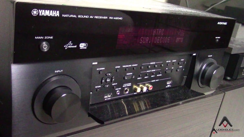

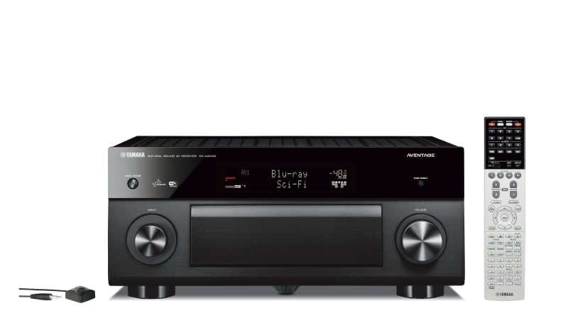

RX-A2040 Front Panel
Speaking of the remote, anyone who's watched my videos knows that I’m a remote-stickler. The RX-A2040 remote is perfectly on par with most every other remote included with AVRs these days, which is to say, it’s close to terrible. The Yamaha remote gets a solid “D” for cramming in many identically-sized buttons that will rarely see use. Even the larger, commonly used buttons like volume and D-pad are molded as separate, smaller buttons instead of a solid, rocker-style button which makes them more difficult to distinguish by touch alone. Whoever was in charge of the great front panel design should spend a week with the remote control division. I’m making a solemn vow: the first AVR manufacturer that wows me with their remote design and interface is getting sent homemade chocolate chip cookies. Good news: the bar is low.

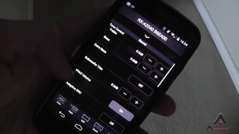

Yamaha also offers a web app that can be accessed through a web browser, and smartphone app that can be used to replace some remote functions. Here again, for all AVR manufacturers, there is much promise. There’s no excuse for on-screen keyboards when we all have a touchscreen in our pockets. It’s also much easier to swipe and touch through setup menus on a phone than navigate through multiple levels in a clunky on-screen menu.
Yamaha Remote Phone App
Yamaha’s smartphone app is beautifully graphic, had no connection problems, offers simple navigation of inputs and sound modes, allows some control of features like subwoofer trim and dynamic range control, and offers very usable control over the 4 zones. However, there are still some warts. Renaming inputs on the smartphone app only impacts the smartphone display, not the display on the AVR itself. On the Android app, there is a “3-dot” menu key in the lower right that doesn’t do anything. It’s far too easy to accidentally switch to the internet radio mode, and the “surround decoder” doesn’t let you switch between modes like PLIIx Movie and Music; it only remembers the last surround mode that you selected. For a free add-on, it’s difficult to fault with Yamaha here, as everything they provide is a value-add. That said, the first AVR manufacturer that allows me to rename inputs on the AVR, set speaker crossover frequencies, and assign amp channels, all from a smartphone, also gets cookies.
Setup was straightforward with Yamaha’s on-screen menu walkthrough. I remember the tediousness of setting up my first AVR using only the dot-matrix display on the front of the box. The first-time I experienced an on-screen GUI, it was a revelation. Yamaha features a fantastically easy to navigate on-screen menu with common settings at the forefront, and less commonly accessed settings appropriately shelved deep in the GUI. That said, Yamaha may have taken the on-screen menu to far. Many times, the built-in display would simply read “View On Screen,” which isn’t particularly helpful when you’re trying to make a quick change without firing up your overhead projector. Even if navigating via the built-in display wasn’t completely intuitive, I’d like the on-screen menu objects to be mirrored on the front panel.

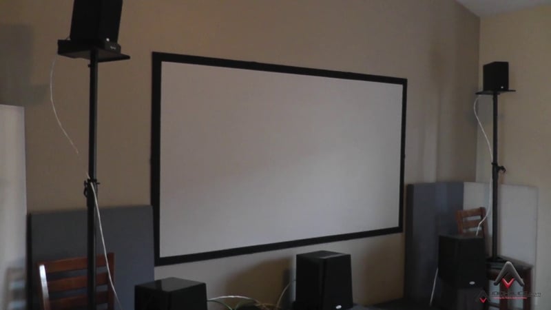

For Atmos listening, my main room has a vaulted ceiling with no back wall, so while I couldn’t adhere to either the recommended Dolby Atmos or Yamaha Presence speaker setups, I did put together a 5.1.4 setup using the very accurate RBH MC-4C speakers, a lot of Blue Jeans Cable speaker wire, and some 8’ speaker stands/bar stool combos.
Pseudo-Dolby Atmos Setup

With both the Yamaha and Atmos approach, using direct-firing height channels, I was impressed to the point that I’m now trying to figure out whether permanent height speakers could be in my future. The effect certainly made for a “taller” front soundstage and, though I think I would still switch it on/off to taste, felt it improved, at times, even non-Atmos video content.
In closing, I’m personally digging Atmos using direct-firing (aka. discrete) speakers. Yamaha was smart to include the Atmos technology via a free firmware upgrade in the RX-A2040, and for those who can easily add a few extra speakers, I found it to be worth the effort.

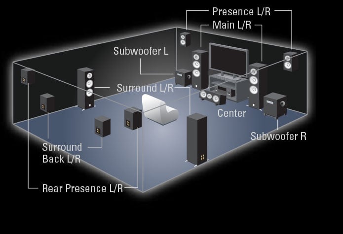

Yamaha Presence Recommended Speaker Setup
So I say to Yamaha: I know that years ago, there was little surround content and your experimentation with surround scenes was a fun way to play with those extra channels when our only sources were 2-channel. Now, at best, they’re goofy. This wouldn’t be so aggravating if these sound modes weren’t so prominently displayed. They are intermingled with actually useful surround modes like Dolby/DTS lossless and matrixed modes, and triggered via remote buttons that are the same size and shape as the most commonly used button, the volume button. Yamaha, this is an intervention; stop modeling the backseat of Elvis’ Cadillac and bathrooms in Vienna.
