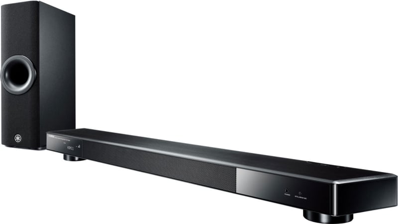

Yamaha YSP-2500 Soundbar
  • Product Name: YSP-2500
  • Manufacturer: Yamaha
  • Review Date: November 21, 2014 08:00
  • MSRP: $ 999.95
Sound Bar:
  • HDMI: 3 in / 1 out
  • Optical: 2 in
  • Coaxial: 1 in
  • Analog Audio: 1 in
  • Headphone Jack: Yes
  • HD Audio Decoding: Yes
  • Bluetooth: Yes
  • Drivers: 16 x 1 1/8"
  • Rated Power: 27.2 W (1kHz, 1% THD, 4 Ohms)
  • Dimensions (WxHxD): 37 1/8" x 2 7/8" x 5 5/8" with feet
  • Weight: 8.8 lbs.
Subwoofer:
  • Wireless: Yes
  • Drivers: 2 x 4"
  • Rated Power: 75 W (100 Hz, 10% THD, 5 Ohms)
  • Dimensions (WxHxD): 5 3/4" x 17 1/2" x 13 7/8"
  • Weight: 17.4 lbs.
Total System Rated Frequency Response:  40-22k Hz (-10 dB)
  • Discrete surround sound from a single sound bar
  • Easy auto-setup with a user-friendly features
  • A more affordable version of Yamaha's YSP technology
  • Even at the middle of Yamaha's YSP product range, still more costly than most soundbars

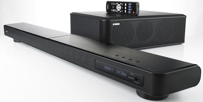

Yamaha YSP-2500
The Yamaha YSP-2500 Soundbar and Wireless Subwoofer

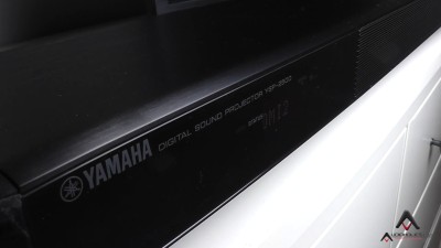

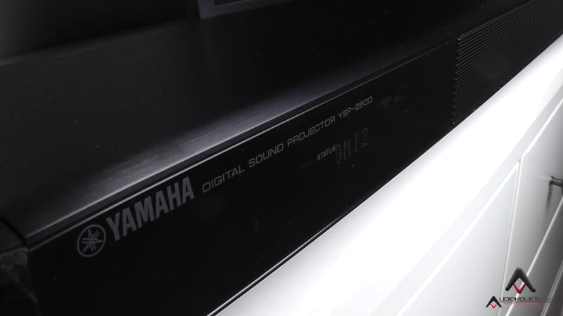

The YSP-2500’s main unit features a brushed aluminum cabinet for a high-end look, and measures 37-⅛” wide by 5-⅝” deep by 2-⅞” tall with the adjustable feet (2” without).  The unit weighs just shy of 9 pounds, and can be wall mounted with an optional bracket.  I personally think it would be a little gutsy to wall mount the YSP-2500, as the resulting fixture would appear rather shelf-like and become a potential resting spot for visitor’s drinks.  On the other hand, by the time you mount a display above it, the thickness of the TV mount and display should make the nearly 6” deep Yamaha seem less extruded.
Sixteen 1-⅛” drivers make up the main driver array, and they are driven by an amplifier that produces 27 watts at 4 ohms with 1% distortion and a 1kHz signal. Yamaha’s Sound Projector technology uses this array of small drivers to “beam” sound around the room, bouncing sound waves off the side walls to arrive at your ears from different angles.  This can create the illusion of sound coming from speakers to the sides and behind you, even without a traditional home theater setup and multiple speakers spread throughout the room.
Yamaha YSP-2500 Aluminum
The Yamaha YSP-2500 features a classy brushed aluminum finish.

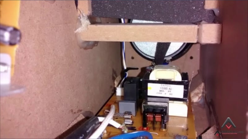

The included subwoofer is intended to sit in a horizontal or vertical configuration, and measures 5-¾” wide by 17-½” tall and 13-⅞” deep.  It weighs 17.4lbs, and connects simply and wirelessly, though a wired connection is also possible.  The subwoofer features a front-ported design, with two 4” drivers, and a 75 watt amp (5 ohms, 10% distortion, 100Hz signal).  The cabinet is constructed of ½” MDF with moderate bracing; given the small size and modest output, it remained sufficiently inert.  I was able to get a few spy shots by peeling back the amplifier plate and wiggling my cell phone inside, but I couldn’t completely dismantle the subwoofer for a more thorough inspection without fear of damaging the unit.
Yamaha YSP-2500 Subwoofer Internals
The Yamaha YSP-2500 Subwoofer internals.

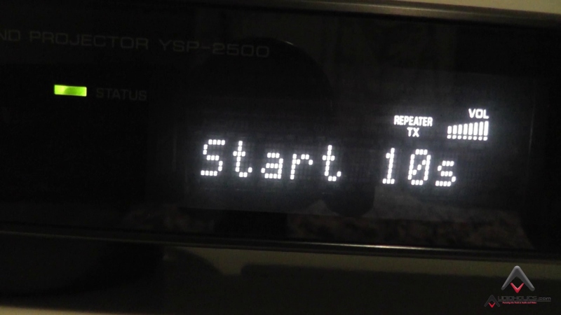

Setup was very simple.  I unboxed everything, provided power to the main unit and subwoofer, and turned the main unit on.  After a brief moment, the main unit and subwoofer discovered each other, wirelessly linked, and I was ready to playback full-range sound.  Optimizing the system was a simple as connecting the included mic to the front of the unit, setting it at head-position (using the included cardboard tripod if needed) and pressing enter to start the auto-setup routine.
One thing I really appreciate is that Yamaha’s auto-setup gives you 10 seconds after you start the routine before the test tones and measurements begin.  This allows you to leave the room, saving your ears from the grating tones, and preventing you from polluting the measured responses.  When it’s all done, the YSP-2500 plays a loud musical chime to let you know that it’s safe to return. This simple user convenience is much appreciated, and I’d love to see other auto-EQ developers implement a delay and start/finish chime.
Yamaha YSP-2500 Auto-Setup
The Yamaha YSP-2500 Auto-Setup features a 10-second start delay.

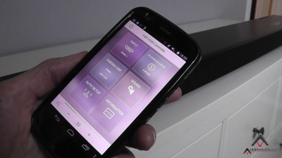

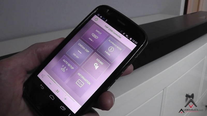

The physical remote is a little busy, but does a good job of assigning individual buttons to specific features to keep the user from having to dig around the menu system.  The volume controls are easy to find by touch alone. Yamaha has also authored a “Home Theater Controller” smartphone app which I tested on Android, though it’s also available for Apple products.  I found this to be one of the better smartphone controller apps that I’ve tried.  A simple start page consists of 6 tiles that are easy to trigger, intuitive, and don’t send you multiple levels deep before you find the function that you’re looking for.  This is the first app I’ve used that could have me permanently mothballing the physical remote.
Yamaha Home Theater Controller App
The Yamaha Home Theater Controller App is well-designed and available for Android and Apple.

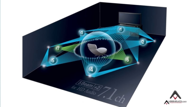

In surround mode, the Yamaha fires up its beaming feature to not only replicate side and rear speakers, but also widen the front soundstage.  For instance, in my setup, sending a signal to just the left channel produced a distinct image about halfway between the main unit and the wall itself.  The right channel was also widened, but as I had a wall opening at the right rear, was more diffused and not as distinct.  In a fully closed room, this should not be an issue.  Rear channels were reproduced in a way that varied from diffused to more directional, but definitely didn’t seem like they were coming from the front of the room.  Yamaha again proved that they have one of the best pseudo-surround technologies when it comes to the most authentic aping of a traditional surround system. This was displayed in the numerous crowded office scenes inThe Wolf of Wall Street where the cacophony of the chaotic office environments is nicely translated.
Yamaha YSP-2500 Digital Sound Projector Technology
The Yamaha YSP-2500 Digital Sound Projector technology "bounces" sound off walls, replicating discrete surround speakers.
