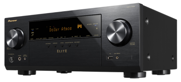

We recently reviewed Onkyo’s newest receiver the TX-SR383 7.2-Channel AV Receiver with mixed enthusiasm. With a $400 price point, the TX-SR383 does have some really great features, but with the lack of Dolby Atmos or DTS:X, it might shy some people away. Similarly, Pioneer released their newest receiver recently, the VSX-LX103 and being Audioholics we have to call Pioneer out on their flaws. Since Onkyo bought Pioneer’s Home Theater Entertainment section a few years ago we figured we would see a similar receiver come out. For $499 you DO get Dolby Atmos and DTS:X in the Pioneer VSX-LX103 as well as all the video bells and whistles that we liked about the Onkyo TX-SR383. You also get 170 watts of pure raw unadulterated power!
Wait. What is the fine print here?
(6 Ohm - at 1 kHz - THD 10% - 1 channels)
It looks as though parent company Onkyo is rubbing off on Pioneer by artificially and erroneously inflating the power ratings just like the Onkyo TX-SR383. Further reading shows that the power rating for 2 channels is actually 80 watts (8 Ohm - 20 - 20000 kHz - THD 0.08%)! So now we have receiver companies more than doubling the power ratings of the unclipped full bandwidth power.
For more information on The A/V Receiver Power Ratings game, you can watch our Youtube video on the subject to make sure you’re getting what you think you’re buying.

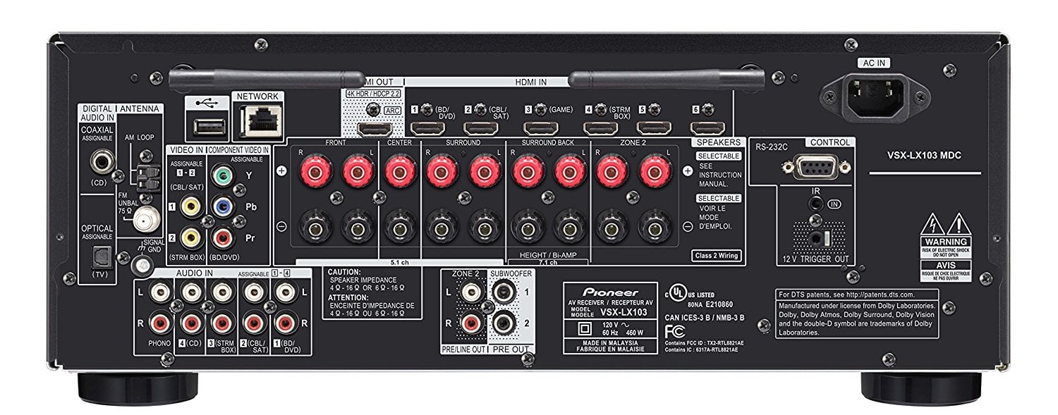

But the VSX-LX103 does have many great features for a $600 receiver including 5.2.2 channel surround sound with Dolby Atmos and DTS:X, and Powered Zone 2 outputs to enjoy audio from speakers in another room.
It also features 6 HDMI In / 1 Out and supports Ultra HD pass-through with HDCP 2.2, 4K / 60 Hz, Dolby Vision, HDR10, HLG (Hybrid Log-Gamma), WCG (Wide Color Gamut) and Ultra HD upscaling (1080p to 4K).
Pioneer receivers do have one of the easiest setups on the market and their Multi-Channel Acoustic Calibration System (MCACC) helps create a better acoustic environment via the receiver’s custom microphone so that the system automatically compensates for differences in speaker size, level and distance, and equalizes the response.
Additionally, Pioneer’s onboard Phase Control compensates for phase lag between the subwoofer and the main channel speakers by improving sound synchronization to achieve a clearer reproduction of sound in the middle and high-frequency bands.
