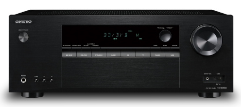

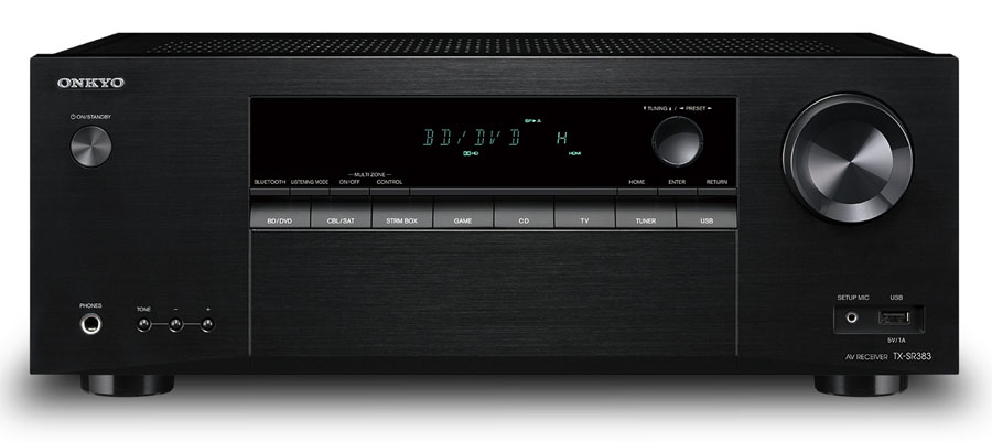

Onkyo TX-SR383 AV Receiver

I was recently asked by a budget minded customer if I could recommend a Home Theater in a Box in the $400 range for his new home. Since I knew the home already had speakers built into the walls I highly recommended checking out some of the base model Onkyo receivers, and with money left over, for an inexpensive sub from Monoprice.  Had I known that Onkyo was releasing a discrete high current 7.2 channel receiver for $400, the decision might have been a little harder. The TX-SR383 from Onkyo provides a choice of native 7.2-channel soundtrack reproduction or a 5.2-channel surround-sound layout with powered audio distribution to a pair of stereo speakers in Zone 2.

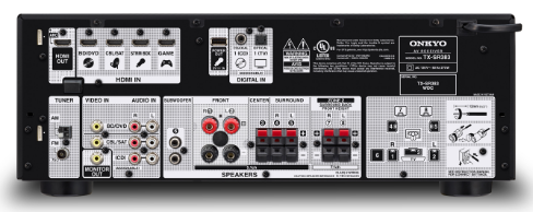

On the video side, we liked the four HDMI inputs and one output supporting 4K/60p, HDR10, HLG (Hybrid Log-Gamma), 4:4:4 color space, and BT.2020 color-standard video pass-through as well as HDCP 2.2.  The CEC-compliant HDMI output also has an ARC (Audio Return Channel) to enable amplification of TV broadcasts from ARC-ready displays.  In addition, HDMI pass-through is available when amplified sound is not required.
