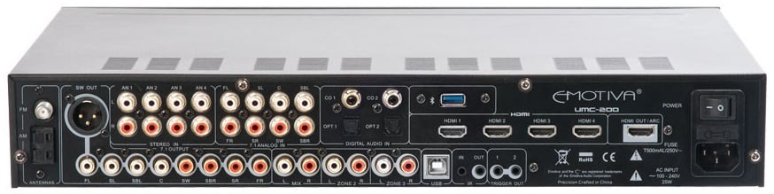

The Emotiva UMC-200 is a 7.1 channel processor with four HDMI inputs and one output with ARC (Audio Return Channel). It has two coaxial and two optical digital audio inputs and four pairs of RCA style analogue audio inputs. It has RCA style connection for your external amplifier for all 7.1 channels plus an additional XLR output for your subwoofer. There are also a pair of RCA outputs labeled "Mix" for combining surround sound into stereo. Zone 2 and Zone 3 RCA outputs are also available. We're surprised the lack of RS-232 support with the mulizone capabilities (but you can always upgrade to a higher level product for that). Lastly, there are inputs for terrestrial AM/FM radio and the front has a 3.5mm headphone jack.
umc200_rear
For legacy gear, Emotvia has included 7.1 channel analogue audio inputs. There is a USB input on the back but it only accepts the Emotiva Bluetooth dongle (a trade-off there, but one that would have certainly raised the price). There is one 12 volt trigger input and two outputs as well as a single IR input and output. Not included is any sort of analogue input or output. This means the UMC-200 supports only HDMI, a factor ruling this product out for those that still have gear with analogue connections.

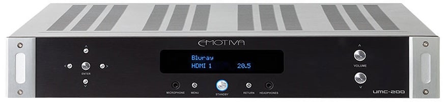

Emotiva has included their Advanced Emo-Q Gen2 automatic multi-channel room correction and loudspeaker setup with a microphone. For those who are into manual calibration and tweaking, Emotiva has included eleven user-programmable, fully parametric, equalizers per channel. There is also storage for three different configurations for power users. You get a full color onscreen display over live video as well as the two line LED screen on the front of the unit. The UMC-200 is 17” wide by 14” deep by only 3-1/4” tall and weighs 10 pounds.
