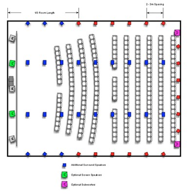

Essentially, Dolby Atmos provides more discrete channels, not just for the surrounds, but now for height channels as well, to create a more precise and immersive theatrical experience. We’ve already heard and written about a few demos of Atmos in action for movies like The Hobbit and Gravity at a local Cineplex. Our initial impressions were positive, though I felt the height channels were overdone similar to how the surround channels used to be goosed up during the early days of Dolby Digital and DTS.
Speaker Layout Diagram for Dolby Atmos Theater
We have quite a few questions about how Dolby plans to pull this off. How do they plan on scaling a 64 speaker technology into a 9 or 11 speaker format in a home theater environment? Are consumers willing to add more speakers, amplifier channels, and cabling to their existing home theaters? Will consumers have to reposition or replace back channels in favor of height channels? Below we bring even more questions and offer up some answers in hopes of starting a conversation about this to see what people think.
