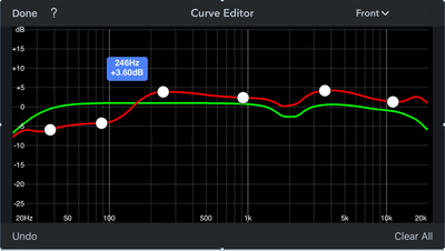

Audyssey Curve Edit
Audyssey EQ Editor App - screenshot taking from mobile device
This is done via the new Audyssey MultEQ Editor app which allows end users to go ‘under the hood’ to view and adjust the settings made by the automatic set-up. They can take full control of every aspect of the configuration, allowing detailed tuning and customization of the sound. That means users can adjust the performance more precisely to cope with any specific problems in their room, and tailor the surround experience to their personal preferences. With this comprehensive app and some of Denon and Marantz’s latest receivers, home cinema enthusiasts can at last not just harness the incredible power of Audyssey MultEQ to simplify the set-up of their home theater, but take total control of the way their home cinema sounds.

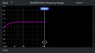

Audyssey Curve Edit 2

  • Adjust the overall EQ frequency roll-off for each channel pair
  • Switch between two high-frequency roll-off target curves
