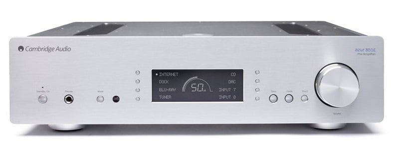

Azur 851E Stereo Preamp
Cambridge Audio’s line on the Azur 851E preamp is that it delivers so little harmonic distortion and noise to the signal, they can barely measure it. As you might guess, rated THD is vanishingly low at <0.00045% at 1kHz, while the unweighted SNR is rated <110dBr, <90dBu. The 851E also puts out excellent numbers in terms of crosstalk, rated at >110dB at 1kHz, and frequency response, specified at 10Hz-100kHz ±0.1dB. Output capabilities are also substantial for a preamplifier, stated to be 8V RMS via unbalanced RCA outputs, and 8V+8V RMS from the balanced XLR jacks; for those keeping track, this is more than adequate to drive any power amplifier on the market to full power.
In terms of connectivity, the 851E is an analog only creature. A total of eight pairs of analog inputs are provided, three of which can utilize balanced XLR connections. As implied earlier, pre-outs include unbalanced RCA and balanced XLR jacks, and a subwoofer output is also provided. The 851E does offer some semblance of bass management, with the option to apply a 12dB/octave filter at 200Hz; unfortunately, this is a bit too high in frequency to be of much use. Typically, subwoofers are crossed over around the 80Hz mark using a steep 24dB/octave filter to minimize the possibility of localization.

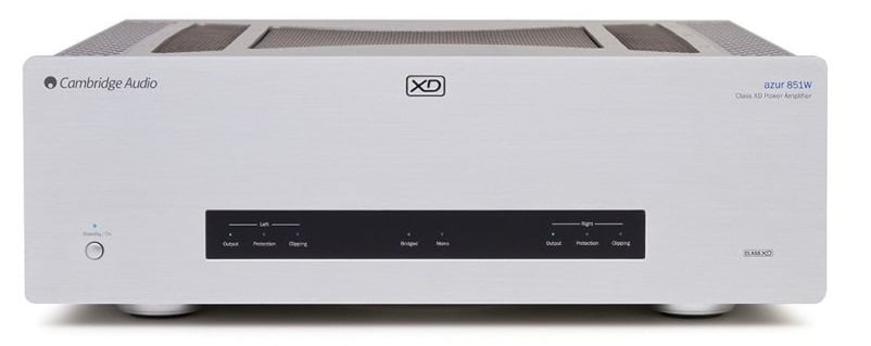

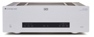

Azur 851W Stereo Power Amp
Looking to the brawn of the operation we find the Azur 851W, a two channel amplifier capable of delivering 200W into an 8 ohm load (500W bridged), 350W into 4 ohms (800W bridged). The first thing one is likely to note about the 851W is that it’s touted to be a “Class XD amplifier”, which Cambridge claims to eliminate crossover distortion like a Class A amplifier while retaining the efficiency of Class A/B. While it sounds fancy, glancing at the literature it appears that “Class XD” is simply a good old fashioned Class A/B design which operates in pure Class A mode under low demand conditions.
In terms of rated performance, the 851W appears to be clean as a whistle, much like its preamplifier sibling. THD is rated at <0.005% from 20Hz-20kHz, with unweighted SNR specified at >90dB with 1W into an 8 ohm load. Frequency response is rated from 5Hz-80kHz, though no tolerance is provided, limiting the utility of the specification. Similarly, damping factor is rated at >110, but the spec is provided at 1kHz as opposed to a more useful range like 20Hz-500Hz. Last but not least, input sensitivity is rated at 1.5V RMS unbalanced / 1.5V + 1.5V RMS balanced, which as noted above, will be no problem for the 851E.
