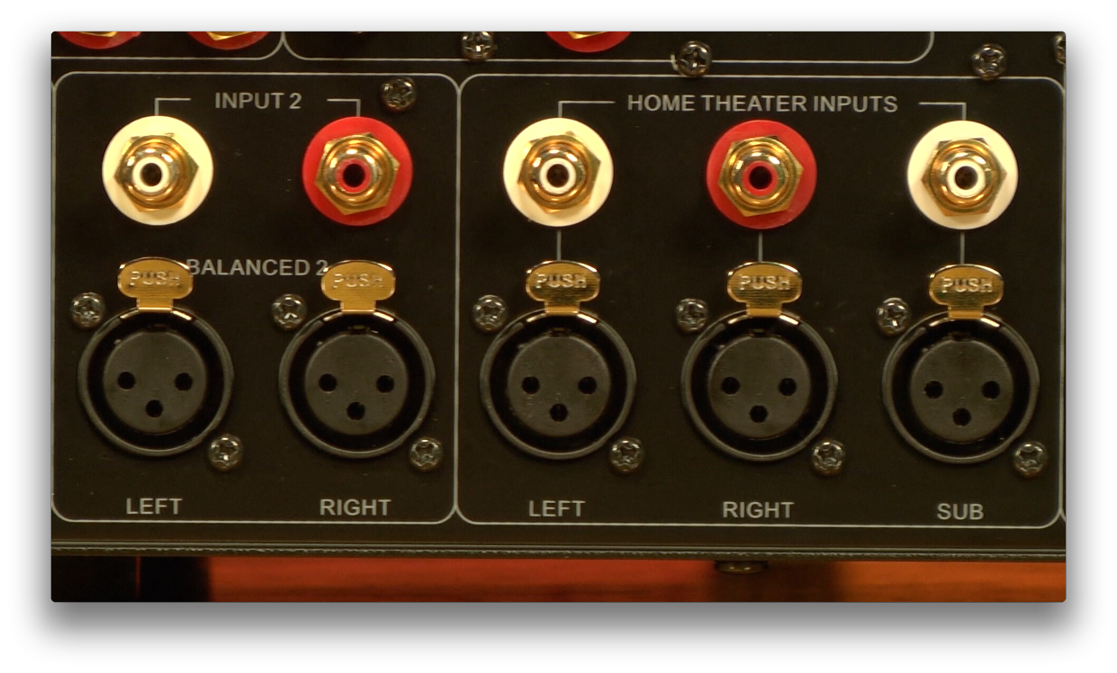

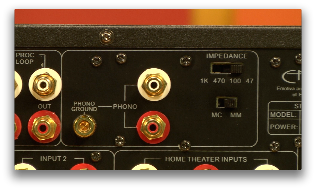

At less than $900 it's an amazing product just based on the signal flow itself...but that's just the first feature. Let's look at the connections...The XSP-1 has two sets of balanced (XLR) line inputs and one set of balanced outputs. Those inputs will take up to 6V so there's tons of headroom. It also has four sets of unbalanced (RCA) inputs and a stereo RCA output. If you spin vinyl, you'll appreciate that Emotiva included a high-end phono preamp with both moving magnet and moving coil settings and even adjustable input impedance for the MC mode. And we won't rehash it here, but check out Emotiva's website and you'll find over 120 pages of Audio Precision tests and measurements—Emotiva is being extremely transparent about this preamp. For headphone lovers, there is a high current headphone amplifier on board with its own volume control. In fact, the digitally-controlled analogue volume remembers settings independently for both the headphone and main outputs.

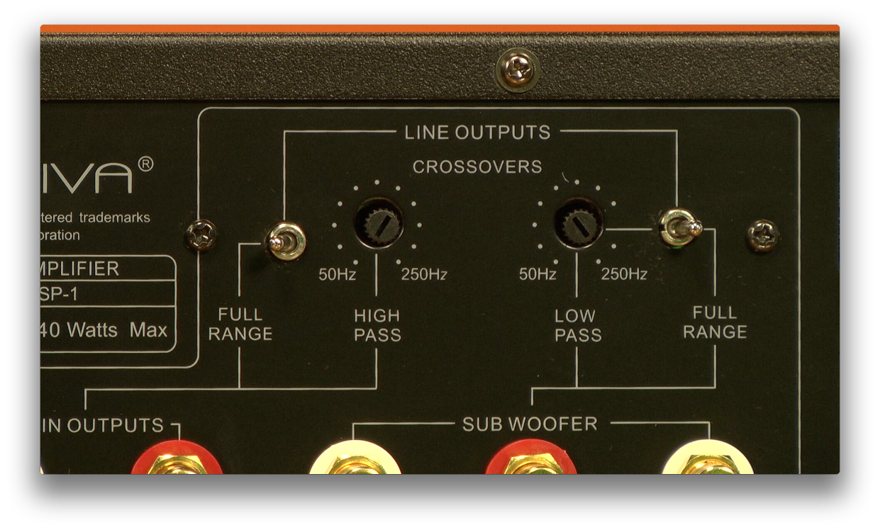

And the XSP-1 has something else that's very unique: dual stereo subwoofer outputs with full bass management. These can be routed stereo or summed. This is great for when you want to control bass management to a pair of stereo speakers in conjunction with a pair of stereo subs, or even if you have a full range system that you'd like more control over with respect to how the low frequencies are crossed over to the bass drivers.
Crossover duties are kept in the analogue domain with separate high pass controls for your mains and low pass for your sub(s). Bass management can also be completely bypassed. This gives you very precise control over how your sub and mains interact so that you can take the most advantage of their individual strengths. Usually, you set the crossover at a point and high and low pass filters are set by the device. Emotiva has recognized that people looking for a fully balanced product probably have speakers that don't fall into easy presets.
