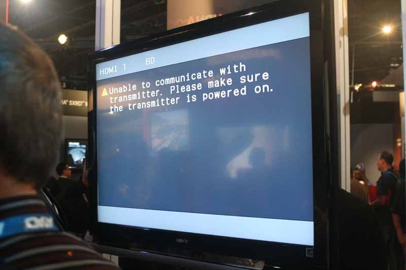

The first thing we discovered was that wireless HDMI is not cheap. Prices ranged from $800 to $1500. Of course you can easily spend that much on an esoteric HDMI "high-speed" cable. We are looking at the first generation of these products, however, so we can certainly expect those prices to drop over time. The real question is how well does it work. Well, honestly, we don’t know yet (there were some funny instances of displays showing failed connection attempts but with all the interference on the show floor it would be unfair to make a judgment based on that) but we are looking to set up reviews. Here are some of the products that you can expect to see on store shelves (virtual or real) in the coming months:

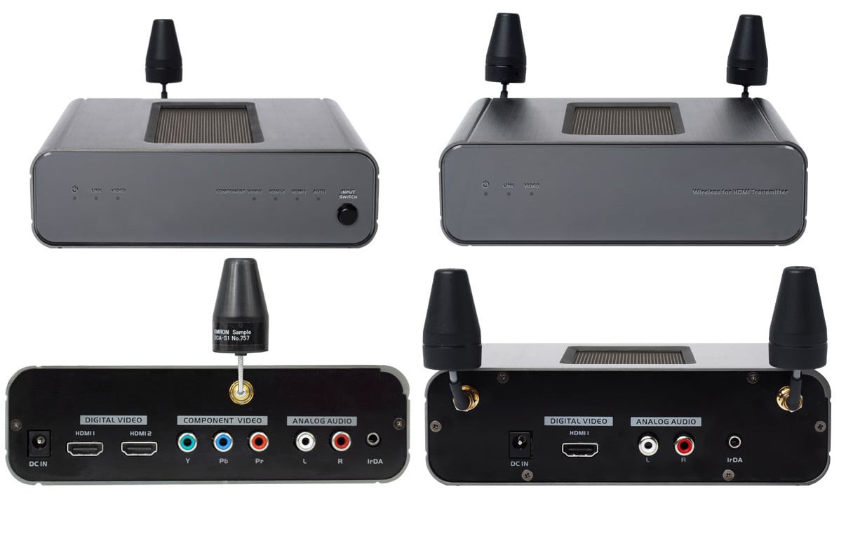

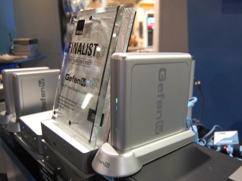

Gefen
Gefen had two different wireless solutions, one using TZero Technologies' UWB (Ultra Wideband) and another using your standard 802.11. The Gefen Wireless for HDMI Extender uses the UWB tech, operates on the 4-6 GHz frequency, and is good up to 10 meters. The rep said that they consider it an "in-room" solution so don't expect it to pipe video across your home - through the component cabinet is about as much as you can expect. According to the press release, it is good for up to 1080/24p, though the tech guy (who should know best) claimed 1080i. This probably means that it can technically do 1080/24p and not 1080/60p but in reality it will only do 1080i in most situations (since you need both a source and a display in order for 1080/24p to be usable). It also supports 5.1 multi-channel audio. It has 2 HDMI inputs, a component video input and analogue audio inputs. The component and analogue audio inputs are upconverted to HDMI (though not upscaled). The Gefen Wireless for HDMI Extender will be available this month for around $799.

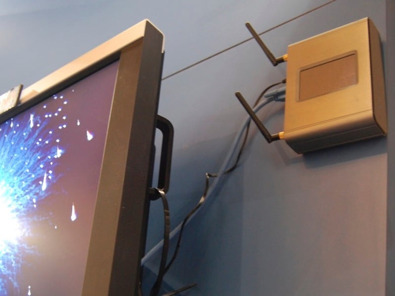

GefenThe GefenTV Wireless for HDMI Extender also comes in a two box solution. It utilizes an 802.11 signal on the 5GHz band to send HDMI information up to 30 meters. This solution is more suited to long runs through walls into other rooms. Once again, expect a 1080i max resolution along with uncompressed audio. This one retails for around $900 for the set and will be available in mid November.

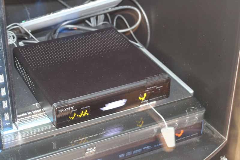

Sony
sony hdmiSony's solution was a little different in that it worked only with their own displays. The Sony Bravia Link works with their newest Bravia displays (the receiver is internal) and boasts 1080i (it does not upconvert - garbage in, garbage out). It has 4 HDMI inputs and a component input and comes with 5 IR emitters. Why does it need emitters? The remote is RF so it can control your gear via the emitters making it sort of a combo universal solution/wireless HDMI thingie. Of course, this probably assumes that the rest of your gear is also Sony but honestly, it probably is. For $799 all this can be yours. For more information, please visit Sony.

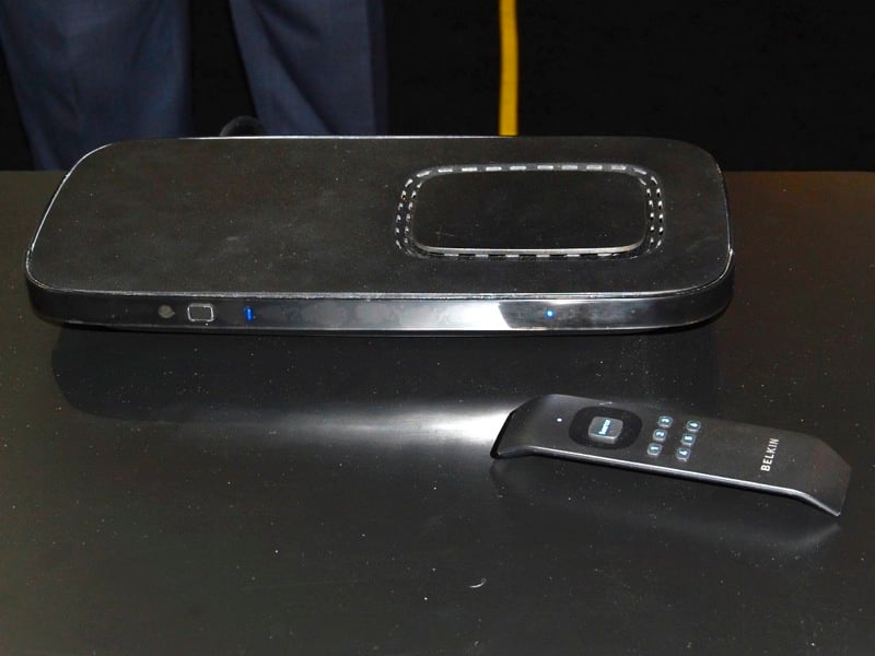

Belkin
Belkin flyBelkin, infinitely better at naming things than either of the above, showed off their FlyWire. This wireless solution has three HDMI inputs (one with analogue audio), two component with analogue audio, 1 composite with analogue audio, and one S-video input. It supports resolutions up to 1080/24p (which again is probably code for 1080i for most of us). It operates on 5GHz. It is IR controlled and will play nice with universal remotes. At $1499 you'll be looking at the highest priced solution with the most inputs and the longest range (100 feet).For more information, please visit Belkin.

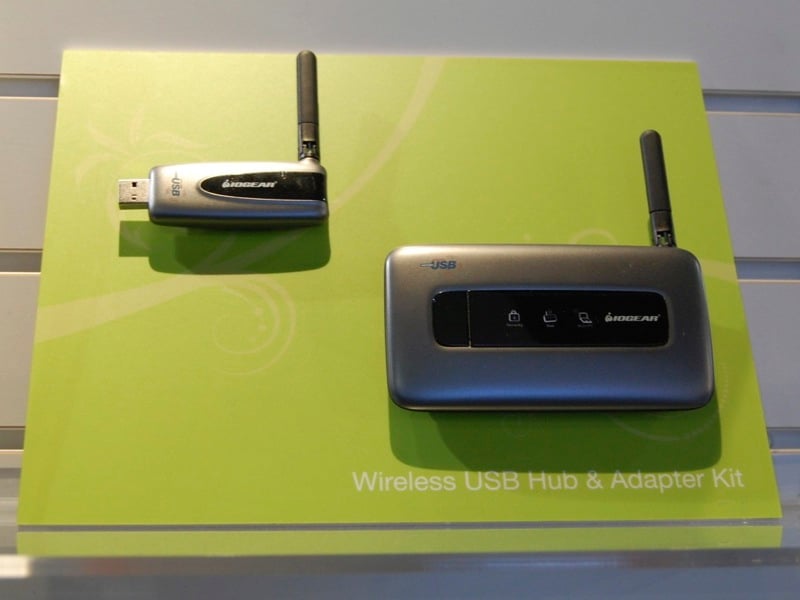

IOGear
I O GearWhile not technically an HDMI solution, the Wireless USB to VGA Kit from IOGear will stream up to 720p from your PC to a VGA monitor. The transmitter plugs into your USB port and sends it to a receiver up to 30 feet away (only 15 feet for 720p). Your display will have to support a VGA input and there is no provision for audio but it is pretty cool (especially for business or classroom use). It works with XP and Vista (as much as anything works with Vista) and requires a USB 2.0 port. It is available now for an MSRP of $229.95. For more information, please visit IOGear.
