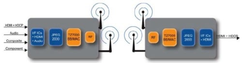

[ADV202] The wireless HDMI solution consists of a transmitter and receiver. It integrates the Tzero TZ 7000 chipset and Analog Devices' JPEG2000 compression ICs. On the transmit side, video data is compressed using Analog Devices' ADV202 JPEG2000 video codec, combined with audio, then packetized and encrypted, and transmitted via the Tzero MAC and PHY chip. The RF chip transmits over the air to the receiver where the audio/video data with HDMI is decompressed and presented to the display device via the HDMI port. Analog Devices' HDMI interface ICs and audio processors complete the design, ensuring the highest quality audio/visual experience.
