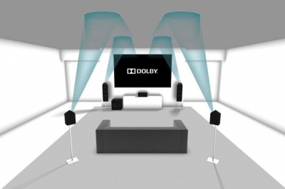

4) Aimable Speakers
Getting people to put speakers in their ceiling is a risky bet (to say the least) so the idea of a speaker to bounce sound of the ceiling is a good idea. However, it is clear to anyone with half a brain that top mounted speakers that are at a fixed angle are a terrible idea. Even with ideal placements, there are too many factors that can make them ineffective. Shorter than average ceilings, off-center seating, ceiling fans and other obstructions, variations in ceiling material, and more can all make it so that a fixed angle speaker isn't going to bounce the sound to the right location.
If we put aside what we know about the effectiveness of reflected sound and assume that they'll sound exactly like in-ceiling speakers, the problem is that there isn't a "standard" room. Getting the sound to bounce off the right part of the ceiling is critical. You're just not going to be able to do that with a fixed-angle top speaker for most installations.
The solution should be obvious: Allow the top speaker to be aimed. I envision a top speaker that is "floating" on top of a layer of foam (decoupling the top speaker from the bottom - an additional benefit) with some sort of adjustable front baffle. A fantastic design addition would be a laser pointer that fires from the front baffle to show you exactly where it hits on the ceiling.
We wrote about this before in our Dolby Atmos Steerable Speaker Proposal.

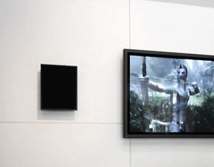

First, there needs to be a Dolby Atmos ceiling-mounted speaker. To me, an in-ceiling speaker is something reserved for new constructions. For all the rest of us that are trying to work within an existing room, being able to hang speakers from the ceiling is something that may actually be possible (if highly improbable). An "on-ceiling" speaker mounts to the ceiling like a wall-mounted speaker. Yes, there will need to be a wire running to it, but that is unavoidable barring the integration of a battery. Now, either that wire could run back to the receiver or perhaps it could run to a power source - I'm thinking either a nearby outlet or perhaps a light fixture.
Like these but on the ceiling

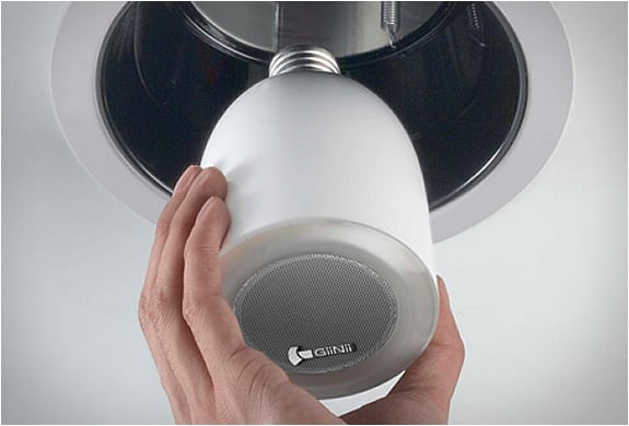

The second possible speaker solution is a "speaker light." We've seen these before and, honestly, they've gotten mixed reviews. The idea is that they screw into existing light fixtures and provide both light and sound. Sound quality generally seems to vary between "crappy" and "okay, I guess." The problem here would be that you'd need lights placed where those reflection points would be - an unlikely scenario. But, at least they'd get speakers above your head.
Like this but not crappy
