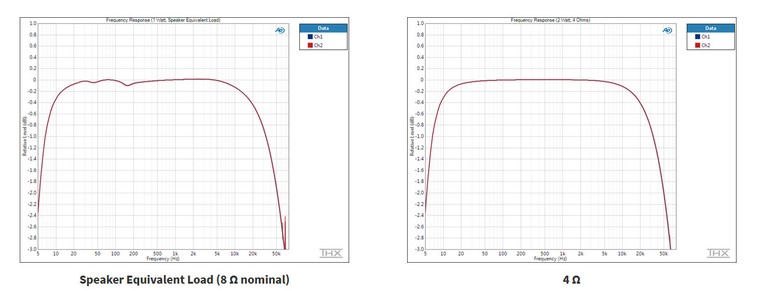

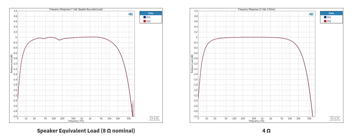

Emotiva Frequency Response
THX Frequency Response Measurement of Emotiva XPA-7 Gen3
I noticed some amplifiers in the THX comparisons achieve their 0.5dB requirement from 20Hz to 20kHz but still receive a lower score than others that also meet this requirement. The Emotiva XPA-Gen3 scored a 70 despite its meeting their frequency response criteria. In fact, it even had perfect channel-to-channel tracking, which surprisingly isn't even listed or discussed as an important metric in the THX test procedure!  The NAD M22, by comparison, showed a .6dB spike above 20kHz into 4 ohms and its channel-to-channel tracking wasn’t nearly as good as the Emotiva’s, yet it scored a 94 in this test.

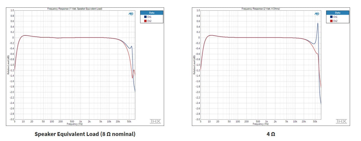

NAD M22 Frequency Response
THX Frequency Response Measurement of NAD M22
Taking a closer look at the NAD M22 frequency response revealed that either the THX test fixture is faulty or the Hypex NCore module inside the M22 has a hardware problem on channel 2 (more likely). You can see channel 2 at 8 ohms starts to rise again above 50kHz indicating there may very well be a problem with the output filter implementation for that channel. It may have been prudent for THX to have examined this result more closely in this case and either rejected the sample they tested or requested a new product from NAD to reaffirm their findings. If THX paid closer attention to channel-to-channel variance, this is something that may not have been overlooked. Close channel-to-channel tracking is a critical aspect of a good multi-channel amplifier design and something that most manufacturers pay meticulous attention to if they want to ensure consistent sound quality.
There doesn’t seem to be much rhyme or reason with THX score results based on their measured frequency response and how could they overlook channel-to-channel consistency?  It's unclear how THX is rewarding a score in this category as it certainly doesn't appear to be solely on meeting their frequency response requirement. If this is a comparison between products based on metrics, these scores require a rigorous standard. There should be a detailed description of the metric and weighting used to determine the score.

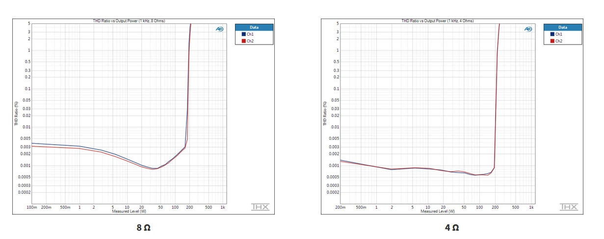

Monolith-7  Power
THX THD vs Output Power Measurement of Monoprice Monolith-7
It is quite puzzling how THX measured the Monolith-7 as having the same power (200 watts) into 8-ohm and 4-ohm loads while most of the other amps they tested delivered 1.5-2X the power into 4-ohm loads. Yet, somehow the Monolith-7 scored an 84 while the Emotiva XPA-7 Gen3 scored a 73 despite the Emotiva amp having delivered 2X its 8-ohm power into a 4-ohm load (500 watts) according to THX's own testing! Once again, we have no way of determining how THX derives their scoring for this category.

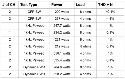

Monolith Power Table

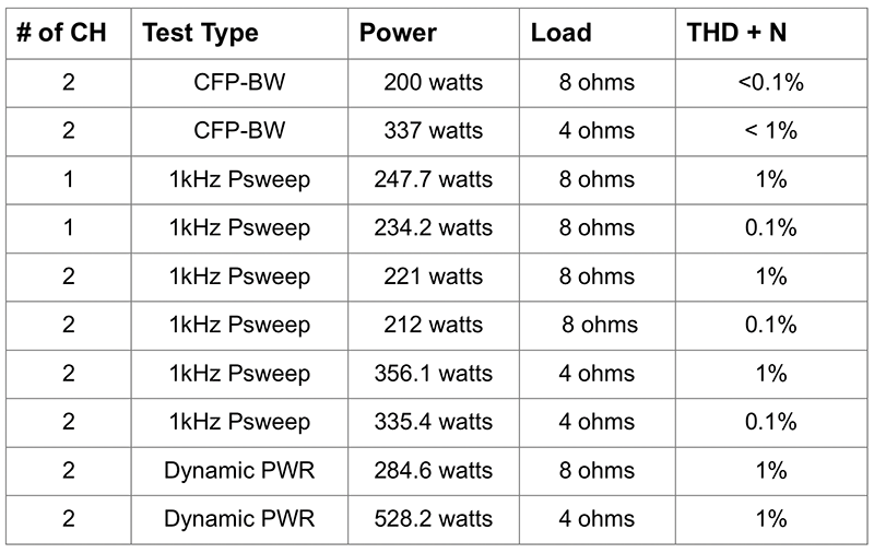

Audioholics Power Table Measurements of the Monolith-2 Amplifier
Our own tests of the Monoprice Monolith-2 revealed that amp was, in fact, able to deliver 1.6X the power into a 4-ohm load than it did into an 8-ohm load. You can see in our chart above that it delivered 212 watts/ch into 8 ohms and 335 watts/ch into 4 ohms (2CH driven, 1kHz, 0.1%  THD +N). Since ALL of the Monolith amps are based on the same design, THX clearly published inaccurate results and their score card doesn't reflect this.  Everyone makes errors from time to time, which is why it's always a good idea to have data comparisons like these peer reviewed for accuracy.

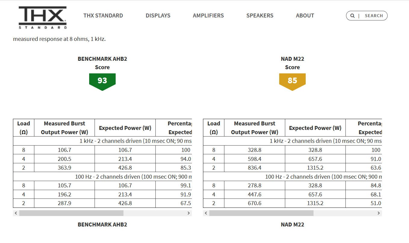

 Burst Test
THX Burst Test Measurement: Benchmark AHB2 vs NAD M22
In this comparison, we look at the Benchmark AHB2 vs the NAD M22.  The Benchmark amp wins the test because it had a narrower margin of expected vs. measured power yet ironically the NAD amplifier is far more powerful producing 1315 watts vs 426 watts at 1kHz, 2 ohms, which is almost a 5dB advantage. Dollar for dollar, the NAD is a better value when you consider how much more power you're getting, but you'd never know it from this test. The scores seem to be arbitrarily assigned by THX with no indication of how far off their ideal doubling of power with halving load impedance threshold you shouldn’t exceed for each test in order to be rewarded with a high score.
Note: THX doesn't specify the line voltage, nor do they say if the line was sagging during their power tests, which would greatly affect the delivered power of a high-power amp like the NAD when driving a 2-ohm load. Something seems a bit skewed that the Benchmark amp won this comparison considering that the NAD amp delivered 2 to 3 times the power into all loads.

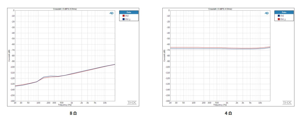

 Monolith-7 XTALK
THX Crosstalk Measurement of Monoprice Monolith-7 Amplifier
THX Goal: "The desired level of crosstalk is less than -70 dB throughout the audible spectrum; from 20 Hz to 20 kHz."
Crosstalk is an important measurement metric to ensure you have good channel-to-channel isolation, which leads to good stereo separation. If the channel under test isn’t being polluted by signals from adjacent channels, -70dB channel-channel isolation from 20Hz to 20kHz is a reasonable goal. In fact, we always talk about how amplifiers should be able to achieve at least -60dB of isolation between channels at 20 kHz in our testing.
Looking at their Monolith-7 test results, I find it unbelievable that a difference of 30dB at 20kHz is seen between driving the amp at 8 ohms vs 4 ohms. Are they even testing the same adjacent channels when driving 8 and 4-ohm loads? Did they terminate the inputs of the unused channels during this test or just allow them to remain open for susceptibility of RF ingress?
In my 20+ years of measuring power amplifiers and designing telecom equipment, I’ve never seen crosstalk measurements vary this much solely by changing the load impedance. You can see a difference at low frequencies due to magnetic coupling when current demand increases going from 8-ohm to 4-ohm loads, but at 20kHz varying the load impedance shouldn't affect this measurement since you're dealing mostly with parasitic capacitive coupling in that region.
Oddly, the Monolith-7 received their highest rating for crosstalk of all multi-channel amplifiers they’ve tested thus far despite it failing their -70dB requirement at 20kHz for a 4-ohm load by almost 10 dB.  This is a head scratcher for sure.
