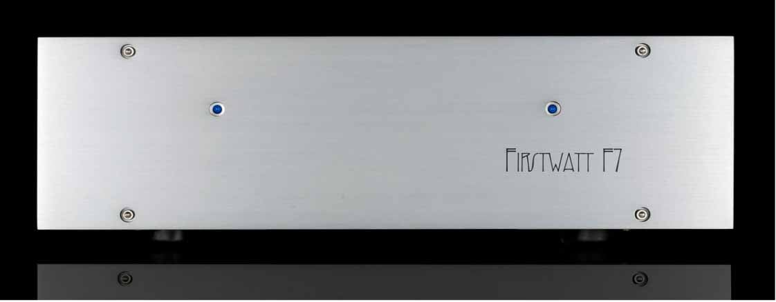

Pass Labs unveiled their new F7 power amplifier with emphasis on sonic purity and getting the first watt right. Unlike other models in their line up, the F7 is a relatively low power (25W/channel into 8-ohms) simple Class A circuit, designed with an unusually low parts count. It is the 19th product from their First Watt concept, since its founding in 1998 as Nelson Pass’ “personal laboratory”.

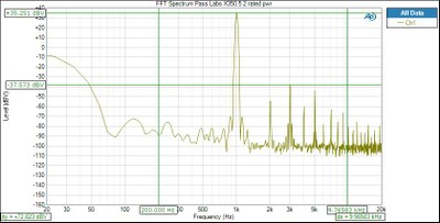

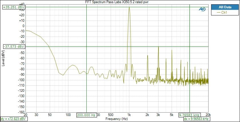

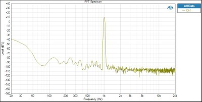

Quite frankly, I never understood this. Only in the audio world can the word amplifier "feedback" be a dirty word, especially in the high end community. Feedback not only provides stability in an amplifier circuit, it greatly reduces distortion and also increases usable bandwidth and lowers output impedance to make the amplifier output less dependent on the load it is driving. A couple of years ago we tested the X350.5 Pass Labs amp to see just how much "better" or different it could be than the competition based on their core philosophy of "first watt" and minimalist design. While we felt the amp sounded great, it's measured performance fell a bit short, especially for its hefty $11k asking price.
Pass Labs X350.5 FFT Distortion Analysis @ 1 watt

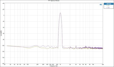

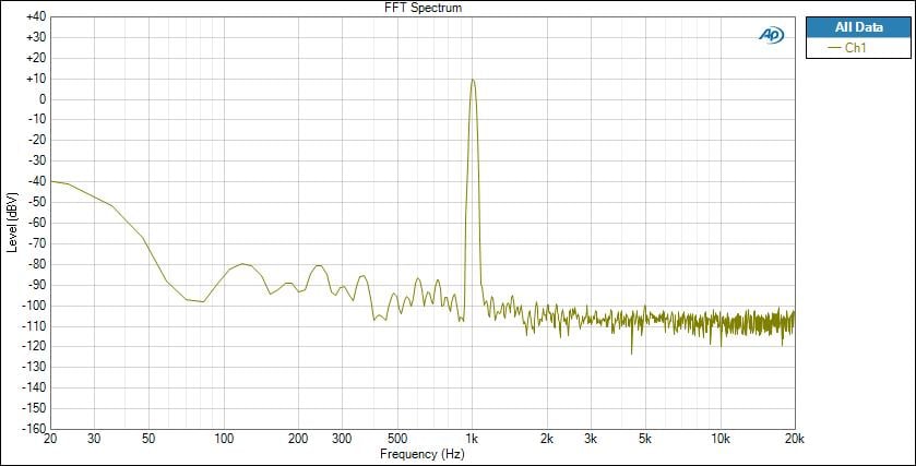

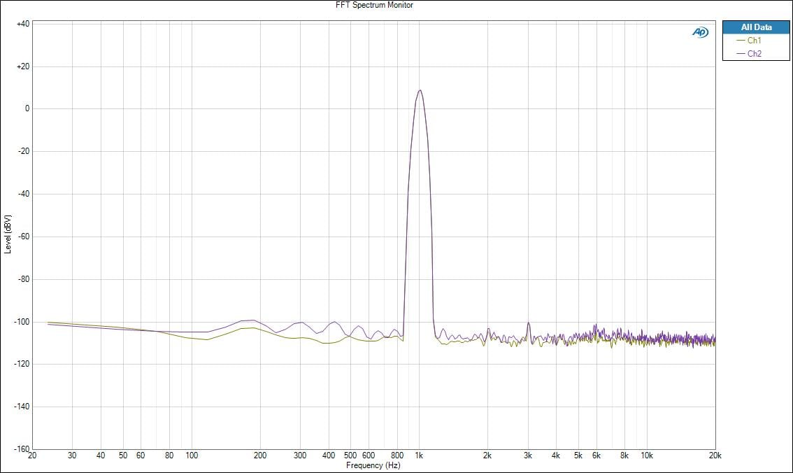

Notice the high DC offset at 1 watt. In our opinion this is unacceptable for SOTA amplifier design. We have to wonder why a DC servo-feedback scheme wasn't used to keep the DC offset at the output as near to zero as possible? By comparison look at the low DC offset of this much less expensive amplifier from Classe, namely the CT-2300.
Classe CT-2300 FFT Distortion Analysis @ 1 watt
Based on these measurements, the "first watt" of the Classe amp bench tests significantly better so we can't help but scratch our heads about the claim.
Pass Labs X350.5 FFT Distortion Analysis @ Full Power
Notice the high distortion residuals at full rated power. In our opinion this could have been improved with a more aggressive feedback circuit scheme. We've tested numerous high power amps that didn't distort as badly at rated output, so again we remain puzzled by the desire to "minimize" feedback in amplifier design.
