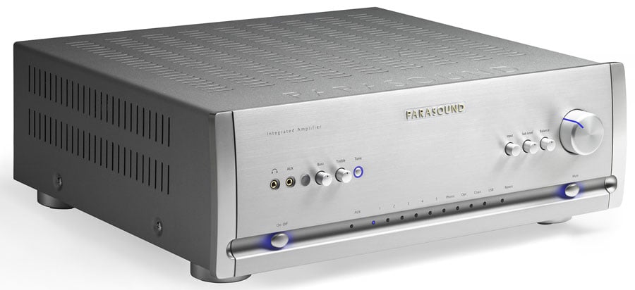

With all the talk over the past year about immersive audio and more speaker channels, one would think that good old stereo was dead.  Well, according to the folks at Parasound, two-channel stereo is alive and kicking.  But this Parasound isn’t your traditional integrated amplifier.  Whether it’s vinyl or the latest and greatest in digital audio, the Parasound Halo Integrated Amplifier looks like it’s equipped to handle just about anything you can throw at it.

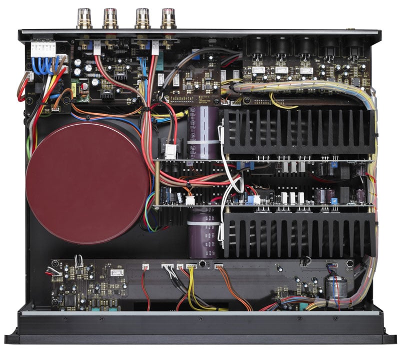

As you might expect from Parasound, the Halo Integrated uses the same John Curl circuit topology and high current design in the A 23 and A 21 power amps. The Parasound Halo Integrated Amplifier uses the company's classic Class A/AB, DC-coupled topology with a J-FET input stage, MOSFET driver stage and high-current output stage with 12 rugged Sanken bipolar output transistors. The Halo Integrated Amp features an oversized shielded toroid power transformer and 40,000 µF filter capacity and enormous heat sinks. Because it features the same Class A/AB circuitry as in its dedicated power amplifiers, Parasound says that the Halo Integrated can drive high-end loudspeakers with ease. It can put out 160wpc into 8 ohms (RMS, both channels driven at 0.9% distortion) and 240wpc into 4 ohms (RMS both channels driven at 0.9% distortion).  Parasound says that the current capacity of the amplification section is 45 amps peak per channel.  Take this peak amp rating with a grain of salt as we've found this to be a nebulous rating manufacturers like to tout: The High Instantaneous Current Amp Spec.
Parasound Halo Top View
Top view of the  Parasound Halo Integrated Power Supply and electronics.
But, we said before that this wasn’t your traditional integrated amplifier.  For starters, the analog preamp stage was taken verbatim from the company’s P5 stereo preamplifier.  That means that the Halo Integrated is subwoofer friendly.  The Halo Integrated Amplifier includes adjustable low pass and high pass crossovers and front panel subwoofer level control for seamless subwoofer integration.

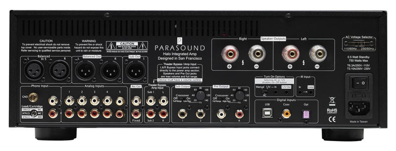

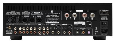

There’s also no shortage of input and output options.  The Halo Integrated has a balanced XLR input and XLR L, R and Sub preamp outputs. There are five line-level inputs, record/fixed level output, and a low noise MM/MC phono input with three loading options.
