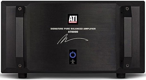

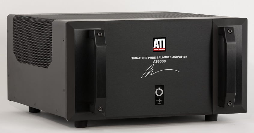

The outward design is a step up from ATI’s traditional utilitarian designs but remains skewed toward functionality. Still, W.A.F. (Wife Acceptance Factor) approval may require some wining and dining. All AT6000 amps sport large front handles which help immensely in moving these behemoths into place. They are removable and ATI will supply (upon request) shorter screws if you chose to remove them; it’s best to wait until the amps are in place.
The black anodized aluminum faceplate sports a backlit ATI logo, descriptive text, and a large signature, “M”, from ATI founder and designer Morris Kessler. The white lettering on black calls more attention to the map than I would like, but I have gotten used to it.
I thought it be useful to get a woman's perspective so I asked my wife for her opinion:
When I first saw these amps with the handles I thought they belonged in a mechanic’s shop – they were NOT pretty! With the handles off, they actually look pretty cool together on the bottom of our shelving, despite the oversized logos.
The ATI logo backlight can be toggled on/off with a touch, but when power is lost, the logos return to their lit default. There is an attractive touch-capacitive blue power switch that is not overly bright. There are also two small orange LEDs: “Stand by” if the amp is off and “Peak” which flashes when the amplifier is clipping. Peak indicators are a feature that I’d like to see on all amps, including AVRs (doubtful that this will ever happen).

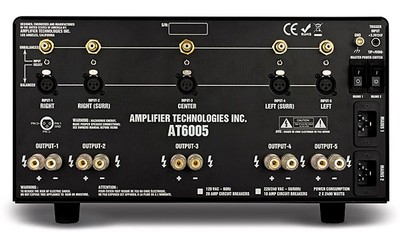

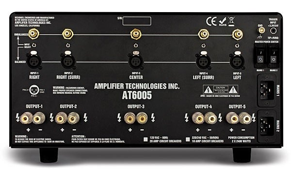

There are balanced and single-ended connections controlled by a switch for each. Both may be connected and switched which may be useful for connecting a separate 2-channel system. The shielded 5-way binding posts are solid and make tight connections with my banana plug connects. The Outputs are numbered and ATI recommends using the outer channels for the mains (for heat distribution). The dual power switches are also magnetic breakers replacing the power fuses found on many amps. An optional ground thumb screw is provided as well as a single trigger input.

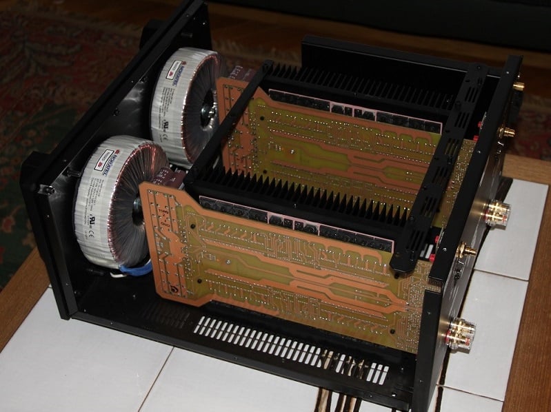

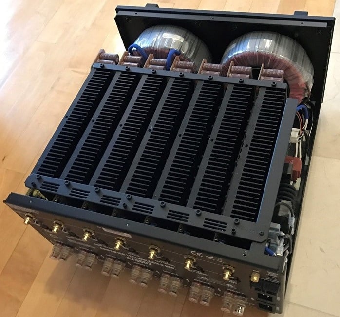

The AT6002 dual-mono amplifier with two 900 kVa toroidal transformers.

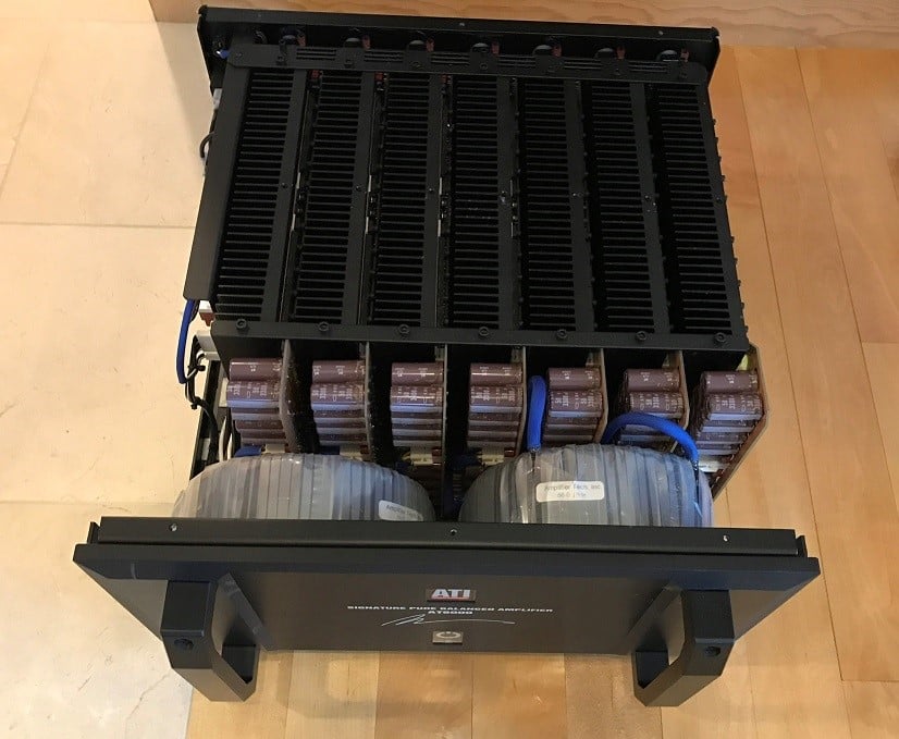

The AT6007 7 channels (fully loaded) with 59,400 microfarads capacitance per channel.
The AT6007 massive heat sinks occupy most of the internal volume.

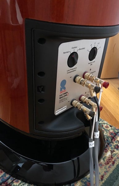

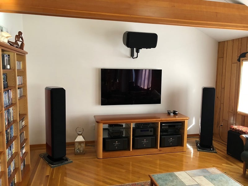

My main system has each Salon2 bi-amped by an AT6002. An AT6006 drives the Voice2 center channel and the Studio2 rear speakers which are also bi-amped. Each amp is connected to its own 20-amp circuit. This is complete overkill but since my house was converted from electric heat, it was a simple task to repurpose excess capacity. The amps are connected to the Emotiva XMC-1 but were also driven directly from the Oppo HA-1 and Sonica DACs. All pairings were excellent.

Bi-amping is relatively simple and inexpensive experiment that one can try at home. Armed with stacking banana connectors, it is very simple to stack them to single-amp and switch to bi-amping. I conducted single-blind-tests using a single Salon2 with 3 different listeners. At modest listening levels (low 80 dB range at best), all were all able to differentiate between bi-amped and single-amped, although preferences varied. A surprising result since at these volumes the amps are practically idling. This was sufficient for my buying decision, all of my Utlitima2s are bi-amped using AT6000’s.

Revel Salon 2 & Voice Speakers with 3X ATI 6000 Series Amplifiers
The RED and RED2 (4K UHD) Atmos tracks have numerous scenes where hundreds of rounds are fired including gunshots directly from the center channel. Honestly, I did not know the Voice2 could produce those sounds. I watched this film at -20 DB below “reference” which is loud in my room and received no complaints from my family, testament the AT6000 low distortion even during those thunderous dynamics.
Recently, the family watched “The Crown” seasons 1 and 2 on Netflix with the volume much louder than usual for this type of material; our American ears benefited from a 3 dB increase to the English dialog. I sometimes sit nearer to the rear channel and what a joy it is to hear them used for a full range music delivered completely from the rear channels. There are some very enjoyable DD+ sound tracks available from streaming services. Streaming video and audio quality are almost always better than my cable system. There is no question these amps make the Utlima2’s shine. With music or movies, the AT6000s never exhibited any hint of any stress, distortion, or limiting. They are a pleasure.
