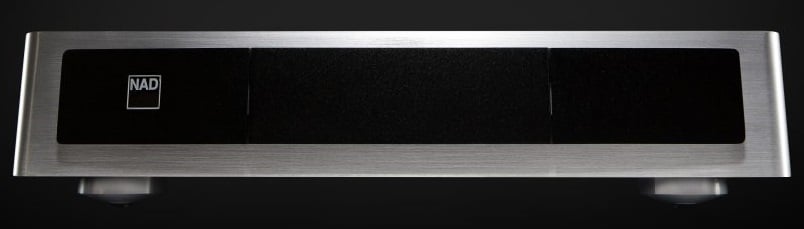

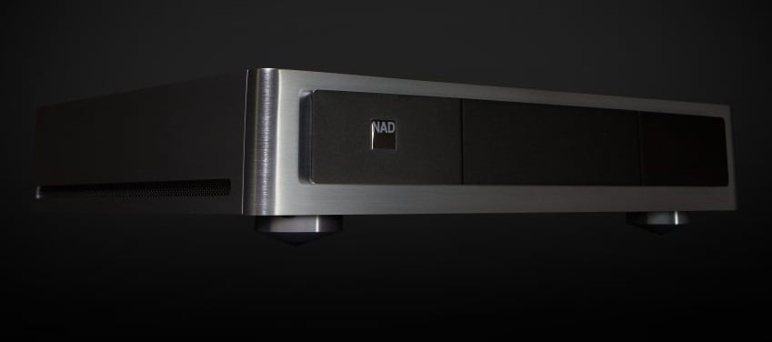

If you’re a fan of NAD electronics or if you’ve been thinking of upgrading your amp to a more sophisticated product brand you might want to check out NAD’s new M22 V2 Masters Series Amplifier released this year at CES, Las Vegas, Nevada. NAD’s new M22 V2 delivers a 20% increase in power over their previous model and adds bridging mode and an input sensitivity switch for system flexibility. Audioholics previewed the original M22 over 3 years ago with high praise. The new design will increase the power from 250 watts per channel to 300 watts per channel and also incorporates several upgrades over the original M22.

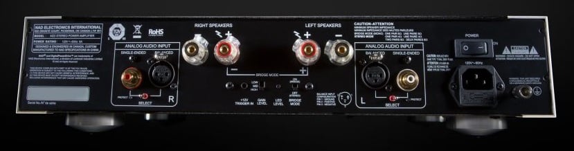

The M22 V2 also has a 3-position input sensitivity switch that controls the auto turn-on sensitivity, allowing for better matching to each individual system. The new bridging switch will transform the M22 into a 900-watt mono behemoth. The substantial increase in power is a result of a major redesign of the power supply. NAD’s exclusive PowerDrive circuit has been recalibrated to take advantage of the increased capability of the power supply section.
