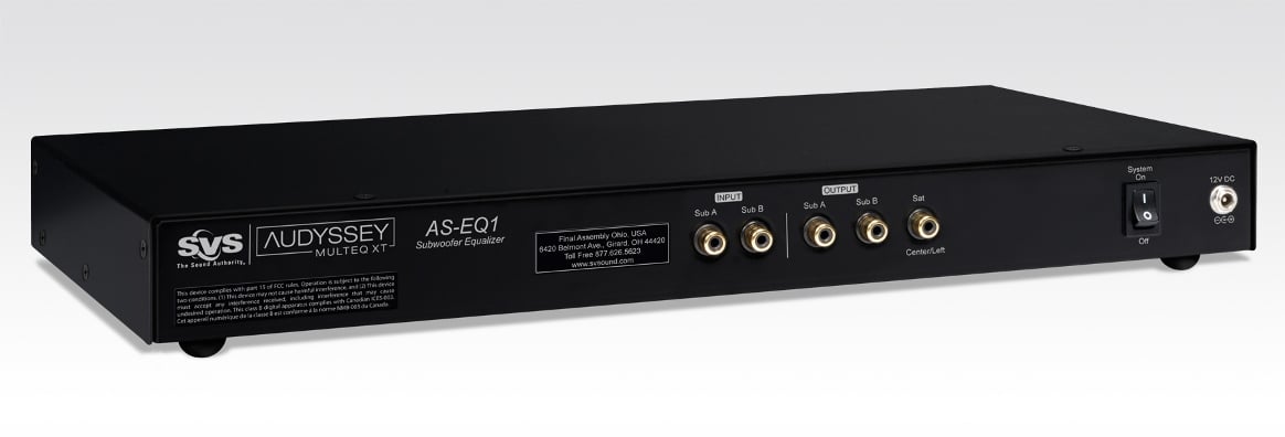

as_eq01_woplateThere are so few standalone active room correction systems on the market these days. Those that are available tend to be standalone not only in function but price costing many thousands of dollars. The alternative is usually to buy a sub with some manual correction (like a signal parametric EQ knob), an expensive sub with a more complete suite, or to buy a new receiver every few years. The ones with the really good room correction system usually cost quite a bit of money so again, you're stuck with a substantial investment. Even if you have purchased a receiver in the last few years, the newest ones are coming out with multiple subwoofer outputs which is giving most every audioholic a bad case of upgraditus.

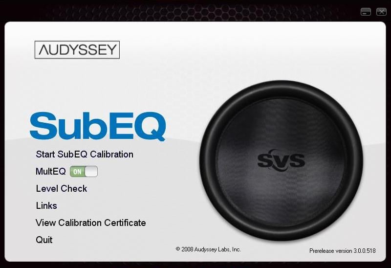

as_eq01_subeq_guiSVS may have what ails you. For a very reasonable (in this category) $799 (currently $699 on preorder) the AS-EQ1 sub EQ is their new standalone room correction system. A joint venture with Audyssey Labs, a name that is becoming synonymous with room correction, the AS-EQ1 offers computer interface, dual subs, and some very interesting aesthetics. The unit sports a magnetic faceplate which covers all the controls and most of the lights. The SVS and Audyssey logos are prominently placed on the faceplate but not the control face underneath. This has your mic inputs and outputs and your USB connection.

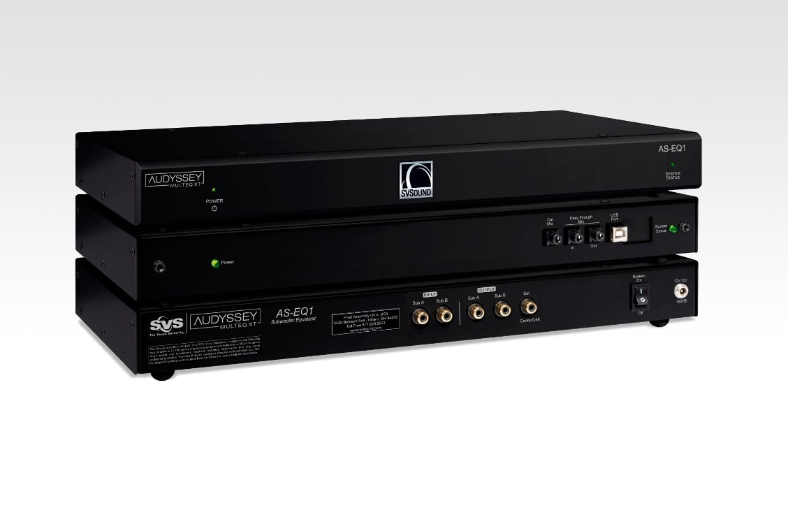

as_eq01_fullbackWith dual sub support, the AS-EQ1 is definitely a forward thinking product. The tweakers in the audience might not be as in love with the AS-EQ1 however as it is mostly an automatic process. Unlike other solutions in the same range, the AS-EQ1 will do most of the work for you - you just have to set up the mic and press "go." What was a slightly odd choice was that the SVS solution doesn't have a onscreen interface. Instead, you have to plug it in to your computer. Not a problem for those of us with laptops (or really long cables) but could discourage some buyers. You're definitely going to want to be aware of this limitation.
SVS makes some pretty serious claims about the AS-EQ1 such as, "In fact, we guarantee it. Acoustical nightmares are cleaned up fast as you can move the included microphone through your room." They are obviously excited by the product and want you to be as well. Ease of use is on the menu as is ease of setup. With two inputs and two outputs, it couldn't be simpler. What's nice is that if you have a single sub output on your receiver and you have two subs, you can plug the input into A and connect both of the subs - the AS-EQ1 will split the signal for you. In fact, if you have two different subs in two different systems you can use the unit to calibrate each separately.

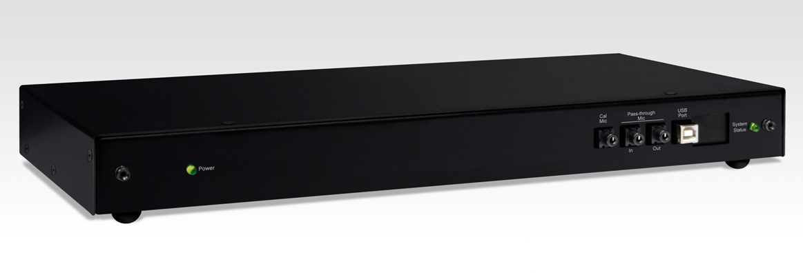

The AS-EQ1 is designed to be used with your receiver/processor's Auto EQ system. If you plan on using it, you connect the receiver/processor calibration mic up to the mic passthrough port on the front of the AS-EQ1 and run the auto calibration. The AS-EQ1 will tell your receiver that a sub is available but will not allow any test tones to the sub. This forces your receiver to calibrate only the speakers and leave the sub to the AS-EQ1. This is extremely handy as it ensures that the AS-EQ1 is truly an add-on bonus and doesn't defeat or make obsolete other (or future) room correction systems. One thing that all users will like is that the AS-EQ1 will provide before and after graphs of your room. This will let you know exactly what the AS-EQ1 has done. If you're still seeing problems, it's time to look into passive room treatments.
