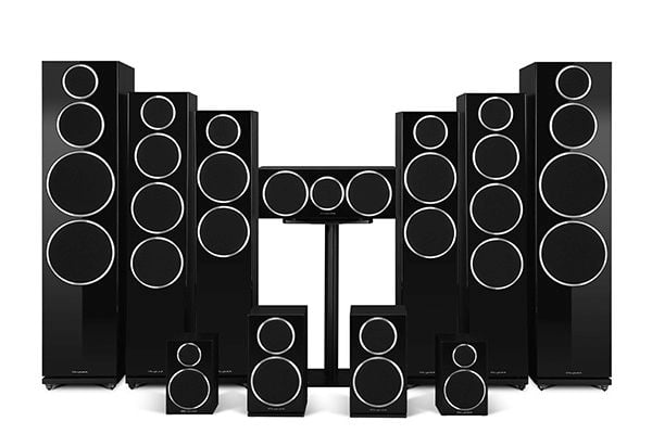

If you’re not familiar with Wharfedale, perhaps the first thing to know about the company is that they’ve been around the block a time or two. Starting out from a small factory in Bradford, England in the 1930’s, they’re one of the oldest loudspeaker manufacturers still in operation today. These days, Wharfedale produces a wide variety of loudspeakers, from their budget Diamond 10 line all the way up to the legendary Airedale. The company’s latest creation is the Diamond 200 series, which is slated for its US debut at CES 2015.
The Diamond 200 series consists of two bookshelf models, three floorstanding speakers, and a center channel. In addition to a clean look, all of the speakers in the new lineup boast layered cabinet construction to minimize the effects of resonance, as well as woven Kevlar cones on the midrange drivers and woofers. Are you ready to look at some speakers?

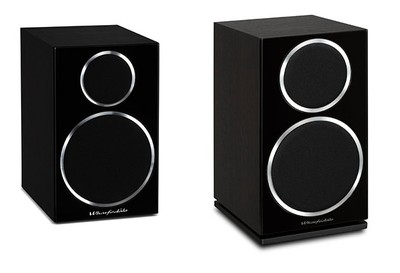

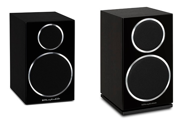

Diamond 210 & 220
Starting with the bookshelf models, you have the Diamond 210 and 220 speakers. Both are two-way ported designs; the Diamond 210 utilizes a 25mm soft dome tweeter and a 100mm mid/woofer, while the 220 bumps up to a 130mm mid/woofer. The 220 also appears to load the tweeter into a waveguide, which helps control dispersion, while the 210’s tweeter is flush mounted on the baffle. In terms of technical specifications, both the 210 and 220 are listed as 8 ohm nominal with a minimum impedance of 4.1 ohms. Sensitivity for both models is listed at 86dB with 2.83V at 1m, and taken together with the impedance rating suggests that these speakers would be best fed by a reasonably stout amplifier. Looking to frequency response, the Diamond 210 is rated from 68Hz-20kHz +/-3dB, while the Diamond 220 extends a bit lower, down to 56Hz. Given the low frequency rating of both speakers, we recommend that they be used with a subwoofer for full range audio reproduction.
Diamond 210 and 220
The Wharfedale Diamond 210 (left) and 220 (right).

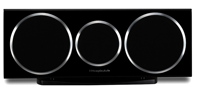

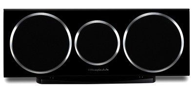

Diamond 220C
Last but not least, we have the Diamond 220C center channel. A two-way ported horizontal MTM design, the 220C boasts a 25mm tweeter mated to a pair of 130mm mid/woofers. Typically, we’re not too enamored with this arrangement, as operating a pair of woofers side by side up to 2.3kHz in this case will generate acoustical interference, which can cause problems for listeners far off-axis. However, in most listening situations, properly designed horizontal MTM's do work fine.
Please see: Horizontal vs Vertical Center Channels Alternative Perspective
Moving on to technical specs, the Diamond 220C is rated at 8 ohms nominal (4 ohms minimum), with a sensitivity of 89dB with 2.83V at 1m. Frequency response is rated from 60Hz-20kHz +/-3dB; given that the likely use is home theater, crossing over to a subwoofer is again highly recommended.
Diamond 220C
The Wharfedale Diamond 220C.
