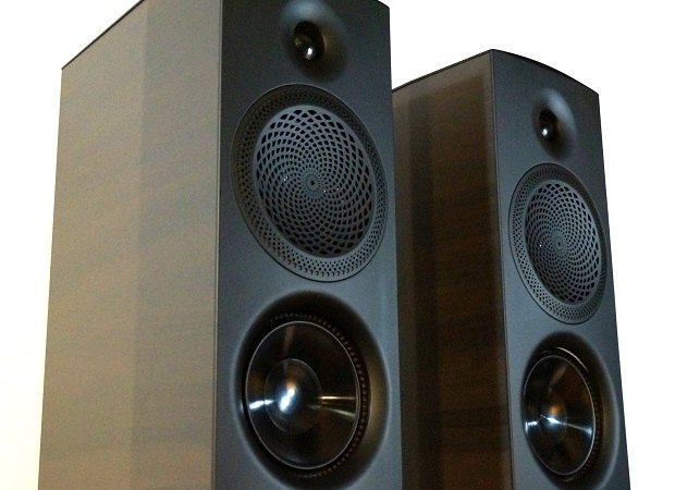

Paradigm Premier 800F Tower Speakers
>Buy Now< MSRP: $2,000/pair (in Gloss Black, Gloss White, or Espresso Grain)
The
Paradigm Premier 800Fs are attractive and interesting-looking speakers without
be
ing flamboyant or splashy. Our review pair came in an Espresso finish which
had an understated appeal for those who want a high-end look but don’t want
their audio equipment to gleam. The 800F has the largest midrange driver among
the speakers in our round-up at a 6.5” diameter. That is fairly large
for a midrange when combined with dual 6.5” bass drivers and a 1” dome tweeter, but
surprisingly this did not incur any real problems in the speaker’s directivity
since that can be a problem for large midrange drivers. The audio performance
that we measured from the 800Fs had a superbly neutral response, and of all the
loudspeakers in our round-up, these are probably the most accurate sound
reproducers. They had a very flat on-axis response combined with a beautifully
smooth off-axis response. This made for a very tonally balanced sound over a
wide listening area.
The build quality was very good with above average cabinetry and high-quality components. The 800Fs packs a lot of technology from Paradigm’s many patents from higher-end designs. The 800Fs demonstrate Paradigm’s expertise in leveraging their engineering experience into an affordable yet technically excellent loudspeaker. I had previously reviewed the far more expensive Paradigm Persona 5F tower speakers which were terrific, but I like the Premier 800F speakers even more than the Persona 5Fs even though the 5Fs are $17,000 a pair and the 800Fs are $2,000 a pair. It’s not that the 800Fs are a better speaker, but they managed to achieve such a good sound yet are far more affordable. Lots of speaker manufacturers can deliver a good speaker for a $17k price tag, but Paradigm has delivered an outstanding speaker for a much more accessible $2k, and that is more impressive to me. What’s more, they have managed to do that without resorting to Asian manufacturing; these are the only loudspeakers in our round-up that is manufactured in North America rather than Asia.
