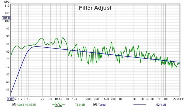

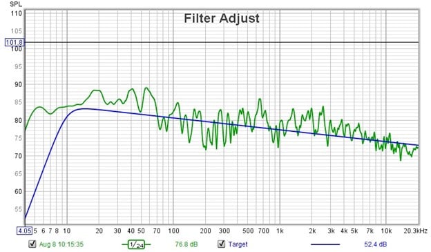

As for the in-room measurement, what we saw was a typical in-room response full of resonances caused by various reflections and room modes. The natural downward slope and relative smoothness suggest consistent directivity.  The rate at which the response falls between 100hz and 10khz suggests that directivity is well controlled, but not overly narrow, as it follows close to the typical target curve, if not a little flat.  Above 10khz, the response falls faster, suggesting narrowing directivity, typical of most speakers.

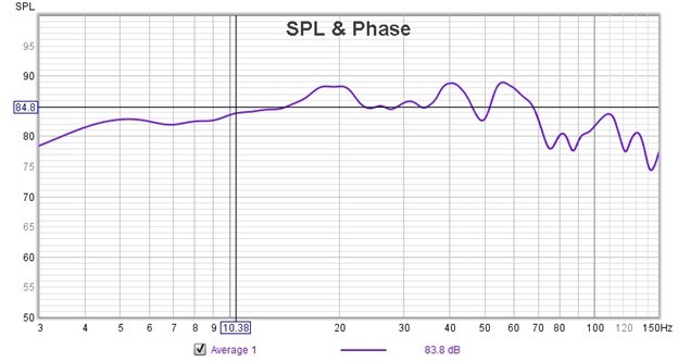

in room extention
The in-room extension is unreal.  I’ve long known that sealed box subwoofers could get better extension in room because of the slower rate at which the response falls off (2nd order).  However, most sealed subwoofers we deal with have limited output and a fairly low excursion.  While it may technically be possible to get very low extension, it’s typically at such low levels it is not useful.  Here, what we saw was a response that was rising toward around 10hz, where it then slowly fell, leading to high output single digit extension.
SPL$Phase
What is most impressive about the response we see in Image 3 is that there is no clear end in sight for that extension.  I have that graph starting at 3hz and the bass is only down around 4-5dB.  That is with no EQ extending the response.  The sealed boxes allow very deep extension in room and the four 18’s have enough output to allow a pretty aggressive room curve if so desired.

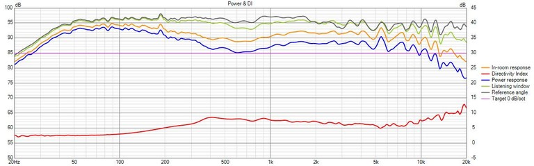

Now, I managed to get some outdoor free space measurements.  The speaker was placed on a stand around 5 feet off the ground.  The stand we used, given the size of the speaker, raised heavy loads much like a small fork lift, rather than our typical style of stand.  This worked to get the speaker off the ground, but unfortunately didn’t allow easy rotation nor was high enough off the ground.  The acoustic center of the speaker was just 7 feet off the ground.  When measuring the speaker at 2 meters, we couldn’t get a clean enough signal.  I moved the mic to 1 meter, which improved things dramatically.  Measuring this speaker in the future will demand a different approach to get good results.  This allowed me to capture the on-axis response with a clean impulse response out to around 9ms.  By then windowing this measurement and splicing in the bass response of it and the bass module, we can see that the on-axis response is very smooth.
RTJ Measurement
There are a few resonances and the shape isn’t totally flat, but it tracks a good response shape for a speaker of this type.  There are a few resonances in the response that a bit of DSP could address.  None of these are majorly concerning, the response still falls within a +/- 2dB window, and fixing these tightens that to fit within a +/- .5dB window.  For custom installers, this kind of intrinsic correction is readily possible and appropriate.  What isn’t correctable and was unexpected is the directivity.  While not horrible by any means, you can see a shift in directivity between the midbass drivers and waveguide.  This is caused by the diameter and spacing of the 10” midbass drivers, causing a narrowing in their directivity starting around 200hz and becoming most prevalent at around 700hz.  This causes a rise in the DI and a dip in the power response.  This is even evident in the predicted in-room response.  This actually threw me during tuning and I initially corrected this, only to find it made the speaker sound worse, not better.  This is not unheard of.  Interestingly, other than this slight issue, the speaker’s directivity is so well controlled that the directivity index is basically flat.  This is really unusual to see a DI that is so flat and well extended.  It is basically around 6-9dB from 400hz to 15khz.  There is a bit of widening in the directivity around 5-10khz where the DI is at its lowest, around 6-7dB.  Most speakers would have a rising DI, and often not nearly as linear.
