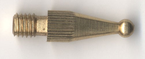

items.  Pinnacle supplies solid brass
feet with a ball tip on the bottom to prevent damage to hardwood flooring.  They seemed to make the speaker extremely
unstable on carpeted floors, so I don’t recommend installing them in those

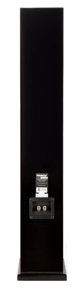

The back of the BD 1000's are unremarkable.  They have a simple pair of 5-way binding post
connections with no provisions for bi-amping or bi-wiring.The

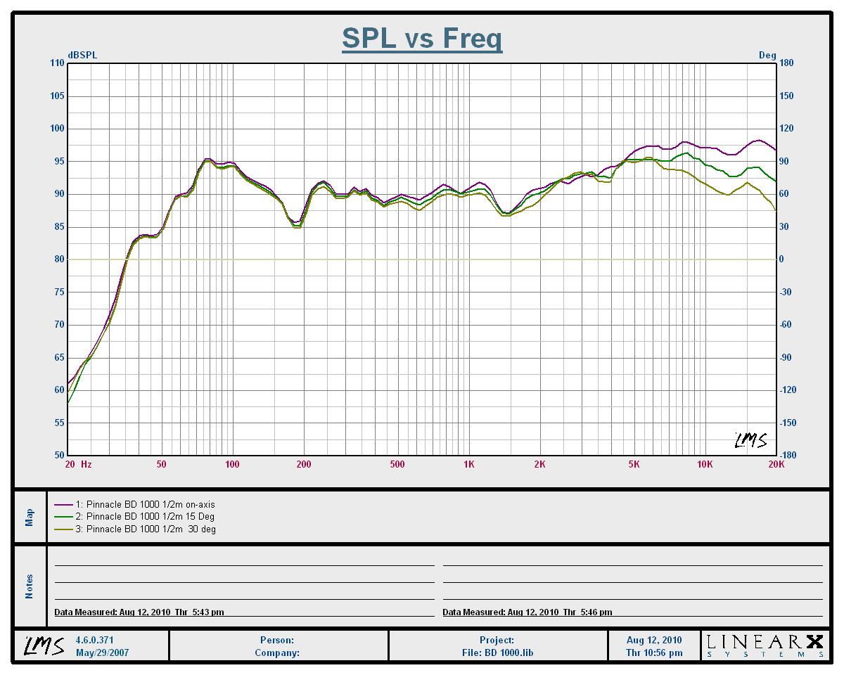

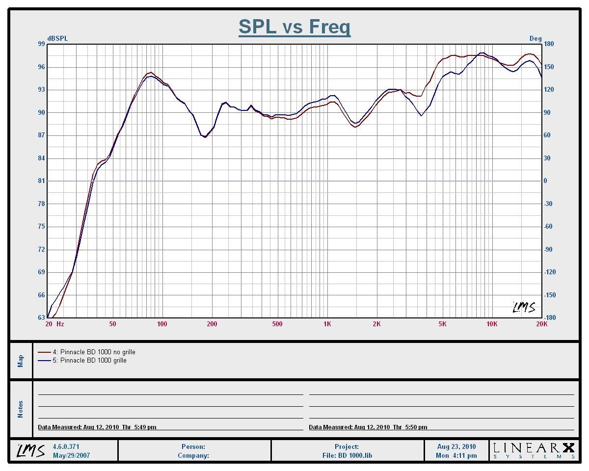

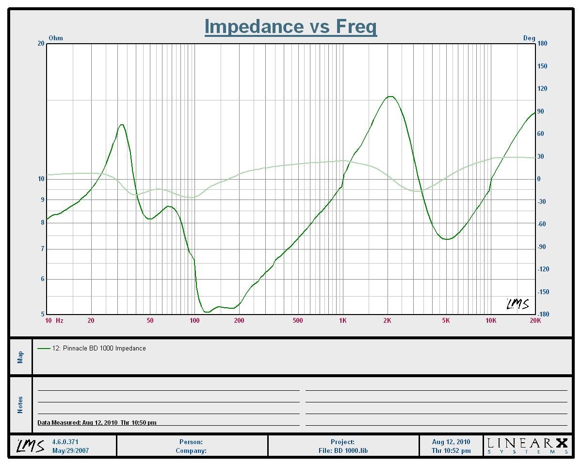

BD 1000 is rated at 8-ohms and has a claimed frequency response of 34Hz to

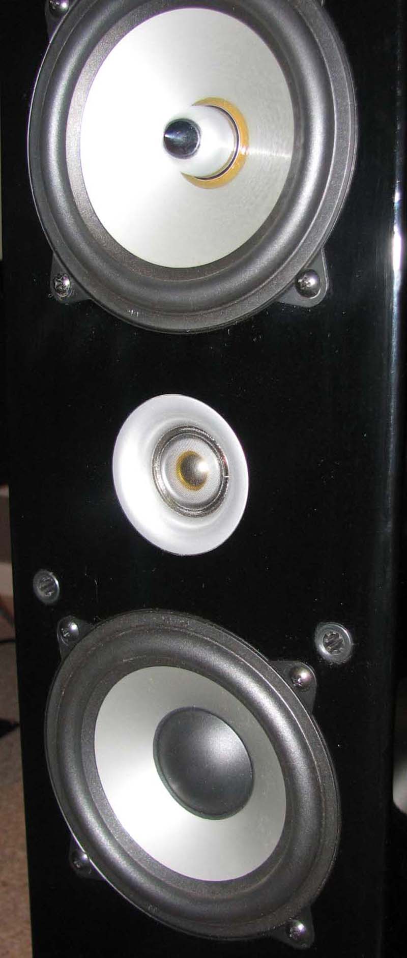

20kHz (+-3db) with a sensitivity rating of 88dB 1 watt/meter.  This system is a three-way, four element, 4th
order front vented design consisting of two 5-1/4" polymer woofers, one
5-1/4" polymer midrange with phase plug, and a 1" horn loaded silk
dome tweeter with neodymium magnet.  I'm
not a huge fan of neodymium tweeters because they are often thermally limited,
but Pinnacle was obviously well aware of this limitation and hence chose a high
crossover point (5kHz) to reduce system strain and preserve dynamics.  Though, I couldn't help to wonder if the
system would have blended better with a 3/4" dome tweeter instead of the
1" horn loaded dome they chose.  To
pull this high crossover point off correctly, Pinnacle would have to use a small
enough midrange with high enough usable bandwidth to ensure a seamless
blend.  Small drivers require a larger
motor structure and add cost.  Large
drivers don't do well here but the phase plug does helps to extend
bandwidth.

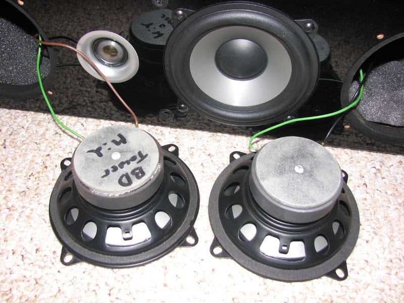

The
midrange has a real phase plug and not the fake knock off (quasi-phase plug)
popularized by some of the budget European speakers. Those quasi-phase plugs
serve no purpose other than cosmetic and can actually hinder performance by
providing an inconsistent surface area while also increasing cone mass. Typically,
this yields poorer frequency response and linearity.  A real phase plug driver like the one found
in the Pinnacle BD 1000's doesn’t move with cone excursions as its not directly
connected to the cone.  This allows the
driver to extend its usable frequency response by reducing cone mass and
decreasing beaming.
The woofers are all stamped metal
baskets and magnetically shielded though my samples were prototypes and
unshielded which is a moot point in this day and age with virtually everyone
tossing their bulky CRTs for flatpanel displays.

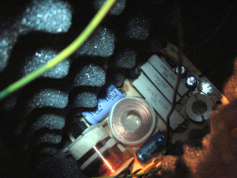

The
crossover consists of a combination of air core and iron core inductors,
ceramic resistors to pad down tweeter sensitivity and electrolytic
capacitors.  Nothing here stands out as
high end or specialty but, as I've found in the past, Pinnacle has a knack for
designing good sound with budget components.
The resistors being so closely spaced causes me a little concern with
regards to heat but I've seen many speaker manufacturers do this to cut down on

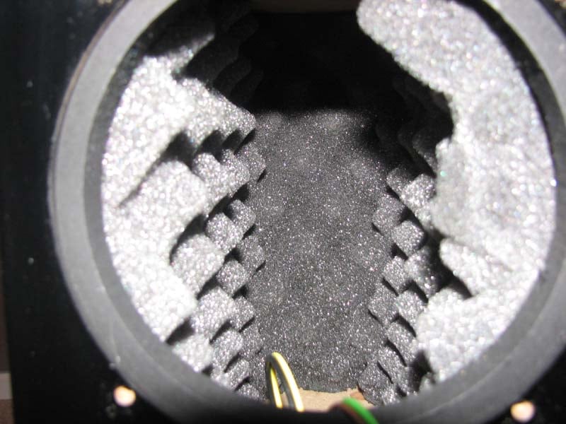

PCB board space and cram the crossover into the enclosure.  The cabinet appears to be 1/2" MDF with
a 3/4" front baffle and is stuffed with egg carton type foam.  The midrange is in its own enclosure to
ensure optimal performance and employs a first order high pass filter.  The midrange still contributes to the overall
upper bass output of the system without causing the system impedance to drop at
low frequencies.

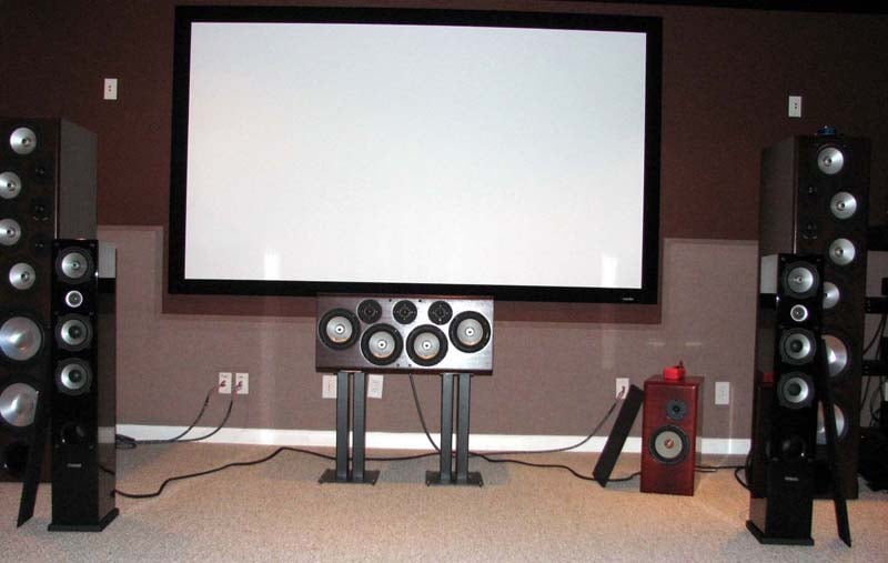

I set up the BD 1000s in the
Audioholics Showcase home theater room using my Marantz PM-11S2 Integrated
amplifier and Denon DVD-A1UDCI BD player as the source.  The BD player was connected via balanced
analog outputs to the PM-11S2 using Impact Acoustics balanced cables.  The speaker cables were Kimber 8PR with WBT
compression banana terminations.
The speakers were positioned about 5ft from side and backwalls, spread apart 10ft from each other which was about two feet shy of the 12ft distance to my primary listening position. After experimenting, I found they sounded best when toed in slightly which really focused the imaging and vocals but also overemphasized the treble slightly.
Unless otherwise stated, all listening tests were conducted full-range without a subwoofer in two-channel configuration. This is the worst possible test condition for this speaker system as I suspect most users will bass manage them utilizing a powered subwoofer to take the stress off the speakers and provide more bass impact, especially for movies. Nevertheless I treated this review as a dedicated two-channel setup but in most cases I do recommend a powered subwoofer even for two-channel setups.

Impedance / Phase Measurements of the Pinnacle BD 1000
The BD 1000s maintain an 8 ohm rating all the way down to DC but the sharp dip down to 5 ohms in the 100-200Hz range where amplifiers are usually taxed to deliver a lot of power gives me pause about saying they are an easy load for any receiver amplifier to drive. Further work could have been done by the manufacturer to better optimize the crossover. Looking at the frequency response of these graphs and the impedance plot, the BD 1000s appear to be tuned at around 50Hz. The asymmetrical saddle points are likely caused by the impedance dip of all three 5.25" inch drivers in combination with their crossover network. Again further optimization of the crossover would have helped this.
In-room
1/2 meter SPL vs Frequency Pinnacle BD 1000 (1/12th octave smoothed)
Purple
trace: on-axis; Green trace: 15 deg off-axis; Yellow trace: 30 deg off-axis
Measuring
the BD 1000s in my listening space revealed a very smooth midrange response
overall with a bit of excessive top end likely caused by the horn loaded
tweeter.  In my experience, Pinnacle has
always run the tweeters a few dB high in their products to appeal to a wider
listening audience.  Overall this strategy
pays off in most cases unless the listener is ultra critical about having a
tonally neutral speaker, or if they tend to play the speaker at very high
output levels which places further strain on the tweeters since they are
working harder.  Normally I would NOT
recommend toeing in these speakers because of the excessive tweeter output, but
I found them to image much better when toe-ed in.  So slight toe-in is recommended in most
cases.
When
I power swept the BD 1000s, I found one of the cabinets resonated slightly at
around 300 Hz.  If I applied pressure to
the cabinet, the resonance went away.
Since these were prototypes I think it's safe to assume this issue was a
function of my sample and not a flaw in production units.  In any event, I never detected this cabinet
resonance in my listening tests so the comments here are mostly academic.
In-room
1/2 meter SPL vs Frequency Pinnacle BD 1000 (1/3rd octave smoothed)
Purple
trace: no-grille; Blue trace: with grille
The grille cover does soak up some of the upper midrange and high frequency response of the BD 1000s (about 3dB from 4kHz to 7kHz). This can actually be a welcomed thing for listeners finding the speakers to sound a bit too bright. In those cases, keep the grilles on, this will reduce the brightness and also make the wife happy as the speakers literally disappear into the room with them in place.
