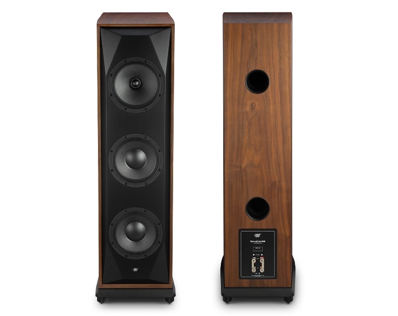

SourcePoint 888 with grillesAfter the commercial and critical success of the MoFi SourcePoint 10 and SourcePoint 8 stand-mounted speakers, it was only a matter of time before celebrity loudspeaker designer Andrew Jones added to the lineup by creating a SourcePoint floorstander for MoFi Electronics. The new SourcePoint 888 ($4,999/pair) aims to “expand an immensely successful loudspeaker series and meet the needs of a wider variety of customers,” according to the company. The name SourcePoint 888 comes from its use of three 8-inch drivers — one 8-inch midrange driver housing the concentrically-mounted tweeter, and two all-new 8-inch woofers mounted below. Though not a huge speaker, the 42-inch-tall SourcePoint 888 is 12.6 inches wide and over 16 inches deep, making it appear somewhat chunky compared to more svelte competitors like the KEF R5 Meta or GoldenEar T66. That said, the SourcePoint 888 is attractive to my eye, and its proportions are certainly more in line with expectation than those of the unusually stout-looking SourcePoint 10. Jones introduced the new speaker at the recent Axpona audio show in Chicago, in the context of a very a simple system including the HiFi Rose RA180 Integrated Amp and a streamer from the same South Korean brand. MoFi is marketing the SourcePoint 888 as a great all-rounder, “intended to appeal to music lovers of every stripe — and to play every kind of music.”

SourcePoint 888 Walnut front rear
The new 8-inch paper cone woofers reportedly use dual opposing neodymium magnets in an assembly that employs a short coil in a long magnetic gap. Jones says that this configuration results in a magnetic field that is entirely uniform throughout the gap, providing a very linear and precisely-controlled force for driving the cone. (The woofers in his mega-expensive TAD speakers were built with this same short-coil, long-gap design.) Jones says that the dual opposing magnets can lead to difficulties in the assembly process, and so MoFi had to build custom jigs to ensure a smooth manufacturing process. All three 8-inch driver assemblies operate in individual, isolated chambers that have been sized for optimal acoustic performance. The construction of these chambers added two vertical braces and three horizontal ones, dramatically increasing the stiffness of the dual-ported cabinet. This in turn helped to further reduce cabinet resonances. The cabinet’s front baffle is an impressive 1.5 inches thick, and the side walls are ¾ inch thick. It’s no wonder, then, that each speaker weighs nearly 100 pounds.

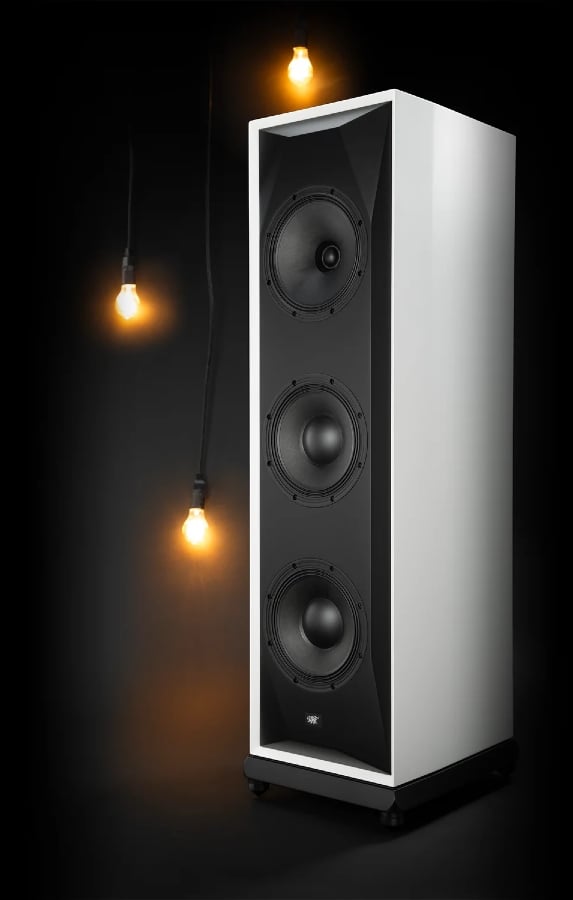

SoucePoint 888 WhiteJones says that one potential downside of the short-coil, long-gap woofer configuration is that it’s difficult to get enough flux in the gap using just one magnet. Hence, the dual-magnet approach for the two woofers, which run in parallel, with equal cabinet volumes and equal port tuning. The overall impedance of the SourcePoint 888 is 6 Ohms nominal, with a minimum impedance of 4.5 Ohms. That’s notably lower than the SourcePoint 8, which has a nominal impedance of 8 Ohms, with a minimum of 7, but Jones says that the new tower is still “relatively easy to drive,” with a sensitivity rating of 87dB a 2.83V 1/m). “It’s not a killer low impedance like some speakers,” he said. Fans of the SourcePoint 8 will find that the 888 offers the same sound balance throughout the midrange and treble, but with added “bass oomph,” according to Jones, who says the speaker is tuned down to 32Hz. The MoFi SourcePoint 888 will be available in Q2 of 2024, in your choice of satin real wood Walnut or Black Ash veneer. A satin white paint finish has been shown in pictures and may become available at a later date. Check with your favorite authorized MoFi dealer, like our friends at Audio Advice.
