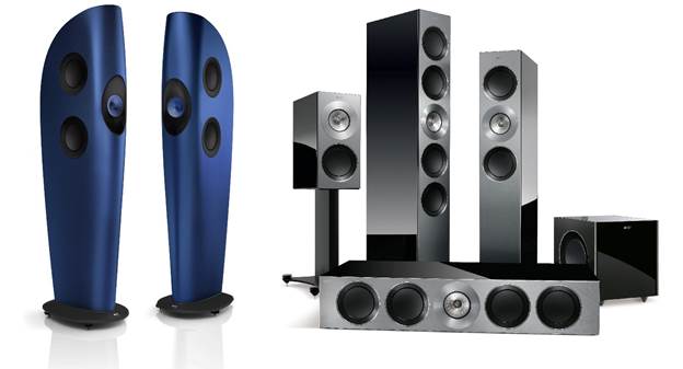

KEF has decided to expand the family of
Blade speakers with the new Blade II floorstanders. These new Blade Two speakers
feature updated drivers, a slightly smaller form factor, and a reduced price.
At $24,000 a pair, they may not be on your Christmas list (they might make your
"win the lottery" list) but they are less expensive than the original

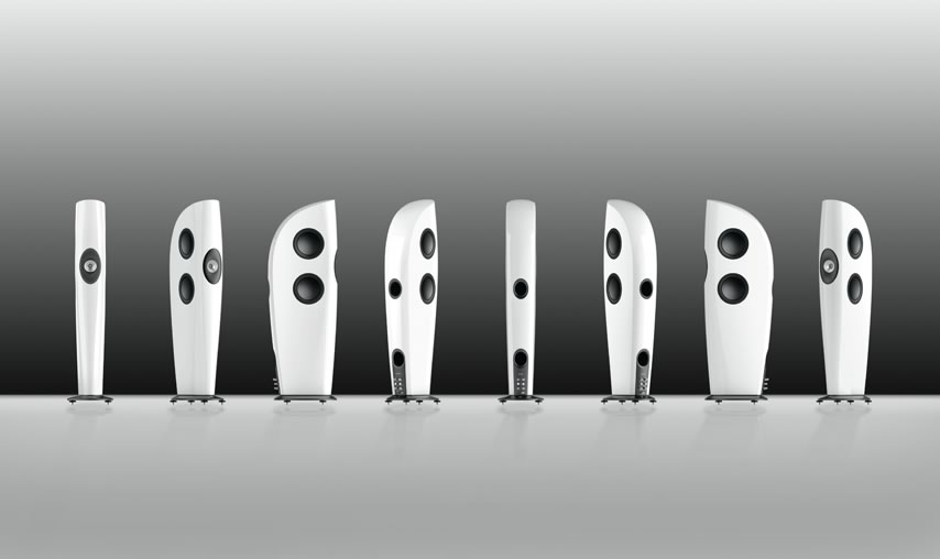

Blade speakers. Kef claims the Blade Two have been developed with a smaller footprint in mind for urban and European markets, where there are more space constraints.
This is probably an image of the original Blade but they look the same.
The Blade Two speakers feature KEF's signature Uni-Q driver. Featuring a 1" aluminum dome tweeter mounted in the center of a 5" midrange, the Uni-Q has been tweaked for this speaker. Like previous iterations, it sports a "tangerine" waveguide. The concentric driver is the only forward-facing driver on the speaker. The parabolic curvature of Blade Two’s high-density polyurethane enclosure increases cabinet rigidity and houses four side-firing 6.5" aluminum cone woofers (two on each side). The bass drivers are decoupled from the enclosure and are opposing for a "force-cancelling" effect. The original Blade speakers had 9" drivers and a slightly larger enclosure.
With the smaller bass drivers and the smaller enclosure, you'd expect slightly less bass out of the Blade II speakers. You'd be right...sort of. Both the speakers have a -3dB rating at 40Hz. However, the original Blade speakers were rated down to 28Hz -6dB and 20Hz "in room." The new Blade II speakers are rated down to 34Hz -6dB and 25Hz "in room." Frankly, if you are pairing the Blade speakers with a subwoofer, you could save $6,000 and get the new Blade II speakers and likely not notice the difference.

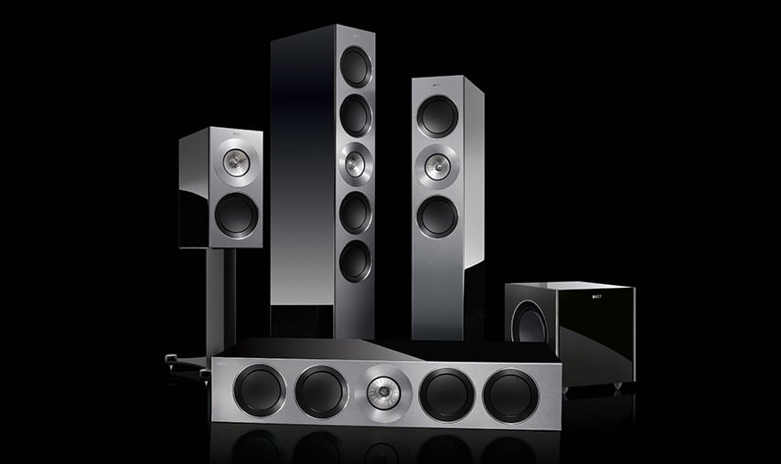

The New Kef Reference Series
KEF is putting new technology to work in their Reference line speakers. The new line has the upgraded Uni-Q driver and the upgraded 6.5" woofers. There are five Reference designs: a three-way bookshelf speaker, two formidable three-way floor standers, a three-way timbre-matched center channel, and the powerful twin-driver subwoofer, which utilizes KEF’s ‘force-cancelling’ technology. The Reference’s distinctive front baffle is made from laminated aluminum and resin composite which is formed in extreme temperature and pressure to add rigidity to the cabinet structure and providing acoustic damping. Pricing for the Reference speakers are:
- REFERENCE 1: Three-way bass reflex bookshelf – $7,500 /pair
- REFERENCE 3: Three-way bass reflex floorstander -- $13,000 /pair
- REFERENCE 5: Three-way bass reflex floorstander -- $18,000 /pair
- REFERENCE Center: Three-way bass reflex center channel -- $7,500 /piece
- REFERENCE Subwoofer - $5,500 /piece
When a new, smaller version of a flagship speaker is released, we often think that the company is trying to make it more affordable. That doesn't seem to be the case with KEF's Blade II. Instead, KEF is using their flagship speakers to inform the rest of their speaker lines. When they needed different drivers, they first moved to the Blade speaker and came up with a new design that could trickle down to their other speakers. Now they not only have an upgraded Uni-Q concentric tweeter/midrange driver, but new 6.5" bass drivers. Of course, they immediately put these drivers and technologies into an upgraded Reference line. We expect to see many more speakers with cues from the Blade Two speakers. Or, if you have $24,000 for the pair, you can buy these now!
