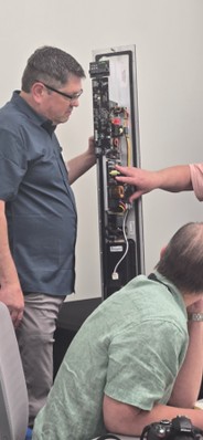

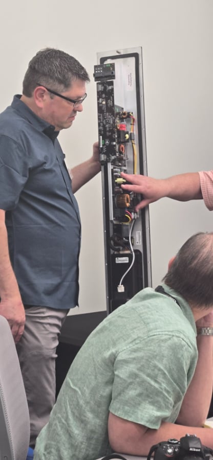

Amplifier internals

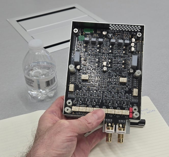

PCB
Gene and Bertha filled in some key details, including the fact that P.A.R.O. is a closed-loop system with repeatable and consistent calibration results, measured continuously to refine the calibration process (which takes 10 to 15 minutes, start-to-finish). It can be run for multiple seat locations, and up to 5 P.A.R.O. listening positions and 10 user profiles can be stored. This allows each user to fine-tune the audio experience based on room acoustics, seating position, and frequency response preferences. While most typical room-correction software solutions downscale high-resolution content to 48kHz or 96kHz, P.A.R.O. maintains full audio resolution up to 192kHz for both analog and digital sources. And Bertha pointed out that, unlike traditional room correction systems, P.A.R.O. operates with a distinct advantage — it already “knows” the speakers. Because the system is preloaded with the full performance parameters of both the Primacy S3 standmount and T6 floorstanding speakers, P.A.R.O. can more accurately isolate and correct for the room’s influence in real time. The system provides precise control over crossover filters, equalization, dynamics, delay, and phase, offering a level of control that feels less like correction and more like true system optimization. Although users do have the ability to tweak to their hearts’ content, the automatic nature of P.A.R.O. makes it accessible to users at all experience levels.

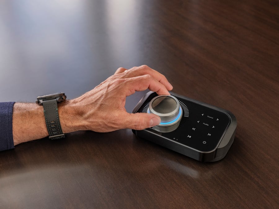

The Wi-Fi-connected tabletop remote controller features a weighted volume knob and touch buttons to select source, profile, and more. This is the part of the system that users will interact with on a daily basis, and it’s clear that having an elegant and attractive command hub for the system was a priority for the JL Audio team.
From a usability standpoint, I appreciated the inclusion of a dedicated digital remote with a physical knob. There’s something inherently satisfying about tactile control — being able to feel adjustments in real time adds a level of engagement that purely app-based systems often lack.

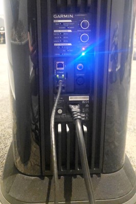

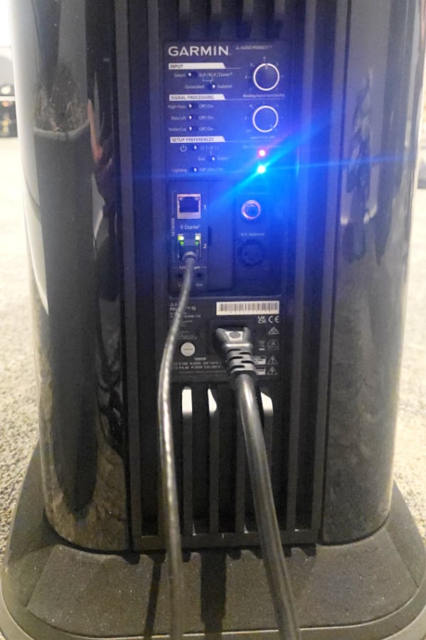

Tower rear panelThe Centerpiece connects to the Primacy loudspeakers via studio-grade Dante networking technology, preserving a high-resolution digital signal flow. Dante is built into each Primacy loudspeaker; it establishes a routing, control, and audio connection to stream clean digital audio directly to the Primacy loudspeakers’ internal amplifiers. Streaming options include Roon (with full Roon Ready certification), Spotify Connect, Tidal Connect, Qobuz Connect, Apple Airplay, and Google Cast. Audio and room optimization controls are handled via the companion Primacy app, which can also be used to create, store, and name listening profiles optimized for different listening positions, equalization preference, and media types.
The factory tour felt like stepping into a high-end production environment where precision is the standard. From automated processes to detailed assembly work, every step is intentional. Serviceability is also built into the design, allowing for efficient in-house repairs when needed. The anechoic chamber testing further reinforced JL Audio’s commitment to performance validation.

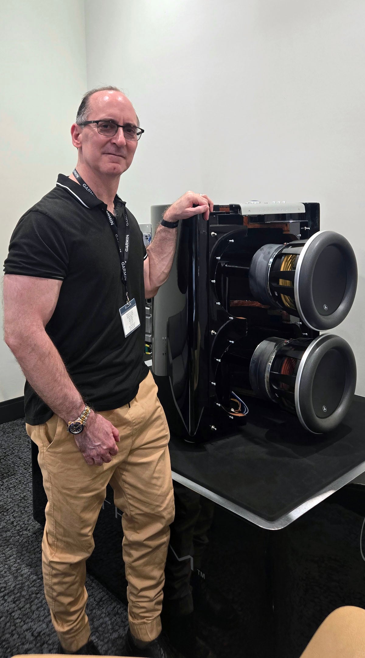

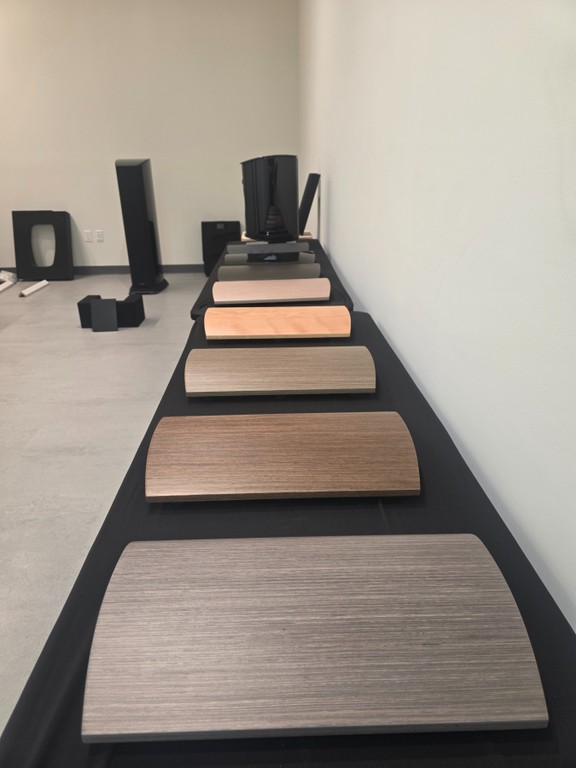

In addition to active listening demonstrations (more on those in a moment), the Primacy event included a technology seminar to provide further context. The folks at JL Audio explained how the speakers’ one-piece, sand-cast aluminum enclosure provides a rigid, resonance-resistant structure, which includes many internal features, such as the bracing and ports for the woofer section. Your interior decorator will surely appreciate the fact that the Primacy loudspeakers can be customized with a variety of beautiful finishes to complement the design of any room. The furniture-grade side panels are compression-molded from a glass-fiber-reinforced polymer to produce a durable and environmentally-stable component with a smooth surface. These panels are available in various finishes, including solid colors and real wood veneers, and can also be custom-painted, or wrapped. They can even be replaced with a different style down the road, so you aren’t stuck with one aesthetic if you want to redecorate your listening space or if you move to a new home.
Primacy Driver Tech

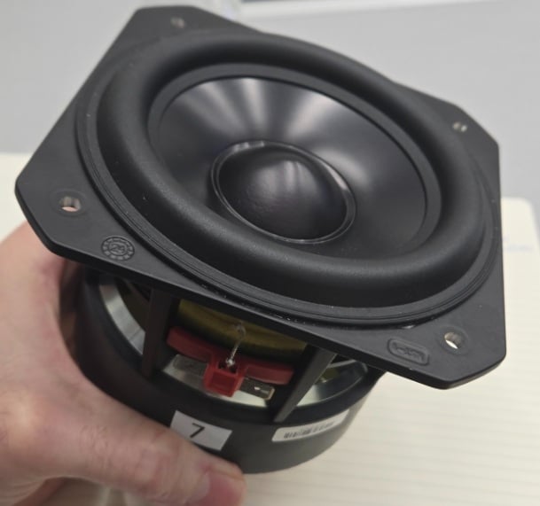

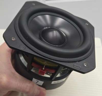

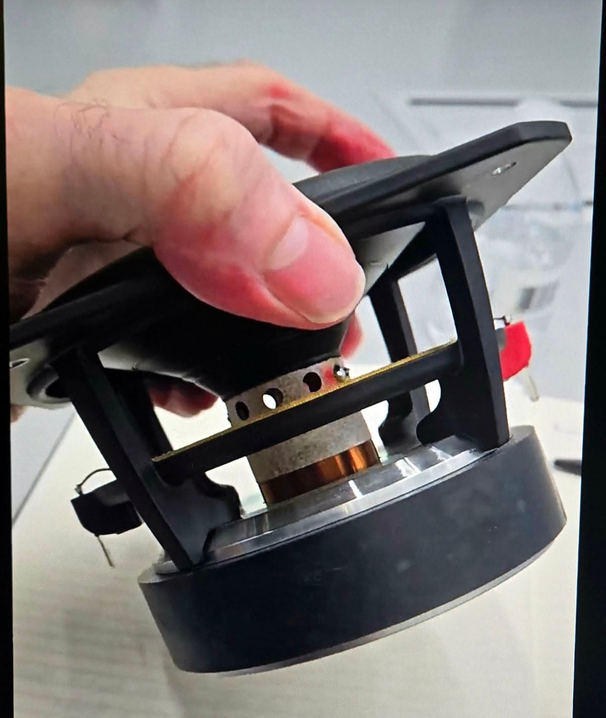

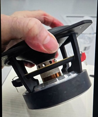

Gene with midrange driverThe Primacy drivers benefit from Klippel-based dynamic motor analysis, ensuring linear performance and reduced distortion. The drivers are mechanically decoupled from the speakers’ baffles, minimizing vibration transfer and improving clarity. It’s a holistic approach — one where each element supports the next. The use of neodymium in the tweeter contributes to efficiency and dynamic capability. The 1-inch tweeter used in both the S3 and T6 features a light, rigid, and well-damped thin-ply carbon-fiber diaphragm with a very powerful neodymium motor structure. It also uses a two-layer voice coil wound on a titanium former, and operates within a symmetrical drive motor structure with flux stabilization. A non-resonant aluminum chamber encloses the rear of the tweeter, providing a consistent and predictable environment for the tweeter’s operation.
A 5.5-inch polypropylene cone driver serves as a dedicated midrange driver in the T6 and as a mid-woofer in the S3. This driver uses a lightweight, mineral-filled polypropylene cone and dust cap, and a synthetic rubber surround structure with integral sealing and isolation elements molded into the surround. A Nomex/poly/cotton progressive roll spider with integrally-woven lead wires forms the rear suspension. A two-layer, bifilar copper voice coil is wound onto a polyimide (Kapton) former with a spun lace wrap. The motor uses a strontium-ferrite single stack ring magnet. To enhance rigidity and frequency response, the geometry of the cone was carefully considered. It has a single radius with a single step, and a lightweight support structure attached to the back of the cone. The T6 also uses four dedicated 5.5-inch woofers for an equivalent surface area of a very powerful 11" bass driver. These employ lightweight, yet rigid aluminum-alloy cones and dust caps. The surround, spider, voice coil, and motor all share similar designs with the midrange driver.

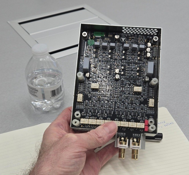

The Centerpiece Stereo component uses a powerful AKM triple-core 32-bit DSP for internal signal processing, operating at 192kHz. Analog audio inputs use individual stereo ESS SABRE 32-bit ADC chips for each channel, and the captured 192kHz resolution is maintained throughout the system, even with P.A.R.O. engaged. For the analog outputs (which are presumably necessary for adding subwoofers), individual stereo ESS SABRE 32-bit DAC chips are used, resulting in improved channel separation. Chips are wired in parallel, thus improving dynamic range and lowering the noise floor. What about lower-resolution digital signals? These are are upsampled to 32-bit/192kHz by a dedicated hardware asynchronous sample rate converter (ASRC). The USB audio input supports PCM files up to 384kHz, plus DSD 1x, 2x, and 4x. The HDMI eARC input supports stereo LPCM signals only, so make sure to select stereo PCM in your TV’s audio output settings.
