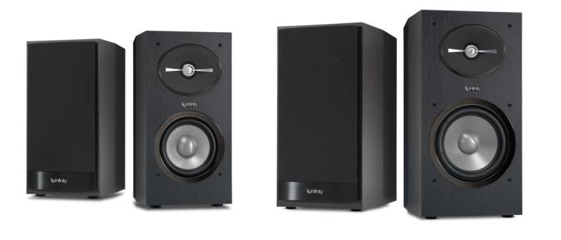

R152
- 2-way 5.25" (130mm) tuned port bookshelf loudspeakers
- Proprietary Ceramic Metal Matrix Diaphragm (CMMD) technology
- 5.25" (130mm) CMMD high-output woofer
- 1" (25mm) CMMD tweeter with advanced image control waveguide
- Frequency response: 60 Hz – 22 kHz
- Sensitivity: 87 dB
- Recommended amplifier power: 20–125 Watts
- Nominal impedance: 8 Ohms
- Dimensions H x W x D: 13-1/2" x 6-7/8" x 9-3/16" (343mm x 175mm x 233mm)
- Weight: 12.8lb (5.8Kg)
R162
- 2-way 6.5" (165mm) tuned port bookshelf loudspeakers
- 6.5" (165mm) CMMD high-output woofer
- Frequency response: 49 Hz – 22 kHz
- Sensitivity: 88 dB
- Recommended amplifier power: 20–150 Watts
- Dimensions H x W x D: 15-1/2" x 7-7/8" x 11-1/4" (394mm x 200mm x 285mm)
- Weight: 17.6lb (8.0Kg)

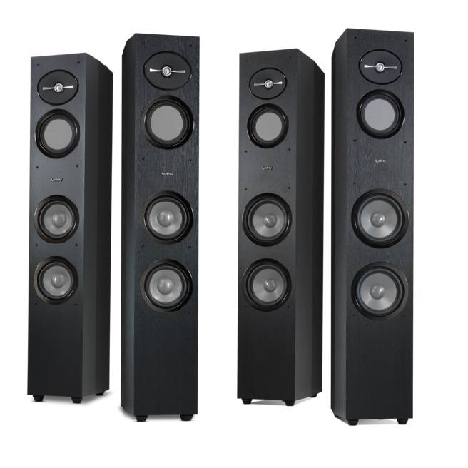

R253
- 3-way dual 5.25" (130mm) tuned port floor standing loudspeaker
- Dual 5.25" (130mm) CMMD high-output woofers
- 5.25" (130mm) CMMD low-diffraction midrange
- Frequency response: 41 Hz – 22 kHz
- Recommended amplifier power: 20–200 Watts
- Nominal impedance: 6 Ohms
- Dimensions H x W x D: 40-1/8" x 6-7/8" x 12-3/16" (1019mm x 175mm x 310mm)
- Weight: 39.2lb (17.8Kg)
R263
- 3-way dual 6.5" (165mm) tuned port floor standing loudspeaker
- Dual 6.5" (165mm) CMMD high-output woofers
- Frequency response: 38 Hz – 22 kHz
- Sensitivity: 89 dB
- Dimensions H x W x D: 44-13/16" x 7-7/8" x 14-1/2" (1138mm x 200mm x 368mm)
- Weight: 50.6lb (23.0Kg)

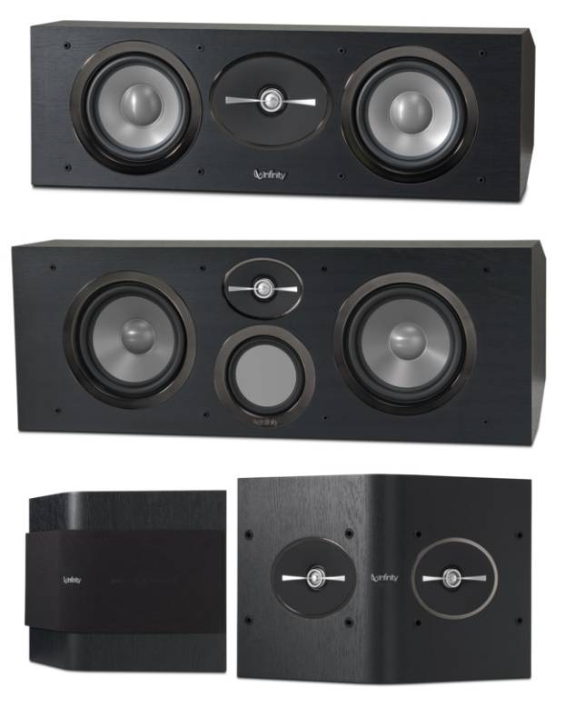

RC252
- 2.5-way dual 5.25" (130mm) sealed enclosure center channel loudspeaker
- Frequency response: 58 Hz – 22 kHz
- Dimensions H x W x D: 6-3/4" x 20-7/16" x 8-5/8" (171mm x 519mm x 219mm)
- Weight: 16.6lb (7.5Kg)
RC263
- 3-way dual 6.5" (165mm) sealed enclosure center channel loudspeaker
- 4" (100mm) CMMD low-diffraction midrange
- Frequency response: 52 Hz – 22 kHz
- Dimensions H x W x D: 9-1/16" x 25-3/16" x 10-5/8" (230mm x 639mm x 270mm)
- Weight: 29.4lb (13.3Kg)
RS152
- 2-way 5.25" (130mm) sealed enclosure on-wall surround loudspeaker
- Dual 1" (25mm) CMMD tweeters with advanced image control waveguides
- Frequency response: 62 Hz – 22 kHz
- Sensitivity: 90 dB
- Dimensions H x W x D: 10-1/8" x 15" x 7-7/8" (257mm x 381mm x 200mm)
- Weight: 11.1lb (5.0Kg)

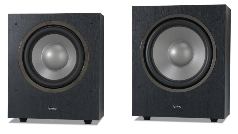

SUB R10
- 10" (250mm) tuned port powered subwoofer
- 200 Watt RMS/400 Watt dynamic digital power amplifier
- Proprietary Slipstream tuned-port technology
- 10" (250mm) fiber-composite high-output woofer
- Frequency response: 31 Hz – 150 Hz
- Variable crossover, level and phase controls
- 3-position LF trim level boost
- RCA phono jack line-level inputs
- Dimensions H x W x D: 16-5/8" x 14-5/32" x 15-3/4" (422mm x 360mm x 400mm)
- Weight: 34.6lb (15.7Kg)
SUB R12
- 12" (300mm) tuned port powered subwoofer
- 300 Watt RMS/600 Watt dynamic digital power amplifier
- 12" (300mm) fiber-composite high-output woofer
- Frequency response: 29 Hz – 150 Hz
- Dimensions H x W x D: 18-3/4" x 15-5/32" x 16-3/4" (476mm x 385mm x 426mm)
- Weight: 40.2lb (18.2Kg)

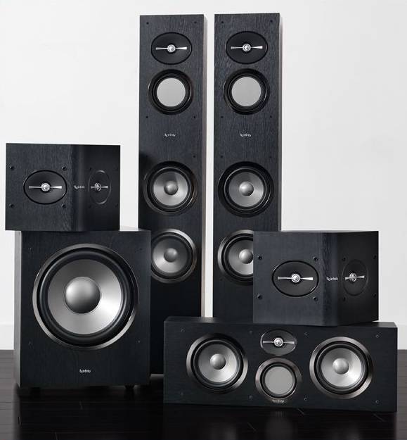

Well it seems that Harman is finally ready to make a significant move back into the home audio segment with the eminent release of the new Infinity Reference series loudspeakers. The new lineup consists of two models each of tower, bookshelf, and center channel speakers, a surround model, and a pair of subwoofers. All of the new models host a number of features from Infinity’s research and development efforts, with a mix of both tried and new technology.

The Infinity Reference R152 (left) and R162 (right) bookshelf speakers.
Starting with the bookshelf models, the R152 and R 162 are both two-way ported designs each with a 1 inch dome tweeter mated to a 5 ¼ inch and 6 ½ inch mid/woofer, respectively. The R253 and R263 towers are both three-way designs featuring a 1 inch CMMD dome tweeter and a 5 ¼ inch flat piston midrange that is housed in an acoustically isolated chamber. Both towers also have dual woofers, but differ with 5 ¼ inch woofers in the smaller tower and 6 ½ inch woofers used in the larger tower that are also constructed using Infinity’s CMMD as a diaphragm material.
The Infinity Reference R253 (left) and R263 (right) tower speakers.
The center channel offerings are split between a two-way and a three-way design. The two-way RC252 uses a 1 inch CMMD dome tweeter flanked by a pair of 5 ¼ inch CMMD woofers. The three-way RC263 also uses the 1 inch CMMD dome tweeter stacked above a 4 inch version of the flat piston midrange found in the towers, isolated in its own chamber and flanked with 6 ½ CMMD woofers. Both center speakers use a sealed enclosure design for easier placement against flat surfaces such as against an HDTV bezel.
The Infinity Reference RC252 (top) and RC263 (middle) center speakers, along with the RS152 surround speaker.
The surround speaker, the RS152, is a sealed enclosure two-way speaker design. The wide shaped cabinet has drivers on three sides, a pair of 1 inch CMMD dome tweeters on each of the forward facing angled cabinet walls and a 5 ¼ inch rear firing woofer on the back face at a specifically positioned distance from the supporting wall. Infinity refers to the configuration as Hemispherical Soundfield Technology (HST) which they say provides very even frequency response coverage over a 180 degree listening area, thus creating a speaker with flexible placement options that should have minimal effect on the speaker’s acoustic performance.
The powered subwoofer offerings come in 10 inch and 12 inch flavors, the SUB R10 and SUB R12, utilizing tuned port enclosures with 200 watt and 300 watt RMS class D digital amplifiers, respectively. Power output specifications for the amplifiers shows a doubling to 400 watts and 600 watts under short term dynamic conditions. The driver diaphragms used for the subs are made from an unspecified fiber composite material, which is likely some form of a fiber reinforced variant of the CMMD material used throughout the line. The cabinet is said to consist of 0.75" walls, with edge-to-edge windowpane bracing utilized to stiffen the enclosure. Controls for the subwoofer amplifiers included the standard adjustable level output, crossover frequency, and phase along with auto on/off sensing and a LF trim control that allows up to a 4 dB boost at 35 Hz. I am assuming that there is a trim frequency associated with the LF trim control, but it is not specified in the literature that Infinity provided.
The Infinity Reference R10 (left) and R12 (right) subwoofers.
