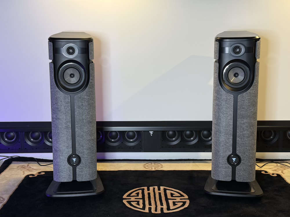

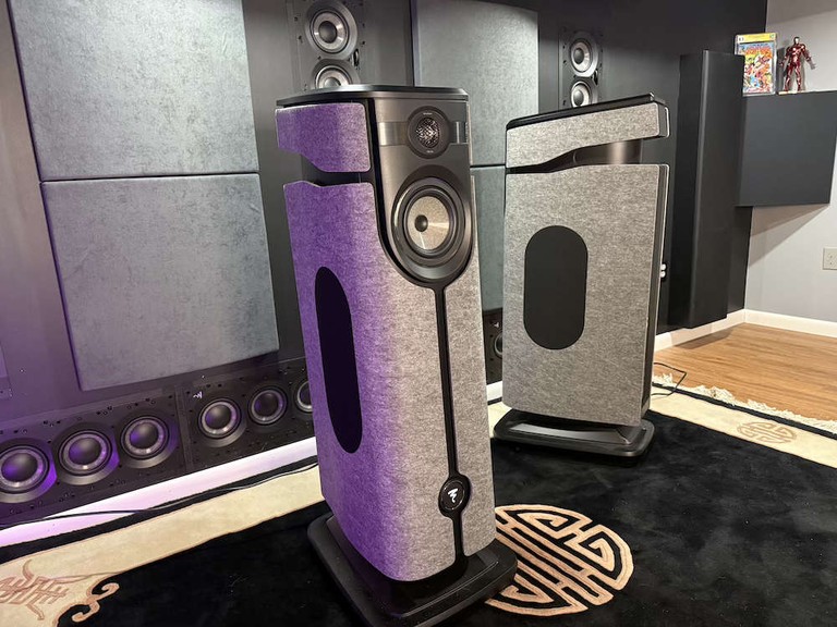

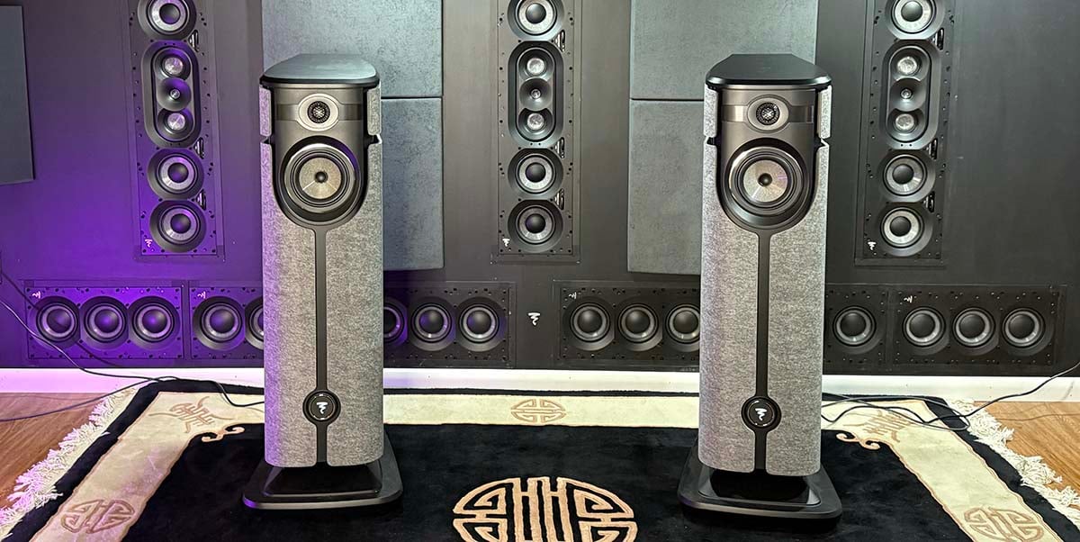

At first glance, Diva Utopia looks every bit a Utopia. It’s a three‑way floor-stander whose silhouette echoes the Utopia family design; think of it as a shorter, slimmer sibling to the Scala Utopia Evo, which I reviewed in 2024. The cabinet sits on concealed wheels (spikes and hardwood floor protectors included) and exudes the kind of industrial refinement you would expect from Focal.
Focal Diva Utopia
Focal Diva Utopia Active Loudspeaker

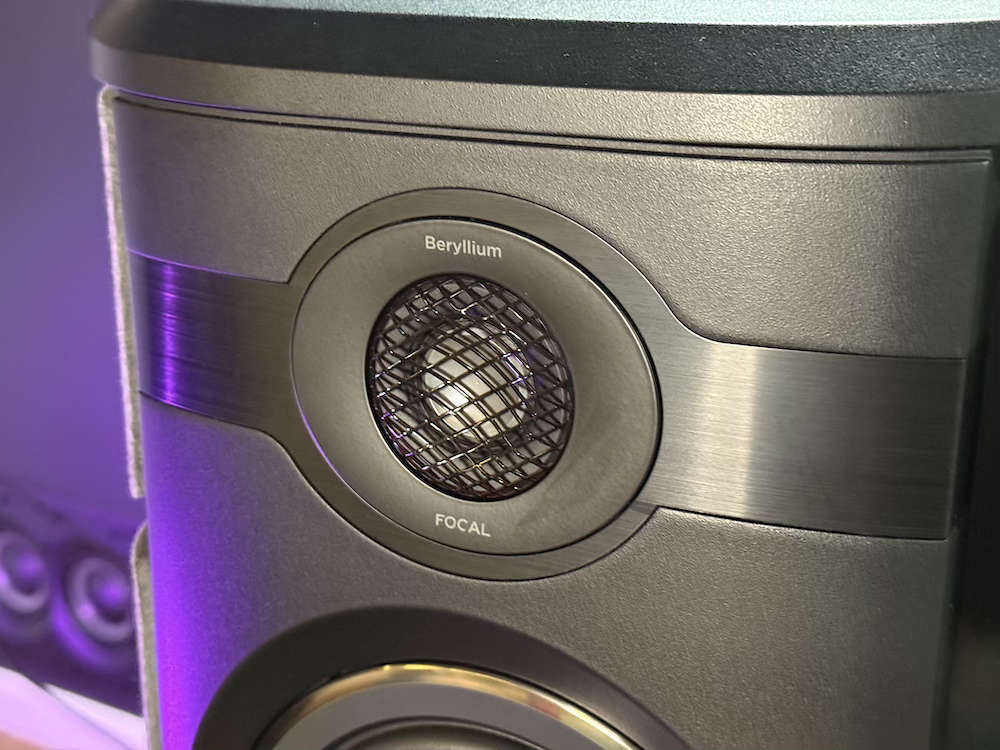

IAL2 Tweeter: Diva Utopia was the first Focal speaker to debut the IAL2 second‑generation pure beryllium tweeter, a 1 5/8‑inch M‑profile inverted dome with breakup well past 40 kHz. The Diva's larger sibling, the more powerful Diva Mezza Utopia, also sports the IAL2 Tweeter. In practice, this tweeter delivers everything a beryllium tweeter should: Exceptional rigidity, lightning fast transients, and extended highs with low distortion. In my room, the top end was effortless, airy, and non‑fatiguing — reaffirming why beryllium remains my reference choice at this level.
Diva Beryllium Tweeter
Detail of the Focal Diva Utopia IAL2 Beryllium Tweeter

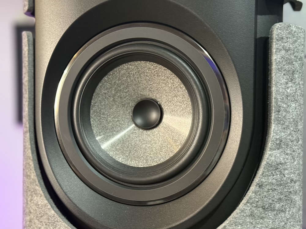

Midrange Driver: The Diva has a 6.5‑inch W‑sandwich composite mid‑bass driver. Focal’s W cones sandwich one or more glass fiber skins around a structural foam core, delivering a balance of lightness, rigidity, and self‑damping. This tech is central to the Utopia line’s low coloration and transient speed.
Diva Midbass Driver

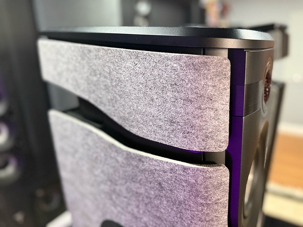

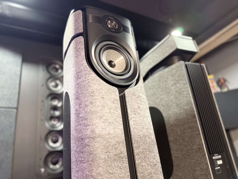

Visually, Diva stands apart with interchangeable side panels. The standard felt panels (a heathered‑gray, OEKO‑TEX®‑certified fabric) are floating/removable and purely aesthetic, without any acoustical impact on the speaker. While some Internet trolls early on poked fun at the fabric panels as “cat scratching posts,” in person the panels look gorgeous and are incredibly practical: I appreciated handling the speaker without worrying about marring a piano‑gloss finish with a ring or accidental bump.
Diva Panel
Detail view of the Diva's heathered‑gray, OEKO‑TEX®‑certified fabric

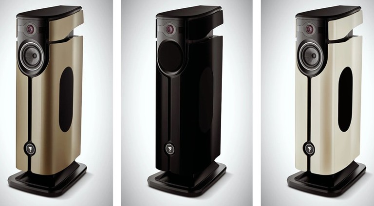

Focal has since added Black High Gloss, Dune High Gloss, and Off‑White High Gloss panel options. Dune shimmers with gold/silver highlights; Off‑White has a silky, modern sheen. The optional panel sets retail for $9,500 and are available at Focal powered by Naim stores. They can be swapped anytime to suit interior design changes — and they add a dose of real‑world serviceability should a panel get dinged.

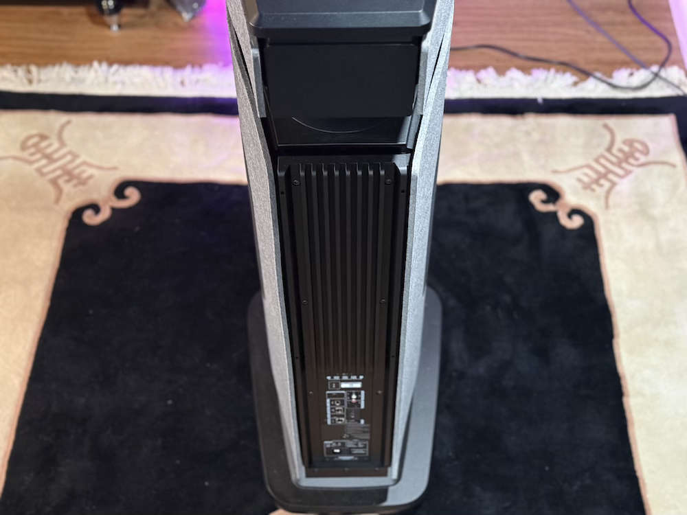

Under the hood, Diva Utopia is fully active: It features a preamplifier (with analog/digital inputs), network streamer, and amplification are all built in. There’s nothing else to buy to start listening.
Amplification is by Naim, with power specifically optimized for each driver: 75 W RMS to the tweeter, 75 W RMS to the midrange, and two 125 W RMS (250 W total) channels dedicated to bass. Anodized aluminum heatsinks integrated into the rear of the cabinet dissipate any waste heat from the Class AB amps.  Focal was sensitive to its audiophile heritage and audiophile leanings of its target customer. Therefore Focal chose to eschew any Class D amplification. Crossovers are active too, optimizing driver integration and dynamic headroom.
Aluminum Head Sink on the Diva
Detail of the Aluminum heat sink on the Diva's rear to dissipate heat from the Class AB amps and electronics
Serviceability is key to any purchase. What makes the Diva Utopia unique is that the entire electronics module slides out for rapid replacement or servicing. If anything ever fails, you don’t ship a 141‑pound cabinet — the module swaps in minutes. That’s a big deal at this level.

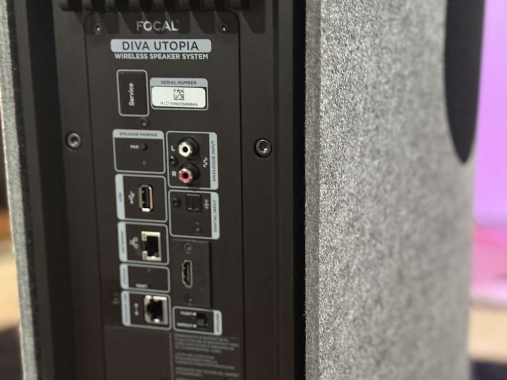

Inputs include HDMI eARC with CEC, Toslink, USB 2.0, and unbalanced analog (e.g., for a turntable with appropriate gain/EQ in the chain). Focal/Naim’s Dynamic Loudness setting maintains consistent tonal balance across volume. It gradually tapers as SPL increases and is effectively suppressed beyond the 50% volume marker. You can toggle it in the mobile app.
Note: Because the Diva Utopia is envisioned as a complete, two channel, full‑range system subwoofer integration is not supported.
Ports on the Diva Utopia

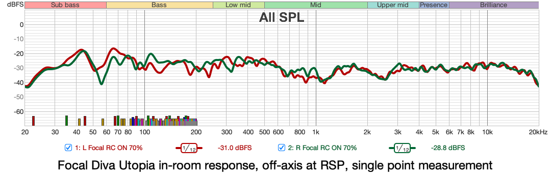

Each Diva Utopia weighs 141 pounds, so I focused my measurements on in‑room frequency response at the Reference Seating Position (RSP) and the specific impact of ADAPT. I set up the Diva Utopia with slight toe‑in toward the RSP and the tweeters approximately three feet from the back wall. My long‑running experience with Focal’s beryllium tweeters — as seen in my measurements of the Focal 1000 Utopia and Scala Utopia — is that on‑axis anechoic traces often show a mild rise approaching 20 kHz, but in‑room that flattens nicely with appropriate placement and listening window integration. That’s exactly what I observed here.
With ADAPT at 70% (the default), left/right speaker tracking in my room was excellent, and the overall in‑room balance was very linear with a slight rise in the low end, delivering a good in-room response. All measurements are at 1/12 smoothing.
Focal Diva Utopia in-room RSP measurements
Measurements of the left (red trace) and right (green trace) Focal Diva Utopia, toed in, at the RSP, with ADAPT at the default 70%

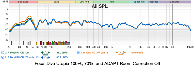

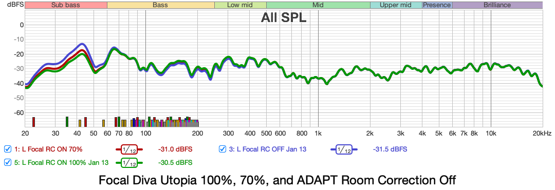

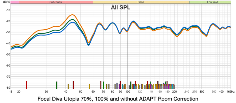

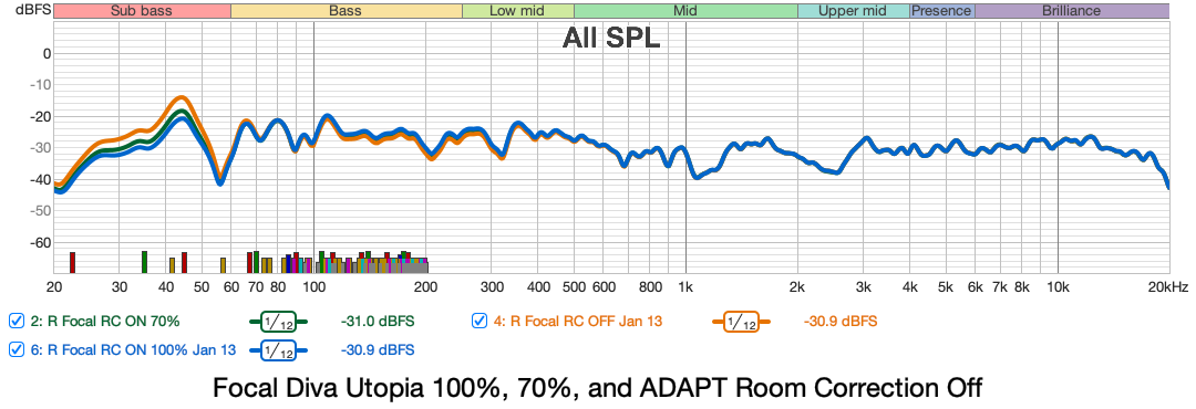

Let's see the impact of ADAPT on the Diva Utopia's in-room response at the RSP.  Here are measurements of the left and right speakers with ADAPT disengaged, at 70%, and 100%. Disregard the dip between 50Hz-60Hz as it is a room mode. Notice that ADAPT's affect in-room is subtle, but effective where it matters most.  This performance reminded me of the Scala Utopia's attenuation jumpers.
Diva Utopia LEFT with ADAPT
Single point measurement of the Focal Diva Utopia's in-room response (Left Speaker) measured at the RSP with and without ADAPT engaged.
Blue is ADAPT off, Red with ADAPT at 70%, and green with ADAPT at 100%.
Focal Diva Utopia RIGHT speaker with ADAPT
Single point measurement of the Focal Diva Utopia's in-room response (Right Speaker) measured at the RSP with and without ADAPT engaged.
Orange is ADAPT off, Green with ADAPT at 70%, and Blue with ADAPT at 100%.
As you can see, switching ADAPT off versus 70% and then 100% show's Focal's non‑destructive tuning philosophy: ADAPT tames excess bass without crushing system dynamics or affecting the tweeter's top end air. If your taste leans warmer or leaner, ADAPT’s ±10 steps provide flexibility to suite your taste.

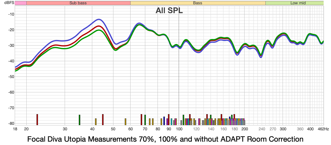

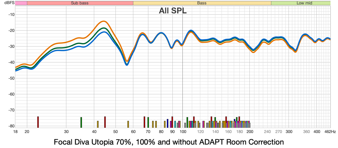

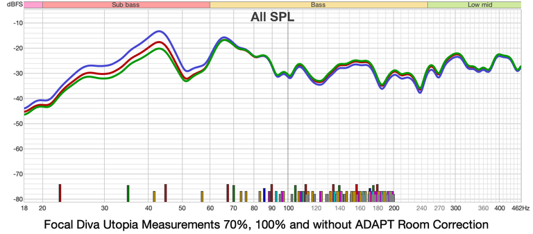

Here’s a zoomed in look at what ADAPT did to the Diva Utopia left and right speakers' low end frequency response in my room measured at the RSP.
Detail: Focal Diva Utopia LEFT with ADAPT
Detail of the Focal Diva Utopia's ADAPT on the left speaker at the RSP. Blue is ADAPT Off, Red is ADAPT at 70%, and Green is ADAPT at 100%.
Detail RIGHT: Focal Diva Utopia with ADAPT
Detail of the Focal Diva Utopia's ADAPT on the right speaker at the RSP. Orange is ADAPT Off, Green is ADAPT at 70%, Blue is ADAPT at 100%.

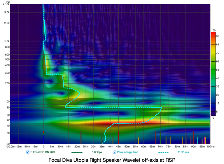

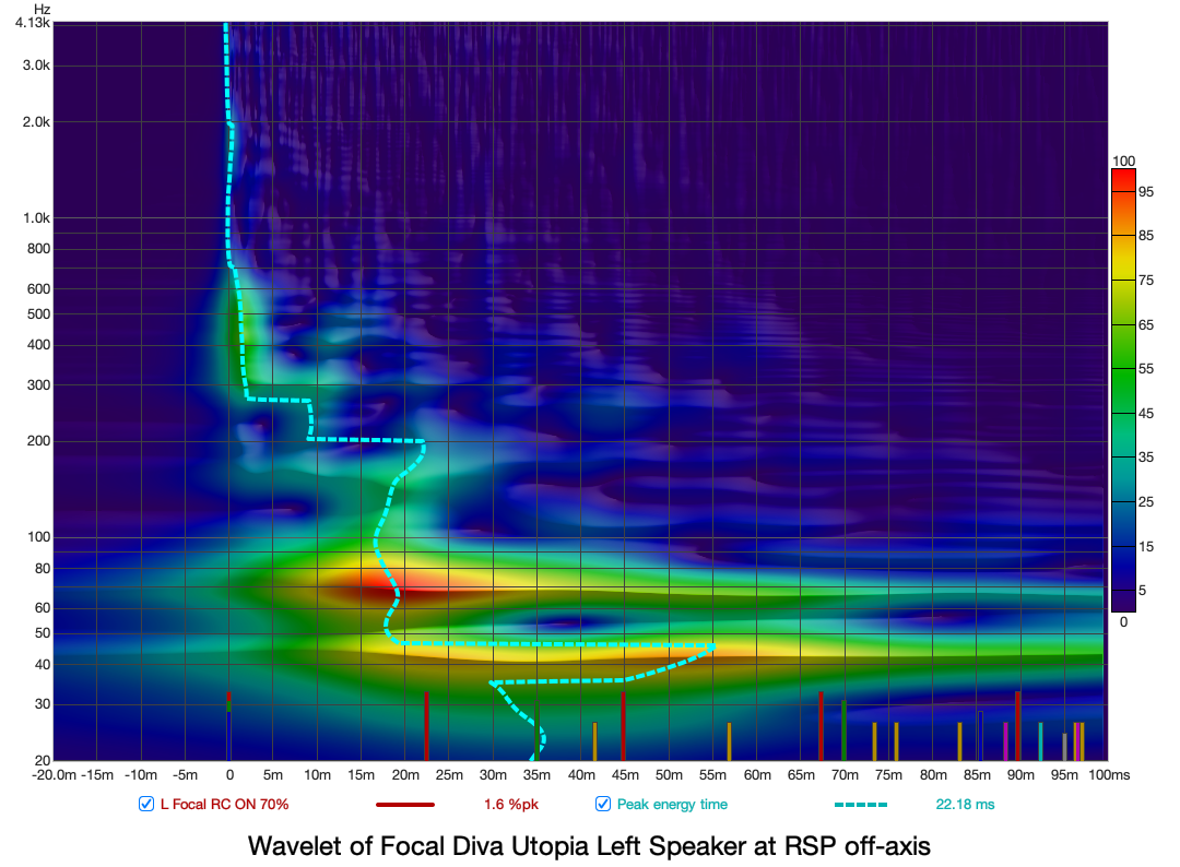

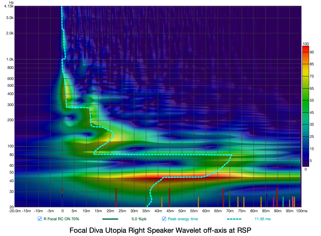

Wavelets of the Diva Utopia at the RSP highlight differences between ADAPT’s approach and something more sophisticated like Dirac ART.
L Wavelet Focal Diva Utopia
Wavelet of the Focal Diva Utopia left speaker.  In-room response at the RSP, single point measurement with ADAPT at 70%
R Wavelet Focal Diva Utopia
Wavelet of the Focal Diva Utopia right speaker.  In-room response at the RSP, single point measurement with ADAPT at 70%
Dirac ART, by comparison, yielded almost textbook perfect performance on my Focal 1000 Utopia theater with RBH subwoofers driven by a Focal Astral 16 with Dirac ART. The bass response below 150Hz is totally linear and the wavelet is textbook. See my measuremens of the Focal 1000 Utopia for more information.
The Diva Utopia, being a two‑channel system with no sub integration and a minimalist correction philosophy, can’t (and isn’t trying to) replicate the spatial control of ART with it’s approach to bass management. Even so, both with and without ADAPT, Diva measured cleanly and performed exceedingly well in my room.

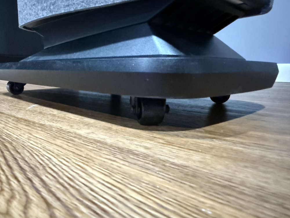

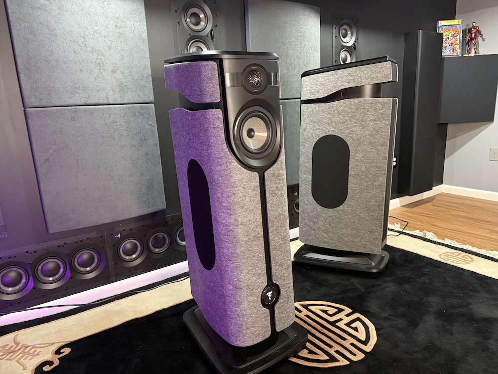

Focal makes unboxing and placement painless. Each carton includes a plywood ramp. Combined with built‑in wheels, rolling a 141‑pound Diva Utopia into position is effortless. After dialing in placement, thread on the included spikes and use the hardwood floor protectors as needed.
For my installation, I set the Diva Utopia in a known sweet spot with the tweeters approximately three feet from the front wall, flanking a 125‑inch Stewart Filmscreen StudioTek 130 G4 acoustically transparent screen, where I have dedicated 20‑amp outlets on each side.  This made the setup visually minimalist.
Focal Diva Wheels
Setup in the Focal‑Naim app was super easy: plug in the Diva Utopias, join a wireless network (or connect via Ethernet), and follow the prompts and finally run ADAPT. After 13 years of covering room correction and producing tutorials, I’ve seen advanced systems (Dirac, ARC, Audyssey) deliver astonishing results — but I’ve also seen users make common mistakes in mic placement, level setting, or target curves that derail outcomes. ADAPT trades that ultimate granularity for simplicity and effectiveness — an alluring option for custom installers and any prospective buyer of a two‑channel lifestyle‑reference speaker.

Focal offers lacquered finishes for the Diva Utopia: Dune High Gloss, Black High Gloss, and Off White High Gloss
