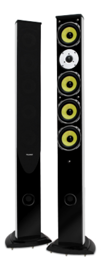

Fluance driverWith its quad 5-inch woofers and 1-inch silk dome tweeter covering the top half of the loudspeaker, the 51-inch tall Fluance ES1 tower speaker system is anything but vertically challenged.  Bordering anorexia, the ES1 is sensitive and colorful but stays surprisingly composed for a $449 pair of pillar loudspeakers.  With an interesting variety of loudspeakers offered, Fluance ES1’s design diverges significantly from the form of other Fluance offerings such as their XL7F towers.
The 15-year-old Canadian based company offers a 30-day satisfaction guarantee and a lifetime warranty on all of their passive loudspeakers.  After examination of their build quality and attention to detail, it is evident that offering a lifetime warranty is a low risk proposition for Fluance.  One thing is clear; Fluance has selected a market segment and builds quality loudspeakers at value prices relative to the components used.  While build quality is important, the subjective value of sound quality is often the deciding factor for many consumers.  Fluance considers the ES1 “Higher Fidelity” loudspeakers.  We will do our best to objectively and subjectively interpret this statement.

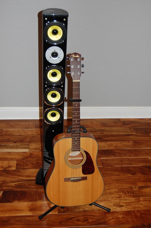

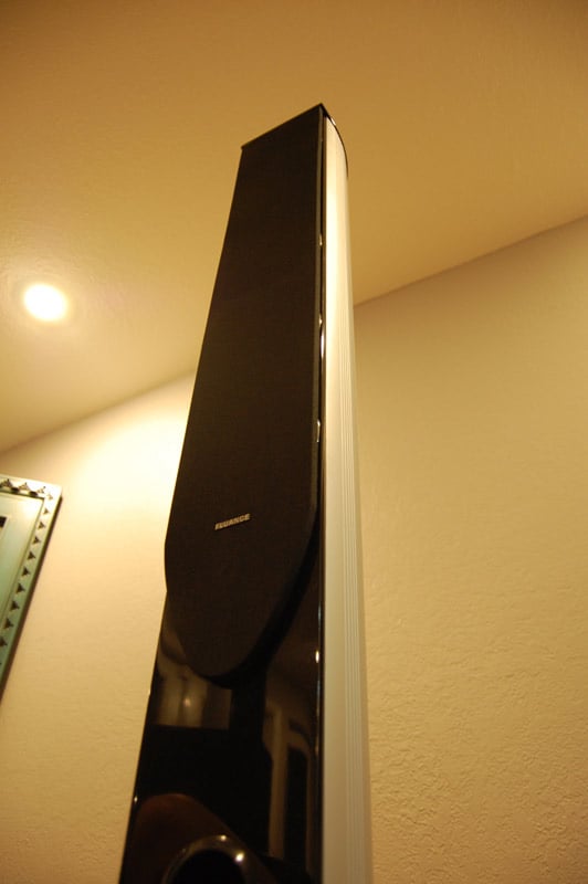

 Initially, I was very curious about the guts of the ES1 cabinet.  Specifically, I wanted to know where the extra weight came from as we are dealing with an extruded aluminum enclosure with a medium density fiberboard baffle. At 31.9 pounds, the ES1 is hardly a heavyweight but it seemed heavier than expected having experience with extruded aluminum.  I removed one of the four mid-bass drivers exposing the inside of the extruded aluminum cabinet and it was clad with vertical strips of medium density fiberboard attached to the sides and back of the extruded aluminum.  Manufacturing curved cabinets in wood products is very time consuming and expensive.  Fluance has come up with an inexpensive method to manufacture curved cabinets in aluminum using fiberboard to modify the resonant properties of the cabinet.  The cabinet is not free of resonance, but the presence of the composite material definitely helps.  It is advantageous to design a loudspeaker cabinet that is curved inside because it reduces standing waves and re-radiation of the speakers back wave through the speaker cone.  Since the ES1 is composed of flat fiberboard panels, these benefits are not fully realized .  However, the curved structure does increase the strength of the cabinet and is aesthetically pleasing.
This loudspeaker is exceedingly thin and tall.  They look pretty unobtrusive next to a flat panel television and fit in well with the look of modern electronics.  Due to the height, footprint and relatively low weight of the loudspeaker, the ES1 is extremely prone to tipping if bumped on either hard floors or carpet.  This speaker is absolutely not compatible with toddlers without further consideration.  The ES1’s center of gravity is slightly forward from the speaker’s centerline making it easier to tip forward than any other direction.  Each speaker sports 5 quality gold plated floor spikes that do what they can to stabilize the speaker but a wider base or outriggers would be helpful here.

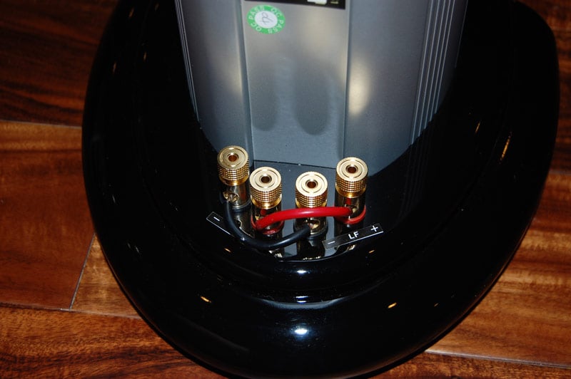

The ES1 has the highest quality 5-way binding posts I have ever seen in this price range.  The loudspeaker supports bi-amplification via 4 binding posts.  The jumper wires between the low frequency and high frequency inputs are large diameter and tinned.  Since the jumper wire occupies the bare wire connection, it is difficult to securely connect the tinned jumper wire and bare speaker wire in the same connection.  I simply made my own jumpers out of standard speaker cable when testing with the bare wire input.  The banana terminal inputs worked flawlessly and were much easier than messing with the bare wire terminal.  It is important to note that the attention to detail in the workmanship is second to none; even the solder joints were well executed.

The cabinet face, top and base plate are finished in a well-executed piano black.  The 4 yellow woven fiberglass mid-bass drivers and silver faced tweeter faceplate are readily visible against the black backdrop when the loudspeaker grills are off.  The grills are standard but attach to 5 chrome studs that add a nice touch when the grills are off.  The cabinet is ported to increase power handling and low frequency output.
Fluance ES1 Drivers

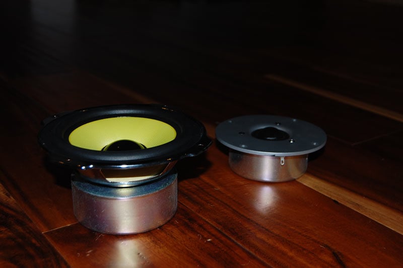

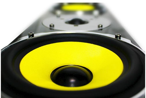

Four identical 5-inch yellow woven fiberglass mid-bass drivers ornament the front baffle of the ES1.  The mid-bass drivers are made from a stamped metal frame that is chromed to improve appearance.  All speakers in the ES1 are magnetically shielded.  The mid-bass driver quality is on par with what is expected at the low price these speakers are offered for.
ES1 Drivers
ES1 Mid-Woofer and Tweeter
The 1-inch ferro-fluid cooled silk dome tweeter is, in my opinion, the star of the ES1.  If the faceplate were made of metal instead of plastic, I could have easily been fooled into thinking it was a very expensive tweeter based on its build quality alone.  At this price point, most tweeters are 1/3rd the weight of the ES1’s tweeter.  While weight does not mean everything, the construction and design just look like something you would find on a much more expensive speaker.
Three mid-bass drivers are positioned below the tweeter and one above. The vertical array of mid-bass drivers is physically large and requires some distance for proper summing.  These are not speakers you want to sit a few feet from.

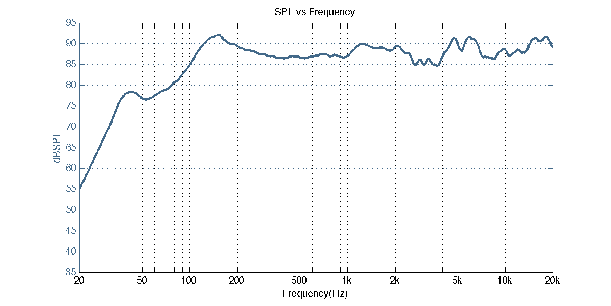

 Fluance ES1 On-Axis Frequency Response
The on-axis frequency response of the Fluance ES1 was conducted with the measurement microphone at 2 meters with a 2.83V excitation signal.  The results are scaled to 1 meter mathematically.  The manufacturer rates this loudspeaker’s sensitivity as 90dB at 1 meter with a 2.83V input according to their website or 86dB+/- 3dB according to the loudspeaker tag.  This discrepancy is likely attributed to measurement techniques or interpretation of results.  At some frequencies the ES1’s exceeded 90dB sensitivity however there is significant variability in the response of the speaker.  Audioholics measures sensitivity as the average sound pressure level (SPL) from 300 to 3kHz.  The ES1’s Audioholics rated sensitivity is decent at 87.6dB.  Listening tests clearly confirm a peak at approximately 150Hz as confirmed by the impedance peak at the same frequency.  This resonant peak is due to the enclosure volume and tuning configuration in conjunction with the mid-woofers resonant frequency (Fs).  This is a very high resonant frequency for a 5-inch mid-bass in a 2-way design.  The average high frequency output of the loudspeaker from the crossover at 3.5kHz to 20kHz is substantially higher than the average sensitivity from 300 to 3kHz contributing to the bright treble impression.  Since the loudspeaker can be bi-wired, it may be possible to add an L-pad attenuator to the tweeter if high frequency response is too forward.

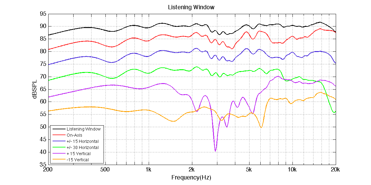

Fluance ES1 Listening Window
The listening window response for the ES1 was conducted with a 2.83V input signal at 2 meters from 7 locations.  The measurement provides a picture of how the loudspeaker performs from seating locations that are not directly on axis with the speaker.  The top curve is the average of the other positions and provides an average of how the speaker performs throughout the listening area.  The off-axis response within the listening window area is pretty uniform in the horizontal plane.  The 15 degrees vertical measurements have suck outs due to lobing error based on the driver arrangement.

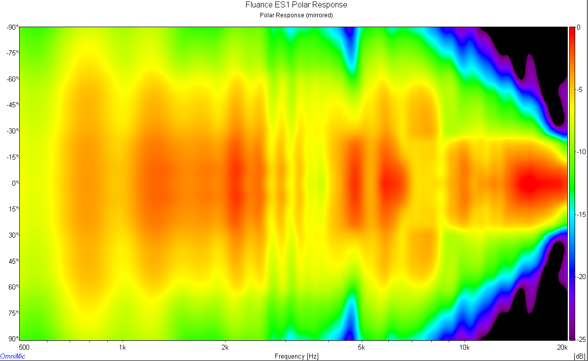

Fluance ES1 Polar Response
The polar response graph shows how a loudspeaker performs at various angles.  The polar response graph above is generated by measuring a loudspeaker at 7.5 degree intervals around a circle on the tweeter axis from 2 meters.  The Fluance ES1 has excellent polar response from 0-60 degrees.  The color variations at given angles versus frequency are solely due to the uneven frequency response and are not due to changes in off-axis performance.

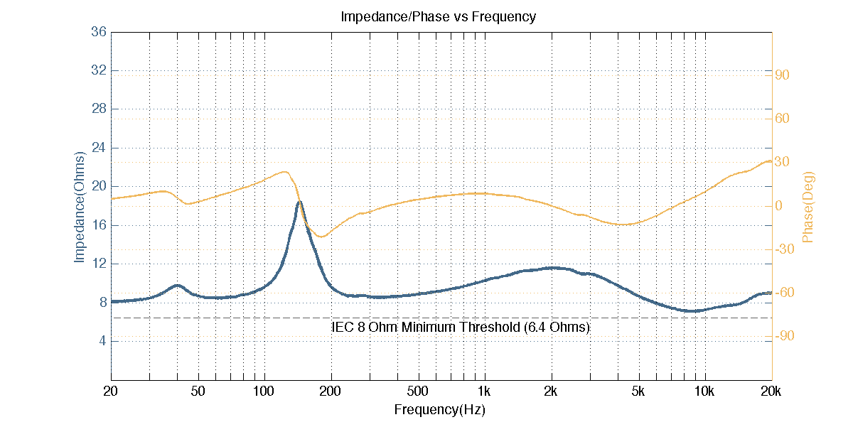

Fluance ES1 Impedance
The impedance of the Fluance ES1 remains above the IEC 8 ohm minimum threshold of 6.4 Ohms throughout the entire audio band.  At approximately 9kHz, the loudspeaker reaches a minimum impedance just below 7 ohms.  This loudspeaker represents an easy load for the majority of amplifiers on the market.  Due to relatively high sensitivity, a 100-watt amplifier is a good match to drive this loudspeaker to very loud volumes.

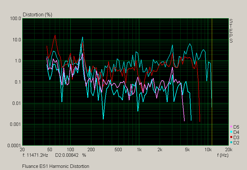

Fluance ES1 Harmonic Distortion
The harmonic distortion graph was generated using a 90dB stepped sinusoid sweep measured at 2 meters.  The above harmonic distortion is marginal with 3rd order distortion products reaching over 2% in the high frequencies.  This may be attributed to cabinet resonance issues.

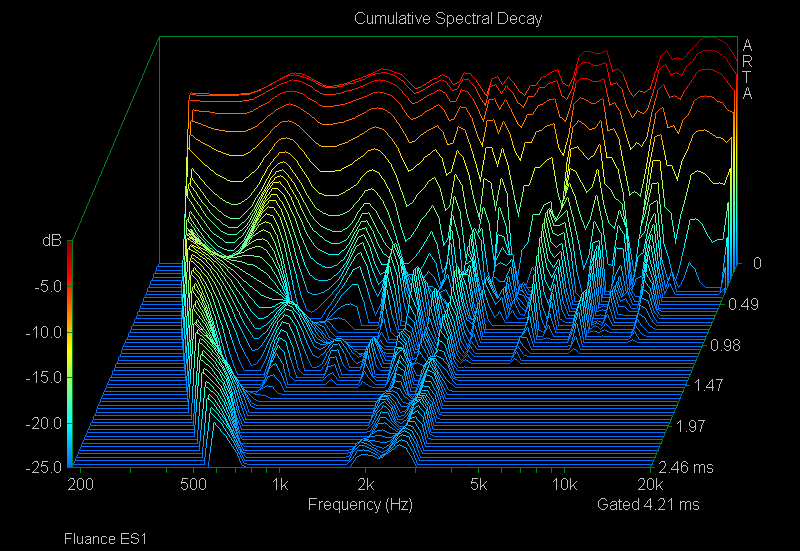

Fluance ES1 CSD
Fluance ES1 Cumulative Spectral Decay
Cumulative spectral decay is derived from the impulse response measurement made with a 90dB excitation signal at 2 meters.  The cumulative spectral decay shows how sound at various frequencies dies out as a function of time.  It is important to note that the left most ridge is not valid and is a product of the measurement technique.  A strong ridge is noticed between 2kHz-3kHz and the subsequent harmonics.  Although the extruded aluminum cabinet is suspected, this measurement does not pinpoint the source.

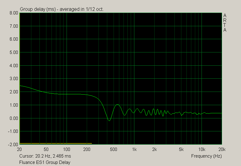

Fluance ES1 Group Delay
The group delay graph shows the rate of change of the slope of a loudspeaker’s phase.  As a rule of thumb, values below 1.6ms in the mid to high frequencies will likely not effect perception of sound quality.  Increasing group delay in the low frequencies is not as objectionable as it is in the mid to high frequency ranges.
