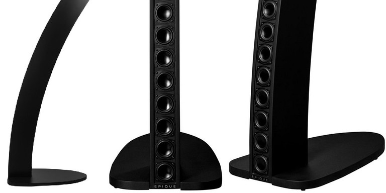

The CBT24 speakers can only be purchased from Parts-Express.com and so must be shipped to the buyer’s home. They come well-packed, which was particularly fortunate in my case since the exterior box showed signs of rough treatment during shipping. They come double-boxed and amply cushioned by thick foam packing pieces. The speakers are covered with thick cotton sleeves which should be enough to protect them from moisture and also scuffing from the foam.

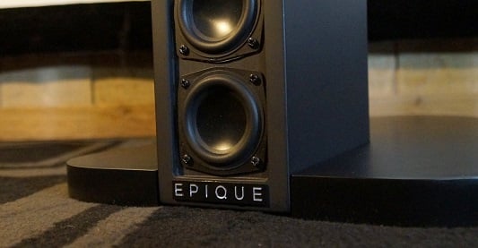

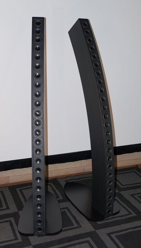

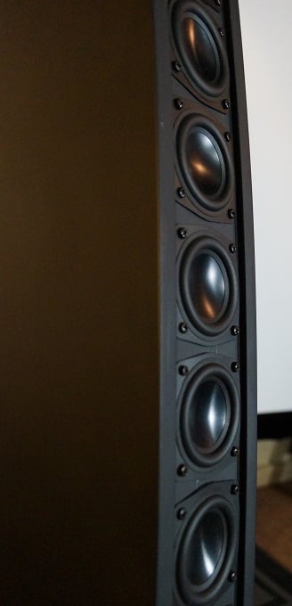

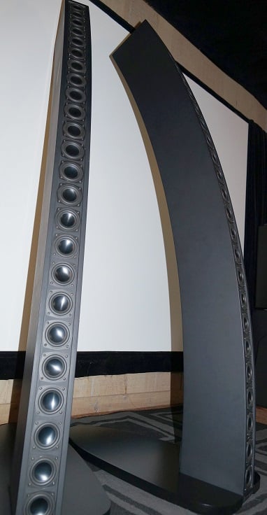

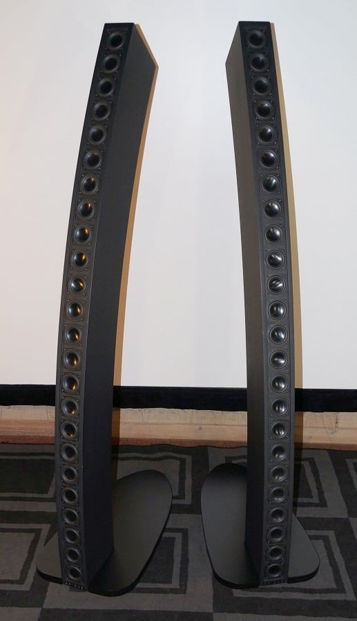

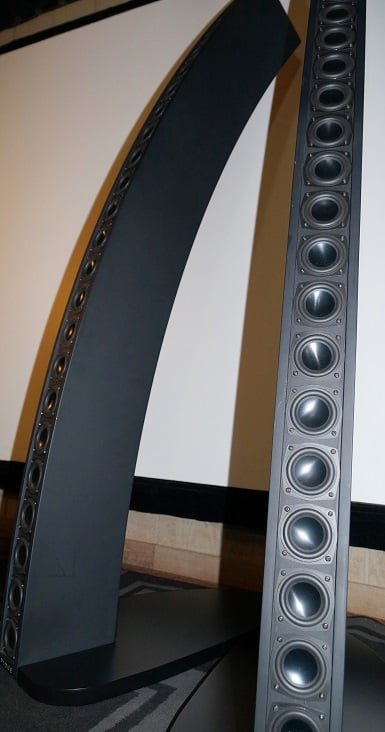

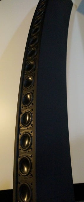

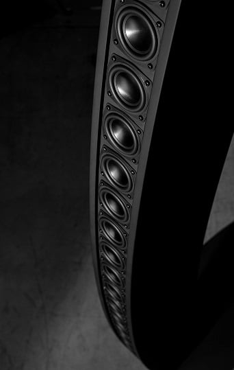

The Epique CBT24 speakers do not quite look like any other speaker. Their design is considered a curved line-array: a stack of 24 2.5” drivers fitted onto a narrow cabinet that arcs backward into a curve. Some people will think they look interesting, while they may be a bit too odd in appearance for others. I’m in the first camp; I think they look cool. They do not have a grille, so those who are turned off by the sight of exposed cones will not go for this look. The clean, back-leaning curve of the cabinets and rounded base gives them a futuristic vibe; organic, rounded shapes combined with the right-angle geometry of its edges. With their wide base and five-foot height, the CBT24 speakers are not going to disappear in a normal room.
The finished pair is only available in a smooth, almost satin black finish. It is slicker than matte black but it is not a shiny or deluxe finish. In a darkened room, this finish will allow the speakers to vanish. Indeed, I had trouble taking pictures without using the camera flash. There is also a kit form of the CBT24s available that does not come with a finish. Those who buy the kit form of the CBT24s have bare MDF to deal with and can apply any kind of finish they want- I think silver or white would look very nice for this design. There is a front-facing label on the base that spells EPIQUE in a stylized courier font. The bottom line regarding the CBT24 speaker’s appearance is that personal taste will play a heavy role in the decision to get a pair, since they look so unique. They will inevitably be a conversation piece as much as a loudspeaker.

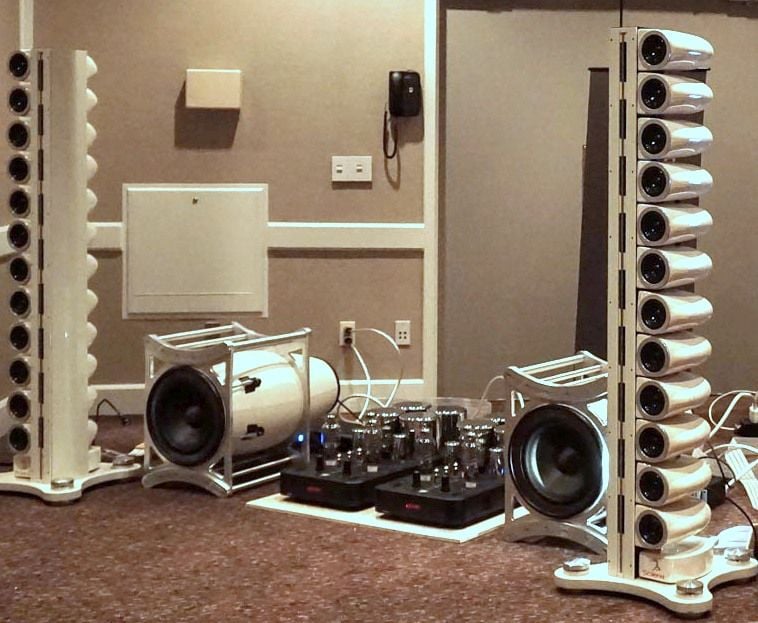

An example of conventional line array speakers
Although CBT speakers are considered line array speakers, they are not traditional line arrays at all; there are some major differences. Before we talk about the differences of CBT designs with respect to conventional line arrays, let’s briefly talk about normal line arrays. Conventional line arrays are completely vertical stacks of identical drivers that all play at the same amplitude level. This design has its advantages. A typical line array will project sound with a narrow vertical angle but a wide horizontal angle, which means that the sound field will encompass a wide listening area but not be affected by acoustic reflections from the ceiling and floor as much. Another advantage is that the apparent loudness does not change as much with distance with respect to most other speaker designs; the sound pressure levels fall off at half the rate per doubling of distance (3dB/DD) versus a normal speaker (6dB/DD), so as you move closer or farther from a line array speaker, it does not change in loudness as much.
One more advantage is that line arrays typically have enormous dynamic range because of all the drivers used in its construction. A speaker that has 40 tweeters and 20 midrange drivers will naturally be far more capable than a speaker with 1 tweeter and 2 midranges. Furthermore, unlike most high dynamic range speakers, line arrays can have a very wide dispersion, since the driver diameters are usually small and their output is not narrowly directed by a waveguide. Most high-dynamic-range speakers use horns or some kind of waveguide to constrict the acoustic power of the speaker to a relatively narrow area of sound. A line-array can have a similarly huge dynamic range but outputs its acoustic power over a far wider horizontal angle, so they have all the power but without the relatively small sweet spot that horn-loaded speakers can often have.
Curved CBT speakers, and by extension the Dayton Audio CBT24s, retain some of the advantages of traditional line array speakers but also have some very important differences. The most obvious difference is the curved shape of the cabinet. The curve is a constant circular arc that forms a part of a circle around a distant axis in the rear of the speaker. In taking this shape, the CBT24 blends aspects of line arrays speakers and conventional point source speakers. As opposed to conventional speakers, line array speakers emit sound as though it were coming from a two-dimensional line rather than a one-dimensional point. The jargon for these different shapes of sound emission sources is ‘line source’ and ‘point source.’ Line source emission have many of the traits described in the above paragraph: narrow vertical sound dispersion, wide horizontal dispersion, and a lower loss of sound intensity for increases in distance. The CBT24 speakers use a line array form but curved around an imaginary point on the ground plane in the distant rear of the speaker, so it has traits of both line source speakers and point source speakers. In a certain sense, it has the advantages of both without the disadvantages of either.

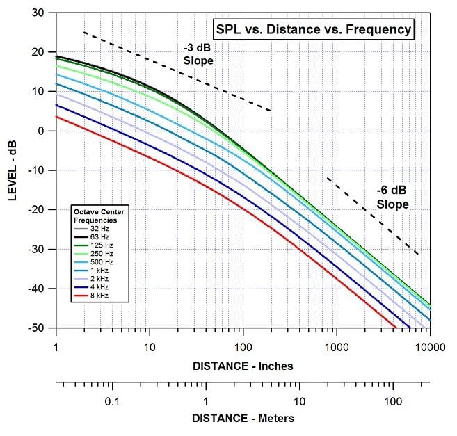

CBT speakers have the wide horizontal dispersion, narrow vertical dispersion, and enormous power handling of conventional line arrays. One feature of CBT speaker design is that, the higher you listen to the speaker up to the cabinet’s highest point, the less the SPL will change from distance. At standing height let's say about 5 feet, you can walk back and forth from the CBT24 speakers to a distance of a few meters and experience almost no change in loudness. This is as opposed to the -3dB change in amplitude per doubling of distance of line arrays and -6 dB per doubling of distance in conventional home audio speakers. This makes it a great choice for uniform loudness coverage out to roughly 10 feet, after which it does fall off at a -6 dB per doubling of distance. The lower height that you listen with respect to the height of the speaker, the more the fall off of loudness per distance gets to a -3 dB per doubling of distance.
Loudness variation with distance: how a CBT array’s loudness decays with distance from a height at top of the array. Images courtesy of Don Keele.
The uniform loudness with distance is one reason why the prominent acoustician, Dr. Floyd Toole, has advocated the CBT design for surround speakers. In many surround sound systems, most listening positions will be closer to one side of the surround speakers than the others. This means that surround sounds will be much louder for them on one side than the other, thereby weighing the surround soundstage to one direction and degrading the intended effect. But a speaker that does not change loudness with distance, as CBT designs can do (up to a point), will not inordinately weigh the surround sound to one direction or the other, even if the listener is much closer to one of CBT speakers than the other. Everyone gets to experience the surround sound as though they were in the center seat.
One other advantage of this quality of an unchanging amplitude and unchanging frequency response over distance is that CBT speakers are as much a near-field speaker as they are a far-field speaker. Most multi-way speakers need distance for the sound of each driver to integrate. A CBT speaker, on the other hand, will sound the same up close or at a distance. There will not be any tonal change of character no matter how far you are from them. Theoretically, they could be used as near-field monitors.

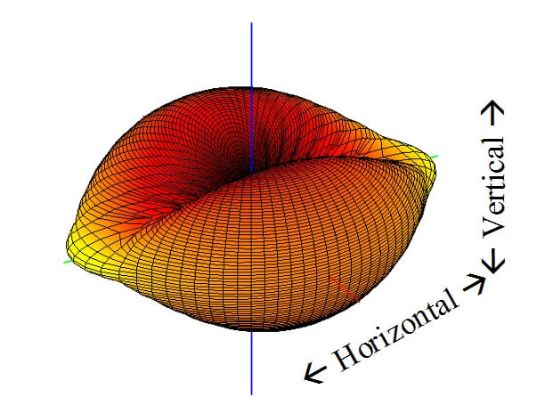

The CBT design’s most notable feature is in the acronym for which it is named: Constant Beamwidth Transducer, hence CBT. Let’s explain what ‘Constant Beamwidth Transducer’ means, and we will start with the phrase ‘Beamwidth’. In audio, beamwidth is the point that occurs off a speaker’s direct axis where the amplitude is halved (i.e. it has fallen by 6 dB). Most speaker designers try to get this to occur at the same distance for all frequencies. In other words, they don’t want the speaker’s off-axis sound to change at different frequencies. The more uniform a speaker behaves at all angles and distances, the more balanced and neutral it will sound. So a goal for high-fidelity speaker designers is to make a loudspeaker’s beamwidth remain invariant with frequency, i.e. constant. For those not steeped in audio, the last word in the CBT acronym, transducer, is just another name for speaker, in this case.
A 3D illustration of a CBT speaker’s dispersion pattern. CBT speakers hold this pattern at a very wide range of frequencies. Image courtesy of Done Keele.
The CBT design accomplishes constant beamwidth by arranging drivers on a circular arc surface and then attenuating some of the driver’s output by different levels according to a specific mathematical expression called a Legendre function. It was based off of naval research that looked into how underwater transducers could produce acoustic signals where the angle of the projected sound did not change with frequency. Audio scientist, Don Keele, tried to use this research to invent a new type of horn geometry for loudspeakers in the early 1980s but was not able to apply it to horns. He returned to it again in the late 1990s with the idea of applying it to line arrays where he found it could be successfully translated into a loudspeaker that had a highly uniform dispersion patterns, just like the original research suggested would work for an underwater spherical array. Mr. Keele continued to evolve the CBT design and has published many papers on it, some of which are posted on his website. For those who really want to hear about the inception and story about the design from the maestro in his own words, Mr. Keele has a 90 minute lecture on YouTube about the story of CBT design that he has called the CBT Chronicles.

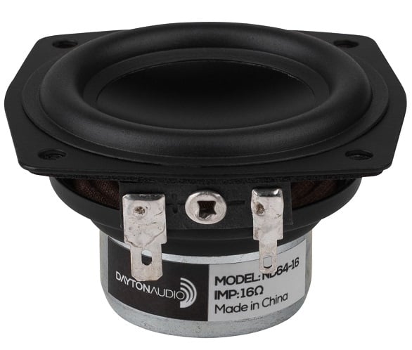

Dayton Audio ND64-16 driver. Image courtesy of Dayton Audio.
The above discussion of CBT speakers will all apply to the particular speakers under this review, the Dayton Audio CBT24 Epique speakers. CBT speakers can be made from multi-way systems, but this incarnation only uses one driver model, the Dayton Audio ND64-16, a 2.5” full range driver.
Don Keele mentions an interesting fact about the CBT24 and ND64-16 in personal correspondence.

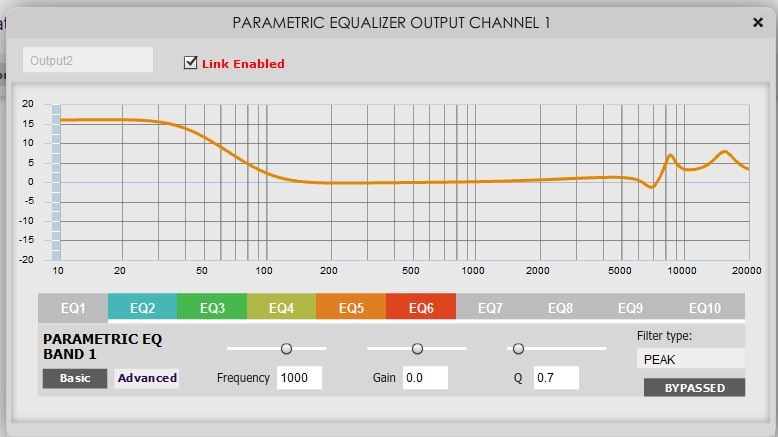

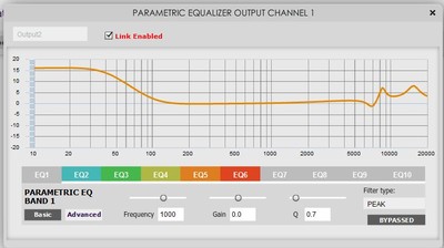

Dayton Audio recommends that the CBT24 speakers be used with an equalizer to flatten the response above 8 kHz. Their recommended equalizer is the MiniDSP 2x4 HD, and Dayton Audio has provided equalization curves for the MiniDSP 2x4 HD which help to flatten out the response. These files are available on the CBT24 product page.
MiniDSP EQ compensation file for flattened response on the CBT24.

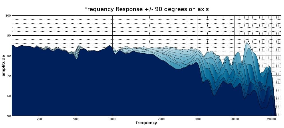

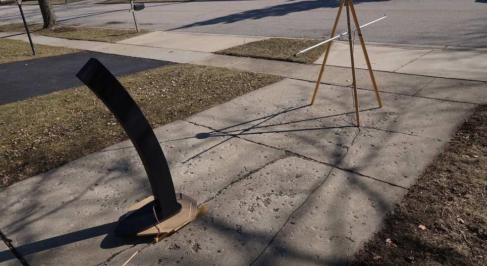

The CBT24 speakers were tested on the ground since their emulated source point of acoustic radiation lay on the floor surface of their intended use. In other words, these speakers will not measure as well were they elevated in the fashion that I normally measure speakers, so in this case, I have tested them in the manner that they were designed to be used in. For the CBT24 speakers, this will be more reflective of the response that the end user will likely have in-room. No windowing was used since ground-bounce is not an issue with these speakers and does not interfere with their low-frequency response. Testing was mostly done at a distance of two meters with a one-meter height, and this would be a very typical listening position relative to speaker placement.

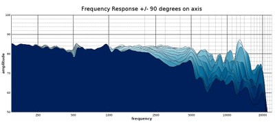

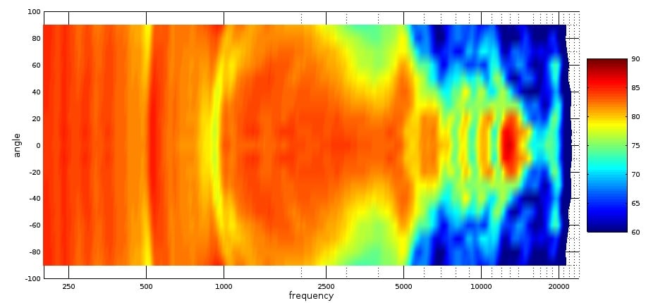

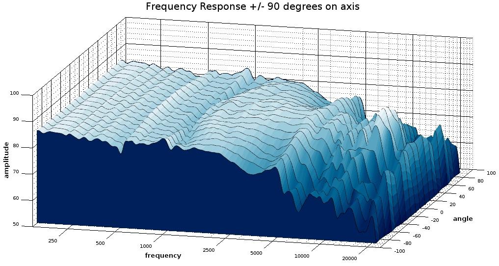

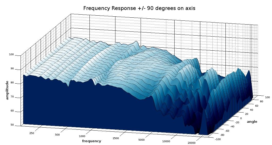

CBT24 speakers with MiniDSP equalization curve horizontal frequency response +/-90 degrees from axis: 3D view
CBT24 speakers with MiniDSP equalization curve horizontal frequency response +/-90 degrees from axis: 2D view
The above graphs show the horizontal response of the CBT24 with the equalization curve provided by Dayton Audio for the MiniDSP. A lot of interesting features show up. One remarkable aspect is that there is barely any change in the directivity of the response up to 2.5 kHz, even out to 90 degrees. The speakers begin to get somewhat directional from 2.5 kHz to 5 kHz. Above 5 kHz, the CBT24s do lose their wider dispersion ability. The response also gets a bit rocky above 5 kHz as the 2.5” drivers can’t quite match the smooth high-frequency response of a dedicated tweeter. The direct-axis response becomes somewhat uneven above 7.5 kHz, and loses quite a bit of sensitivity above 15 kHz. The depression above 15 kHz isn’t really a big deal as there is very little content in that frequency range. There is a slight peak centered at 13 kHz, but it is too narrow of a peak in too high of a frequency to be a significant audible problem. One thing we do see is a nicely flat direct axis response at 5 kHz and below. The dips in the treble that we see above 7.5 kHz are not ideal, but they aren’t that problematic either; dips are much less audible than peaks, especially when they are sharp narrow dips such as these. Cumulatively, these dips might give the CBT24s a slightly recessed sound as compared to a speaker that had a perfectly flat response in this region.

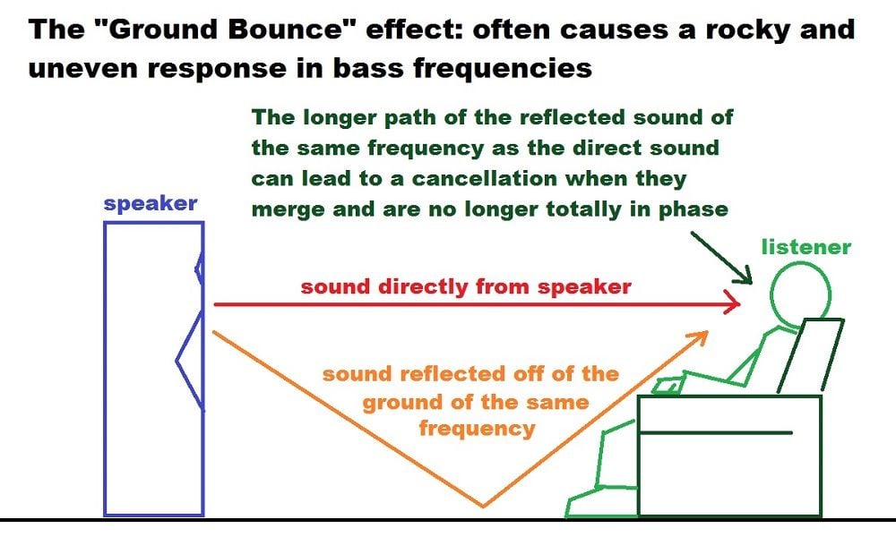

While the CBT24’s promise of extremely wide horizontal coverage looks to falter above 5 kHz, its promise of extremely smooth bass does pan out. Normally to measure a bass response that is as flat as this, I would have to place the microphone on the ground to avoid ground reflections. While that measurement technique will capture the loudspeaker’s intrinsic behavior in bass frequencies, it does not totally reflect a realistic behavior since few people listen to loudspeakers with their ears on the floor. In conventional speakers, the ground reflections that we discussed previously in the design overview section will affect measurements in the same manner that will be audible to listeners; we end up with a rocky and highly uneven bass response. This isn’t true with the CBT24 speakers. The bass response is extraordinarily flat no matter where the microphone is positioned with respect to the speakers.
It should also be noted that while the shown measurements were taken at a 2-meter distance with a 1-meter height, I measured these speakers at a variety of distances and heights, and the response remained very similar regardless of distance and height. The CBT24s maintained a very uniform response at any height and distance of a sensible listening position. In theory, there would be a sharp response roll-off not too far above the speaker’s height, but the speaker is five feet tall and it is unlikely that anyone has a listening position higher than five feet off the floor. Conventional speaker designs can have significantly differing response changes when moving from near-field to far-field, or especially when moving vertically on the speaker’s axis, but the CBT24s are essentially indifferent to these positional changes.

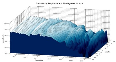

CBT24 speakers without equalization horizontal frequency response +/-90 degrees from axis: 3D view

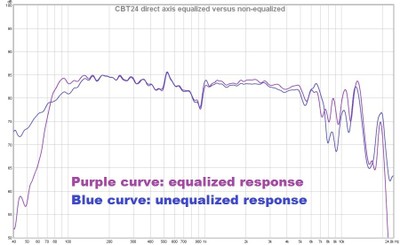

The above graph shows the horizontal response of the CBT24 without equalization. We can see that the equalization chiefly shores up the response above 7.5 kHz where the 2.5” wide-range drivers are reluctant to play at the same level as lower frequencies.

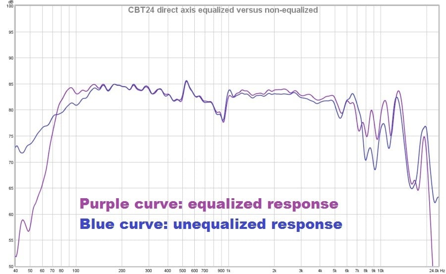

Comparison of equalization effects: direct axis of the CBT24 speakers with and without the equalization file supplied by Dayton Audio.
The above graph shows the difference on the direct axis of the MiniDSP equalization curve supplied by Dayton Audio. The equalized curve here also had a high-pass filter applied at 80 Hz. We see that the equalized curve brings up the output above 7 kHz and also applies a small amount of boost in the bass for a flatter response in low frequencies. The difference is significant, roughly a 5 to 6 dB boost in certain treble frequencies. The equalized response is an overall flatter and fuller response and helps to shore up what would otherwise be a substantial flaw. Indeed, switching back and forth between the equalized sound and unequalized sound revealed a certain lack of clarity in treble frequencies on a variety of music without the equalization. This is the reason for Dayton Audio’s statement on the CBR24 product page: “Although the system works quite well on its own without EQ from below 100 Hz to 8Khz, the system works best with an active DSP...The DSP processor also provides touchup EQ to flatten the system’s overall response and to extend the system’s response out to the limits of hearing.”

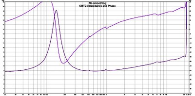

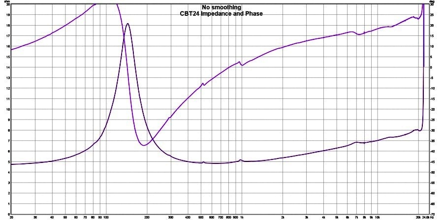

CBT24 Electrical Impedance and Phase
The above graph shows the CBT24’s electrical load. It is specified by Dayton Audio to be a 4-ohm speaker, and that is true in a sense, but it is also a rather conservative rating. At no point in the CBT24’s response does it actually dip down to 4 ohms. Its minima occurs at 5 ohms, but it stays around 5 ohms for large swaths of frequency bands, and so it might be a bit taxing for low-budget amplification such as on entry-level receivers. Steep phase changes occur at high-impedance points, so it isn’t all that tough of a load. Heavy-duty amplifiers are not required to safely use these speakers, but users will want something more robust than a $300 AVR. More power capability is welcome, however, as the CBT24s can handle a lot of wattage (250 watts RMS according to the specs, but that is very much a conservative rating).
