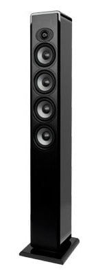

- Very sleek design, slim profile
 - Impressive bass response
 - Fairly accurate overall sound
- Finish dust magnet
 - No carpet spikes (new orders now shipping with spikes according to Boston)
 - A bit thin through the midrange with an accentuated high end

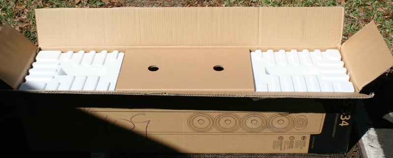

The Boston RS 334 speakers came individually boxed and well protected. Each box clearly outlined what was in it so if you are having these speakers shipped, you might want to make sure you are home to sign for them. Inside, the speakers are well protected around the top and bottom by foam with a middle section of cardboard for added benefit. The speaker is wrapped in a cotton sock and Boston even included a pair of Boston-branded cotton gloves to handle them with. I can remember the first time I received a pair of speakers wrapped in a cotton sock with the gloves. I was so impressed. But after years of doing this, let me say that the cotton sock is probably the number one over-hyped indicator of quality in all of electronics. I've had everything from DVD players to HDMI switches arrive in the dreaded sock. Yes, I said dreaded. While smaller devices just look ridiculous, large, heavy speakers, I'm semi-convinced, are wrapped just to cut down on minor blemish returns because you are certain to drop them.

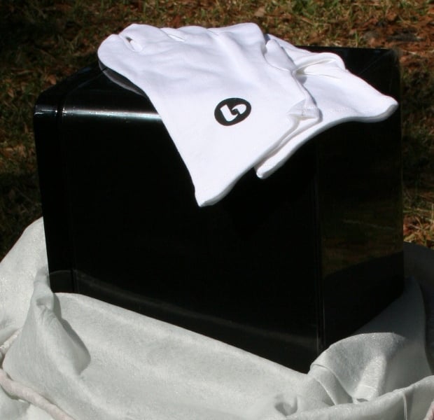

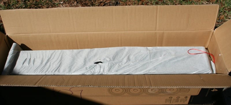

The
thing is the sock is useless. It's actually less than useless. If it
was useless, it would do nothing but the sock does have an affect -
actually a few. First, it virtually guarantees that your speaker will
arrive with a dusting of fuzz all over it (especially on the grill).
The point (I think) of the sock is that it supposedly protects the
finish. Well, maybe at the contact points with the packing material
but it certainly isn't doing much more. Foam paper (for lack of a
better term) is just as effective and can be removed much more
easily. Lastly, if your speaker is at all unwieldy (and believe me,
they just about all are) the sock is akin to lathering it up with
baby lotion. Sure, you might not drop it but in my experience you, at
the very least, almost will. With every cotton-wrapped speaker I've
ever received I've either almost or actually did drop it while
unpacking or repacking.

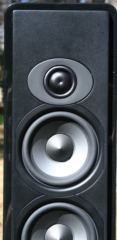

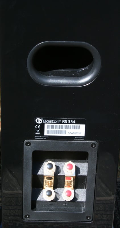

The back of the RS 334 has a slot style port near the bottom but above the dual binding posts. If you stick your fingers inside the port, you'll quickly realize that it has a 90 degree turn upward. This increases the length of the port on a speaker that clearly is looking to minimize its footprint. The port is flared at both sides and has about 6-7" additional length after the bend. The plinth at the bottom is removable (which is nice if you want to change it out for an aftermarket outrigger setup) but has no identifiable provision for carpet spikes. In fact, there are installed rubber feet. This is fine if you are setting the speakers on hardwood or tile but for those of us with carpet, it is not optimal. At only 32lbs a piece, the speakers aren't the heaviest and the wide plinth helps a bit with tipablility but we still would have preferred carpet spikes. At $1400 a pair, this is a curious omission. (Note - Boston now says they are shipping carpet spikes but they were not available on the review units.)

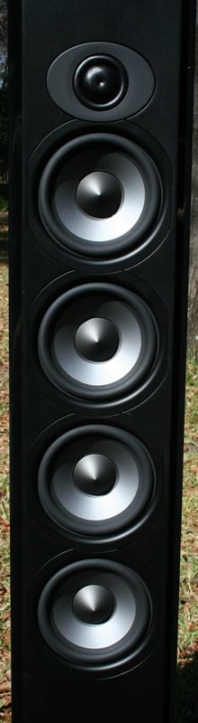

The driver compliment is fairly
generous in such a small cabinet. Boston has provided the RS 334 with
a 1" EWB tweeter (Extended Wide Bandwidth) and four, 4"
FCCM woofers (Fiber Ceramic Copolymer Material). One thing I got to

Reflection Series. The tweeter has a dimple in the center - something
that people familiar with soft dome tweeters will initially be
concerned by. Rest assured, that is part of the design. The woofers
all have a pointed dustcap that looks, at first glance, to be a phase
plug. It isn't and often we discourage the use of such drivers as the

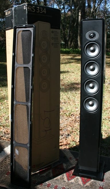

The size of the RS 334s has been mentioned a few times but really needs to be stressed. It is fairly easy for Internet direct companies to through a bunch of drivers into a big box because their customers won't really be able to see them until they arrive at the house. With a company like Boston that often sells in retail settings, that's not really feasible. Instead, they have to make sure not only that the sound is there, but that the form factor will at the very least not turn consumers off. The RS 334s are anything but a turn off. The speaker itself is only ~43" tall, 8.5" wide and 10" deep. Compared to many speakers I've reviewed in this price category, this is positively diminutive. The knock test revealed a very inert box - something you'd expect when Boston is shoving as much technology as they must be into such a small cabinet.

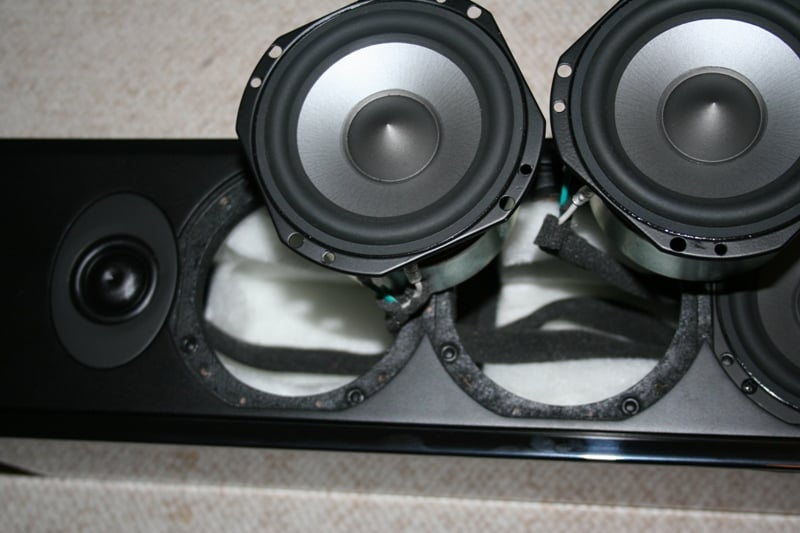

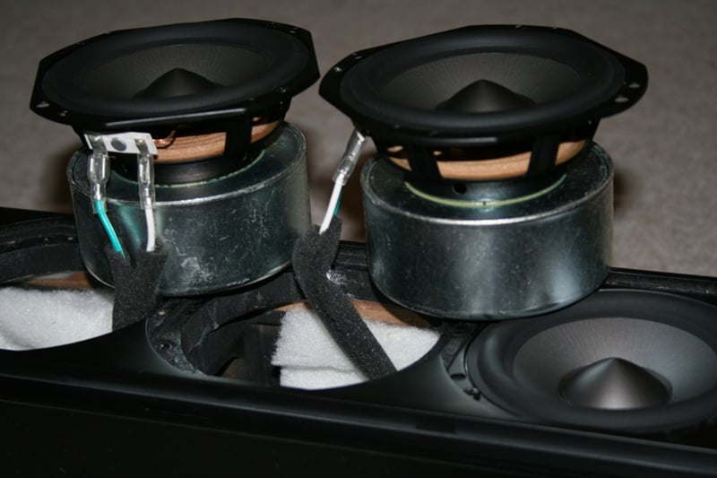

Opening
up the speakers, I was surprised at how tight everything was in
there. The woofers were all shielded which creates a very large
magnet structure in the back. I was only able to remove three of the
four woofers because the openings were so tight and I couldn't get
the vanity cover off the tweeter to get at the screws. The tweeter
did not have a backbox. All the wires were covered in velvet tape to
eliminate any possible noise from the wires vibrating against the
cabinet, the drivers, or each other. The enclosure was constructed
out of 3/4" MDF - about what we'd expect at this price point -
with 1/2" MDF braces. I could identify four braces in the
cabinet but there may have been a fifth one lower down. The top brace
was parallel to the front baffle and seemed to be connected to the
top and the sides. This came down to just behind the tweeter. The
rest of the braces were parallel to the top and were connected to the
sides, front and back of the cabinet with openings in the center.
These were situated between the top and second woofer, between the
3rd and 4th woofer, and just below the port (before the binding post
insert). There was a ton of dampening material in the enclosure with
thick polyfill glued to each of the walls and back of the cabinet in

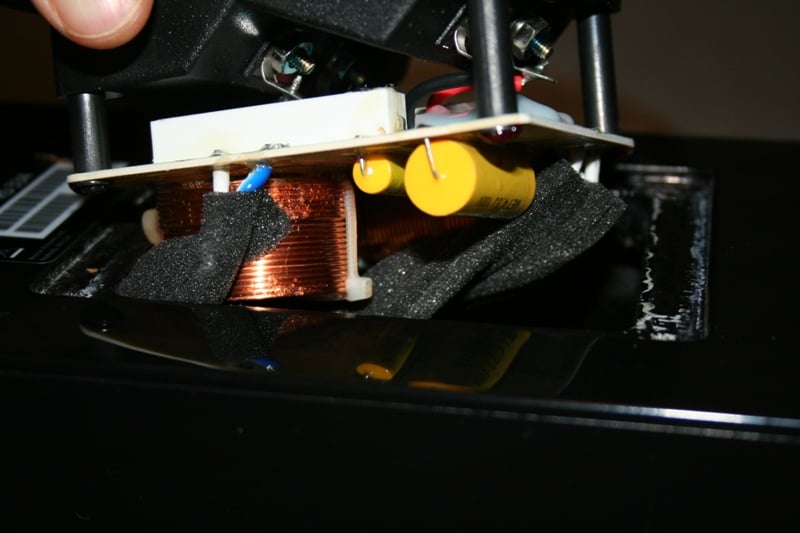

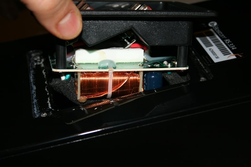

every place I could see or reach. The crossover was attached to the
back of the binding post insert. The wire runs were so tight that I
couldn't remove the crossover enough to get a good picture. From what
we can tell the crossover it was assembled on printed circuit board
(PCB) and utilized a combination of air and iron core chokes and
polypropylene capacitors and ceramic resistors. I'm guessing the
larger iron core choke is part of the woofer crossover which is a
good thing since most of the power is in bass and you don't want an
underrated iron core going into saturation causing distortion and
compression when playing at high listening levels.

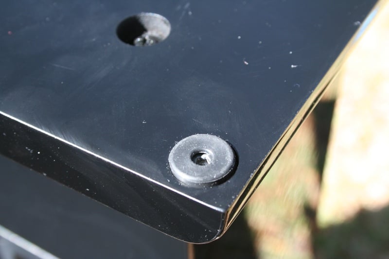

first thing I want to talk about with setup is the lack of carpet
spikes. While the RS 334s never went over, they definitely would have
been more stable with carpet spikes. On my medium-pile carpet the
speakers were easy to sway back and forth but not so easy to send
completely over (not for lack of my 6 month old trying). Also, there
is no way to adjust the feet. Unless your flooring was installed by
Mike Holmes, I'm guessing you'll have a less than perfectly level
floor. Without a way of adjusting the feet, you'll be left to use
folded paper or something. I did love the angled port for transport.

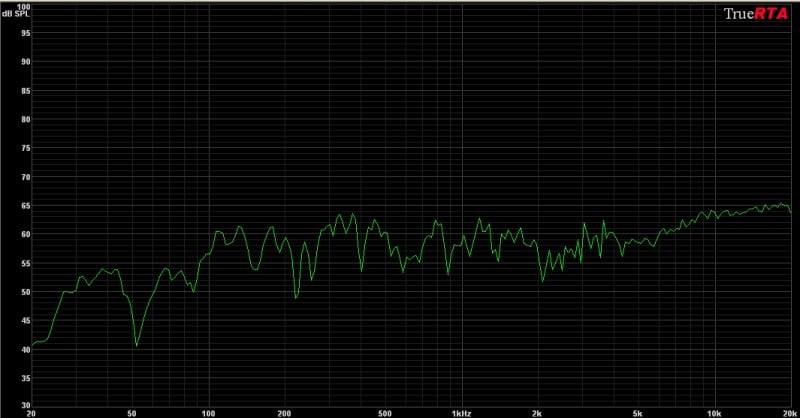

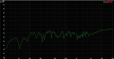

Measurements & Testing

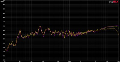

For measurements, I used TrueRTA with a Behringer ECM8000 mic and an M-Audio Fast Track Pro external soundcard. For amplification I used a Sherbourn 2/75B amp. This setup gives me a lot of flexibility as to where and when I can do measurement. To start with I placed the speakers in my Ready Acoustics treated AV Rant podcast room. This room is small but extremely dead with 19, four inch thick panels lining the walls and ceiling and straddling all the corners. While the room isn't exactly an anechoic chamber, it is a heck of a lot deader than most people would ever experience and almost every wife on the planet allow in their home. To start with I measured the speakers 1 meter on axis.
Boston
Acoustics RS 334 One Meter On Axis 1/24th Octave
(note - not a 1
watt measurement)
I measured the Boston Acoutics RS 334s at one meter between the tweeter and the top woofer. As you can clearly see the RS 334s are generally pretty linear from 100Hz up to 6kHz where there is a general trend up. This is pretty common in speakers there the high end is a bit accentuated. Consumers, especially those in retail settings, are listening to numerous speakers and will tend to prefer those with a hotter high end. This is not an extreme change though at only about 5dB over the average of the rest of the response.

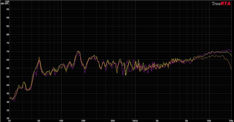

Boston
Acoustics RS 334 1/2 Meter, 1/24th Octave
Purple
- On Axis, Yellow - 15 Degrees off, Orange - 30 Degrees Off
This graph gives us a little more information. As is often the case, off axis response takes a toll most on the high end response. This allows the end user to "tune" the speaker by adjusting the toe in. With the RS 334, the on axis response has the most high end energy with a light reduction at 15 degrees off and a more dramatic one at 30 degrees. For those looking for the flattest possible response, you're going to want to sit off axis from the speaker. There also seems to be a bit of a dip in the response in the midrange/upper bass. This was not as visible in the one meter measurement so will not be an issue.
