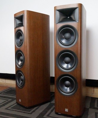

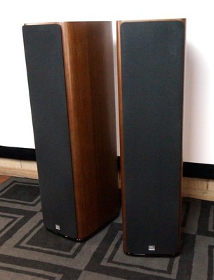

Appearance

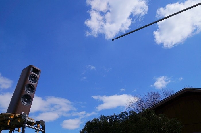

The JBL HDI-3800 are not small loudspeakers. They will have a visual presence in-room, and so the question becomes, how well do they fit in? One aspect that weighs heavily in their favor is the furniture-grade finish. The review sample sent to us came in satin-walnut that has been stained for a more reddish color. This is a real wood veneer so, in my opinion, it would fit in with other furniture, even if the furniture is higher-end. All of the vertical edges of the cabinet have been rounded to soften its shape and make it seem a bit more ‘furniture-esque.’ The three large black woofers and the horn are very prominent, so as loudspeakers go, it isn’t going to be mistaken for anything else, although the drivers can be hidden behind a magnetically-attached grille. The grilles do a good job of hiding the drivers and are a great solution for those who don’t like the utilitarian appearance of naked drivers. The grilles do make the speaker look a bit monolithic, but that may be particular to the 3800s given how large they are. The base has a gloss black trim that adds a slightly regal touch.
As drivers go, the ones used in the HDI series are pretty nice
looking. They all have the same black color and soft reflectivity from trim
ring to dustcap, so the appearance is simple and uniform, tweeter horn
included. The relatively organic shape of the inner horn helps to keep things
aesthetically gentler than if there were any sharp angles. The only hard edge
that occurs in the HDI-3800 is the flat top. The speaker is so solid that if
one wanted, they could use the top as a surface to place something like a figurine.
(But please—no drink glasses! We don’t want any of those circular watermarks!)
The simple shape of the HDI-3800s means that a lot of the weight of their aesthetics rests on the finish. The good news is that they can be had in three different finishes that can accommodate different interior decors. The satin walnut is a good fit for traditional decors, but there is a high-gloss black that would make a better fit for modern interior design. There is also a grey oak wood veneer that would mate well with a room of a different color scheme than the reddish walnut could clash with. The overall design is rather conservative and not aesthetically loud, so the HDI-3800s shouldn’t be that attention-grabbing in a larger room. They aren’t really meant for small rooms anyway. I think the 3800s look nice and shouldn’t present a problem for anyone except those who just don’t like the visual presence of any speakers (such people deserve pity, not scorn).

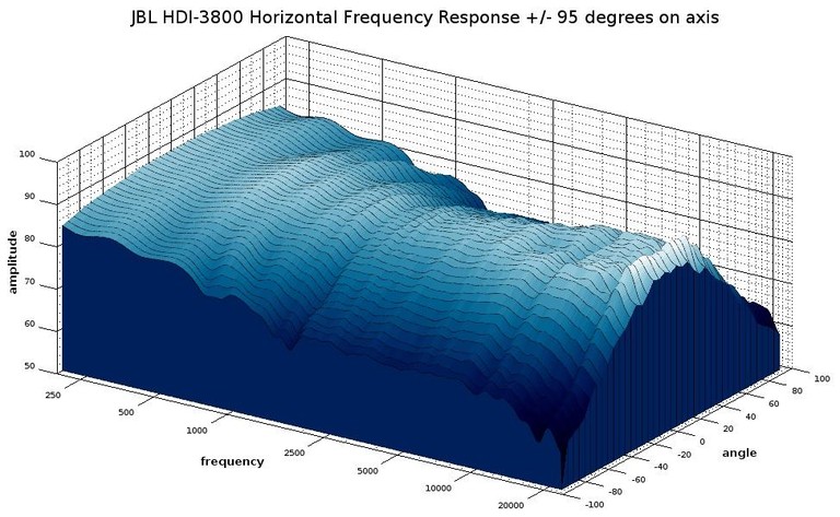

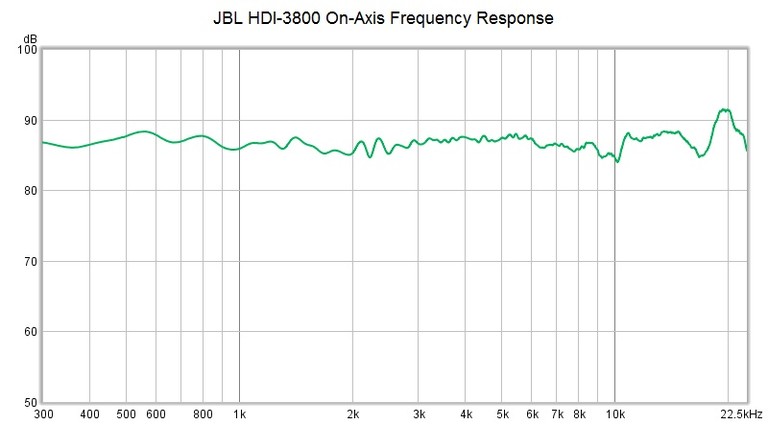

The JBL HDI-3800s speakers were measured in free-air at a height of 4 feet at a 2-meter distance from the microphone, with the microphone raised to a 7.5’ elevation that was level with and aimed at the tweeter center. The measurements were gated at 9-milliseconds. In this time window, some resolution is lost below 400 Hz and accuracy is completely lost below 200 Hz. Measurements have been smoothed at a 1/12 octave resolution.

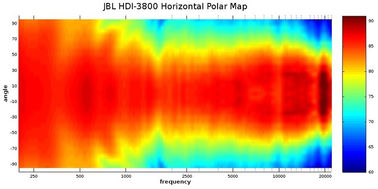

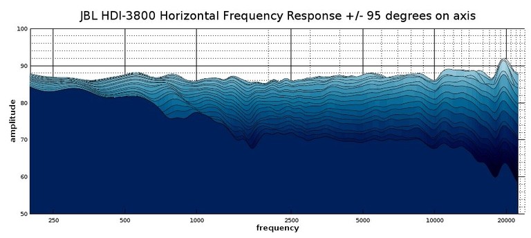

The above graphs depict the JBL HDI-3800’s on-axis and horizontal dispersion out to a 95-degree angle in five-degree increments. Information on how to interpret these graphs can be read in our article Understanding Loudspeaker Review Measurements Part II. There is a whole lot to like about the measurements seen in the above graphs, and pretty much nothing to complain about. This is a beautifully neutral showing both on and off-axis. You could listen to these speakers over a broad angle in front of them and get the same tonality, and it would be an accurate sound. The good news about that is not just that you could listen at an off-axis angle for the same experience, but that all the acoustic reflections in-room will have the same tonality as whatever the direct sound is hitting the listener. You really don’t need acoustic treatments with that kind of performance. This is terrific performance, and it is befitting the kind of expectations that one would have for a modern high-end speaker from JBL.
The above polar map shows the same information in the preceding graphs but depicts it in a way that can offer new insight regarding these speakers’ behavior. Instead of using individual raised lines to illustrate amplitude, polar maps use color to portray amplitude, and this allows the use of a purely angle/frequency axis perspective. The advantage of these graphs is they can let us see broader trends of the speaker’s dispersion behavior more easily. More information about interpreting this graph can be read in our article- Understanding Loudspeaker Review Measurements Part II.
What we see here from the HDI-3800s is beautifully controlled directivity. JBL’s waveguide technology is no joke and is really paying off here. The beamwidth, which is defined as the off-axis angle at which the amplitude is down by 6 dB, is impressively flat at around the 50-degree angle. There is no doubt that this is one of the best waveguides out there. This is not exactly a wide dispersion pattern nor is it a very narrow dispersion. As the graphs above it demonstrate, we see it offers uniform coverage over a wide area, and so long as the listener isn’t seated way off-axis, there isn’t a bad seat in the house.

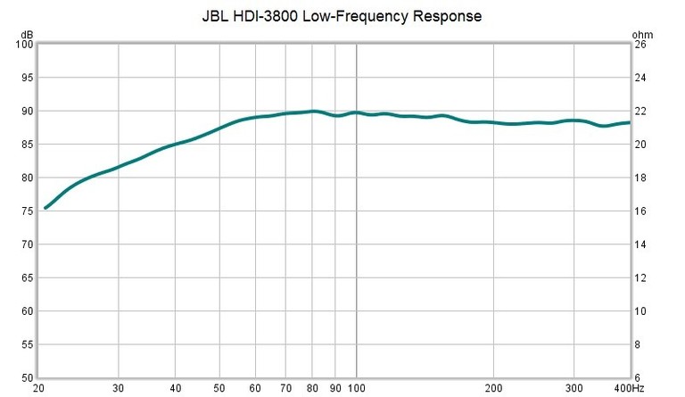

The above graph shows the HDI-3800’s low-frequency response captured using groundplane measurements (where the speaker and microphone are on the ground at a 2-meter distance in a wide-open area). Here we again see a nicely linear response that accounts for how sharp the HDI-3800’s bass sound is. There is a gradual roll-off in deep bass below 50 Hz, and the port tuning looks to be quite deep, perhaps below 30 Hz if I had to guess from this measurement. That explains how this tower speaker was able to handle deep bass so well. That being said, I wouldn’t want to throw high levels of infrasonic bass at this speaker, meaning stuff at or below 20 Hz. Below port tuning frequencies, the drivers are not protected by compressed air within the cabinet and can be more easily over-driven. If your listening tastes are geared for movies with deep bass, the addition of subs may still be worthwhile.

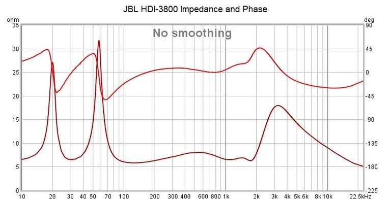

The above graph shows the electrical behavior of the HDI-3800. JBL specifies these as a 4-ohm speaker, and that is a conservative rating according to our measurement. If they called it a 6-ohm nominal speaker, I wouldn’t argue. The minima is 5.8 ohms at 127 Hz, but that happens with an agreeable phase angle of 11 degrees. Overall, this is not a difficult electrical load for any competently-engineered amplifier. I think even budget AVRs could cope with this, although I doubt anyone who buys these speakers will pair them up with a budget AVR. I measured the sensitivity at 90.4 dB at 1 meter for 2.83v. JBL specs them at 92 dB for 1 meter at 2.83v, and that isn’t a big difference when variability in the way sensitivity measurements are done is considered. That is above-average sensitivity for a floor-standing speaker, but perhaps not one as large as the HDI-3800. Given the low-frequency extension of the HDI-3800, it is expected that the sensitivity wouldn’t be huge, but they can still go a long way with just a few watts.
