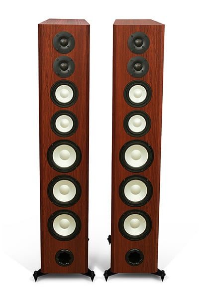

M100 v4 Tower:
- Enclosure: Triple Vortex / Reflex
- Max Amp Power: 400 Watts
- Min Amp Power: 10 Watts
- Freq Resp +/-3dB (Hz): 31 Hz – 20 kHz
- Impedance (Ohms): 4 Ohms
- SPL Anechoic 1w/1m(db): 88 dB
- X-Over 160 Hz & 2.3 kHz
- Tweeter: Dual 1"
- Midrange: Dual 5.25"
- Woofer: Triple 6.5" High Power
- Dimens. H W D (inches): 47.5" x 9.25" x 17"
- Weight (lbs) 70 lbs each

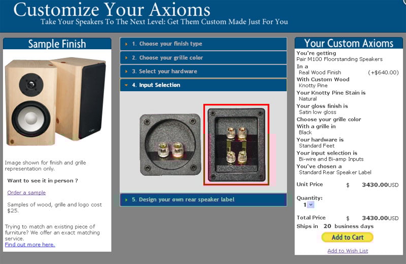

The M80v4 speakers require robust amplification to work their best and they do have the capability to play substantially louder than their bookshelf speakers. However, the M80v4's cost almost double of the original M80s despite the cabinet is still vinyl wrapped and no longer comes standard with dual binding posts for biamp/biwiring. To upgrade the dual 6.5" bass drivers to their HP versions will cost you a staggering $490/pair! If you want a wood veneer, bi-amp capability and the high performance woofers, prepare to spend almost $3k/pair.

Axiom Customize Yours M100V4's
The M100V4's build upon the M80v4's but add an additional 6.5" bass driver. They come standard with HP woofers but their starting price is $2,790/pair. That's $410/pr more than a pair of M80v4's with HP woofers. So, you're paying a whopping $210 per 6.5" woofer for this upgrade! To get a custom veneer finish and bi-amp capability will set you back almost $3500/pair. Again, stiff competition resides at this price point. There are many competitor ID speakers out there that offer standard veneer finishes, HP woofers and premium components for significantly less. Many of Axiom's competitors offer 45 day RISK FREE trial with paid shipping both ways. Axiom requires you to pay return shipping and only gives you a 30 day trial period on their products. However, they do offer upgrade capability but will prorate the value of your Axiom products based on their age.
